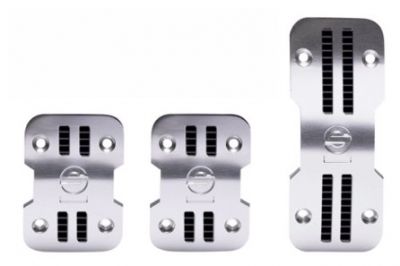

i've put these on order
Along with a pipercross viper intake system.
The intake system has a carbon fiber heat shield in the pipe work to keep the air cool. will see how it does when it gets installed really.

Are the pedals going to fit? The accelerator pedal comes from the floor doesnt it?
Offline ryder2012
  • Posts: 58
Re: 2l tdi mk5 project.
« Reply #5 on: December 30, 2014, 09:38:35 pm »
not entirely sure, if not i can always modify the stock accelerator pedal to accept this one.
if it needs modding then it'll be pretty simple to get it to fit with the right angle. they are out of stock form where they was ordered at the moment so will take a while before they arrive annoyingly. only informed it was out of stock AFTER the purchase was made.

GTI pedals would be the better option.

I would go for GTI pedals as well IMO. GTI pedals are what are used in the VW Cup cars.. Jetta/Scirocco/Golf etc.
Won't work anyway because floor mounted.

the seats...they was chosen for cost and weight until i can order the actual seats i want for the car. want to install momo daytona evo's in the front. 9.5kg without the subframes. these seats i currently have are about 11/12kg. either way FAR lighter together than a single stock seat lol.
the ordered pedals will work just fine with a little modification to the stock accelerator pedal
