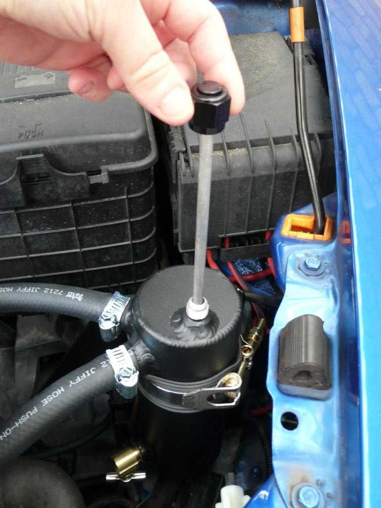

If you get the high capacity catch can then it has a dipstick so you can check the level.
For some reason I read your message as is read..."If you get the high capacity catch can then you dipstick"  :signLOL:
Yeah I guess so...

Re: BSH PCV Stage 1 vs Stage 2...
« Reply #13 on: November 20, 2009, 05:33:58 pm »
@ Bogwoppit:
In your Reply #7 you've posted a pic which very clearly shows a nice adjustable fixing ring. Did it come from BSH or elsewhere?
Thanks  :happy2:
« Reply #14 on: November 20, 2009, 05:45:20 pm »
@ Bogwoppit:
Thanks  :happy2:
Mr Red,
I have that can, and the retaining ring in the pic, is supplied by BSH.
