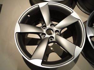

Hi, I am looking to fit TT RS Rotors on my gti fitment 5x112 and offset of 45. Will these wheels fit straight on without having to roll arches etc as I have normal ride height.

Re: Wheel fitment audi ttrs rotors
« Reply #4 on: January 06, 2015, 11:28:53 pm »
I think these are the wheels  :innocent:

Hes not specifically asking about clearing brakes i dont think....
I had 18x8 ET45 CHs are they were fine
Hahaha I've just realised what happened there, the wheels are called rotors and i thought he meant brake discs  :rolleye:
Assuming they're either 8.5j or less then they'll fit fine  :happy2:

« Reply #9 on: January 07, 2015, 11:01:59 am »
Haha sorry lads! Sticking to stock brakes need me a set of fat ladies to go on the shoes! 19s should do nicely!
