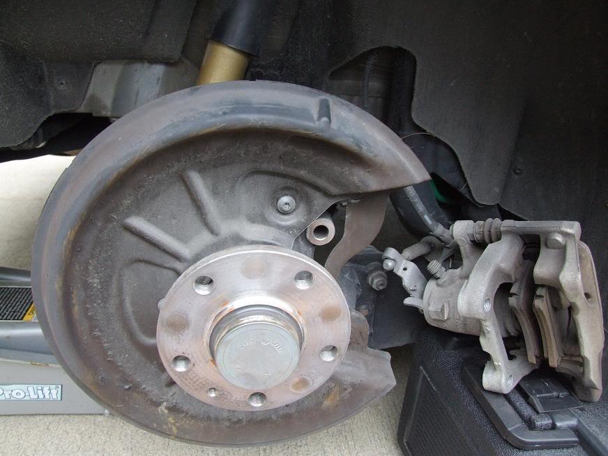

You need to remove Caliper and disc. This will expose the brake shield. Its held on by 3 torx screws.
Once they're removed you will need to cut part of the shield to get it off the hub.
If you do it right, you can refit it as well. Depends what has made it come loose. Maybe the torx bits have rusted away or come out?

Here's a pic of it with Caliper removed:
Yours may be rotten.

Chances are it's rusted around the bolts
Mine rusted away completely and started rubbing on the disk so I just took both the rear ones off but I didn't have to do any cutting
All I did was remove the caliper and the disk
It's quite common for them to rust
You can do a temporary fix by sandwiching the bolts with washers but it will need to be replaced or removed at some point

To remove it properly I think the hub has to come off. The work around is to cut it to allow it to be manipulated around the hub, after removing the torx screws.
Jas

Mine went last week, mate cut the back plate off with tin snips.
Easier than taking caliper off. :smiley:

Ended up doing that after I removed the caliper. The disc wouldn't come off past the carrier, so I just abandoned it and got the hack saw out!
I had a look online there and replacements are about £25!!

Resurrecting this thread to say that I got my rear guard off by cutting it in half using a hack saw and a bare hacksaw blade (to get greater depth).
Mine was broken at all three fixings so I made a cut towards one of the fixing holes and at the 11 O'clock position when facing the hub.
Hopefully this will be of use - they sure do make a racket!
