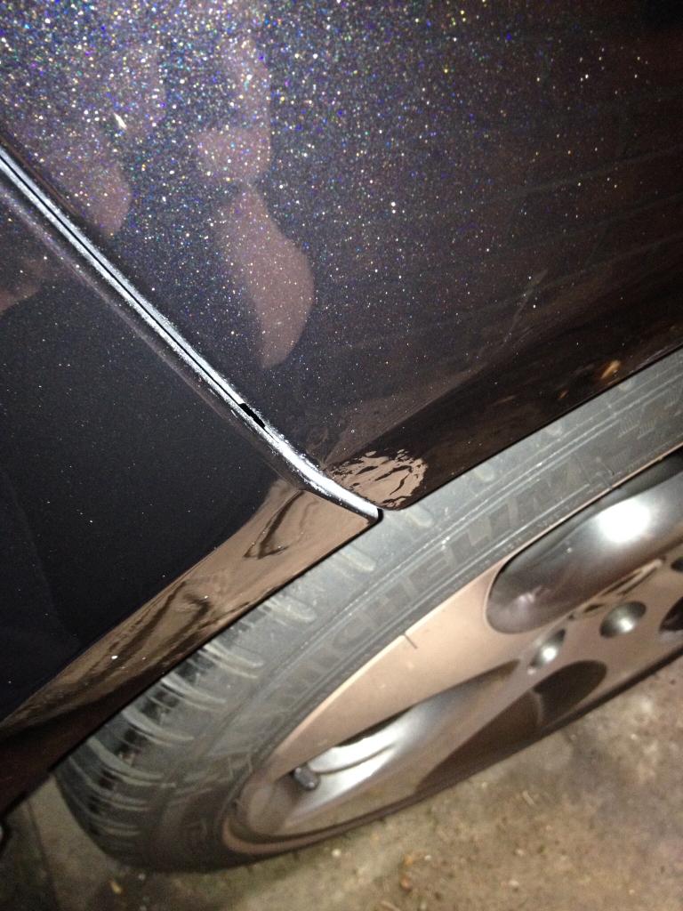

I recently noticed a small amount of bubbled paintwork to the rear of my off side rear wheel arch. As the car was due a service, I brought it to the notice of my (extremely competent) long term dealer.Their warranty manager agreed that this was within the remit of the anti corrosion warranty, so we arranged to have it repaired a couple of weeks later when I returned for my cam belt/water pump change.
In the meantime, I visited my local reputable body shop (whom I have patronised for years), who said that the damage could be flattened out & filled but would result in rust recurring, or cut out & metal welded in which would be the better option. For the latter they quoted £285. I was sorely tempted to give them the go ahead, but didn't.
On 16th December 2014, I dropped my car off at the dealer, and discussed my concerns about the 2 methods of repair with the dealer's service representative. She called the body shop to ask them, and was told that it would likely be flatted & filled. I told her not to continue, and simply deal with the cam belt change. She was at pains to point out that the work would be guaranteed & rectified if it returned, but I stood my ground.
At the last minute (in the courtesy car, with the engine running) I had a change of heart & decided to trust the dealer and body shop. Fatal mistake.
I was called late on 19 Dec to say my car would be ready in the morning. I attended to collect it at 1030 on 20th. The dealer told me that the metal repair had been a weld-in patch as I had wanted, but, contrary to my instructions and to an A5 card placed inside the windscreen, the body shop had washed my car. The dealer has long known not to do this. Sadly no one at the body shop thought to pay attention to the card. My car was squeezed in next to a large van, so I didn't pause long, but returned home to give it a good wash & walk round.
Oh boy.

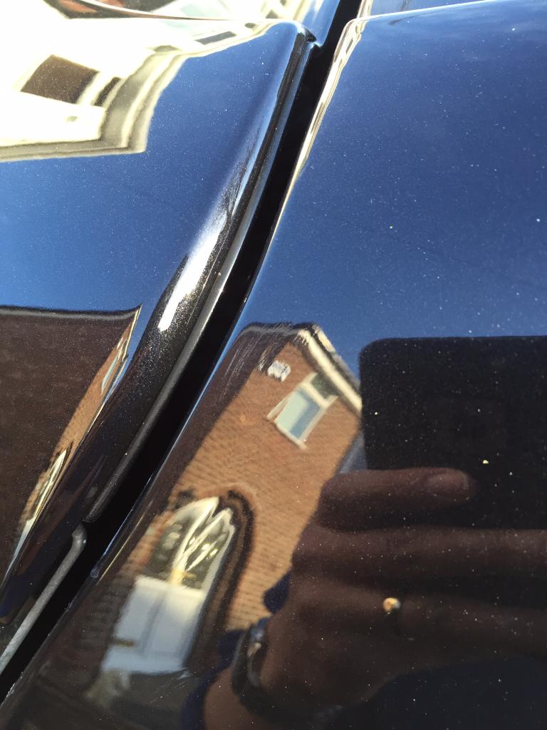

The good bit was, the metal repair was well done. The paint & finish was of a shockingly poor standard. Breathtakingly poor.

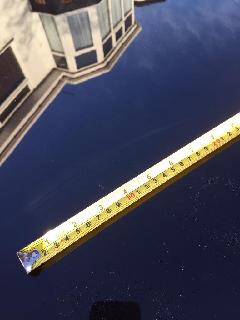

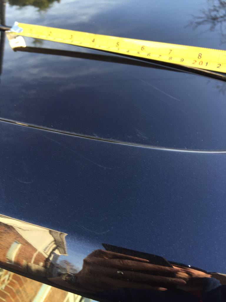

1. Scratches all over the body, needing polishing out, up to 8" in length, thanks to the moron who washed it.

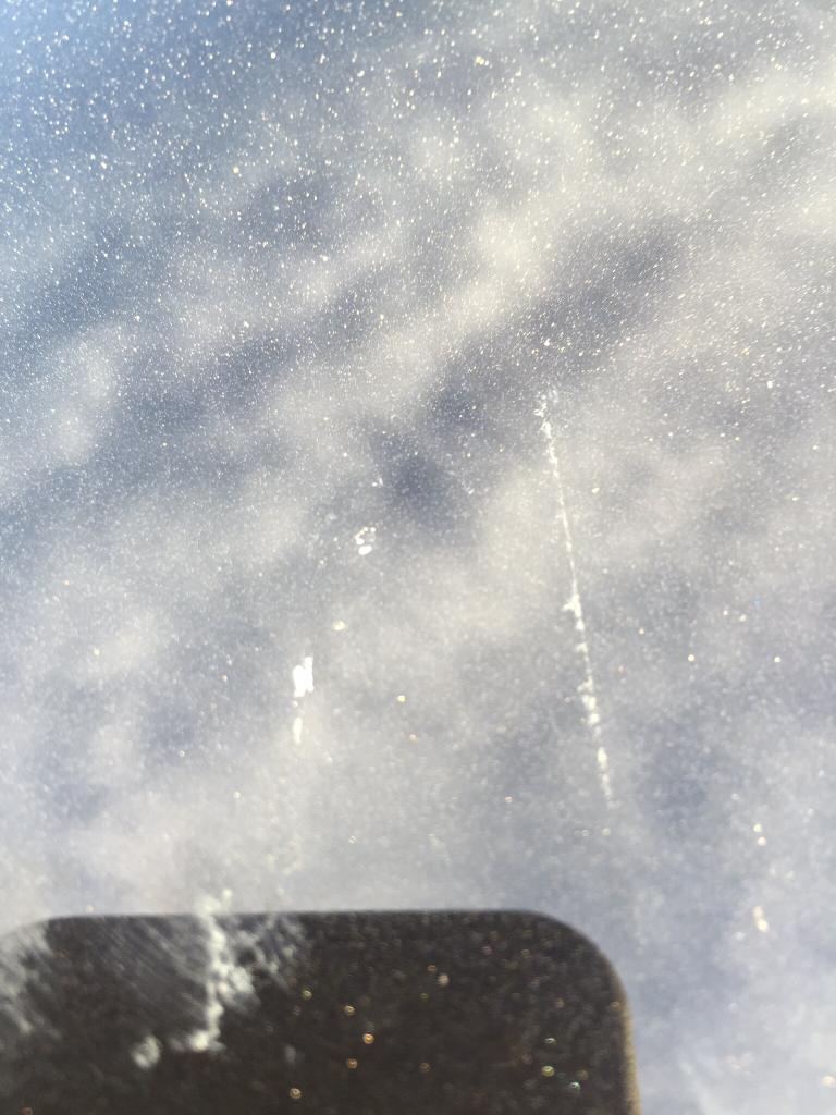

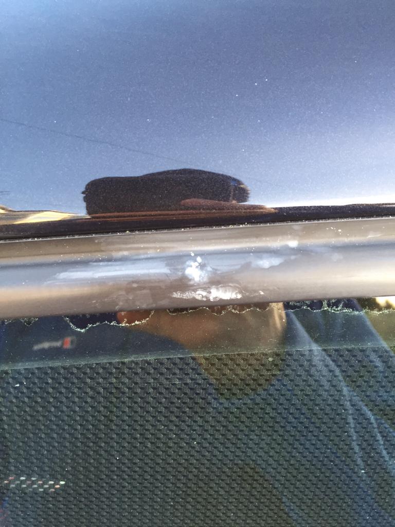

2. Half dozen chips in the roof near the B pillar. Down into primer. Which my local place says requires a full roof respray.

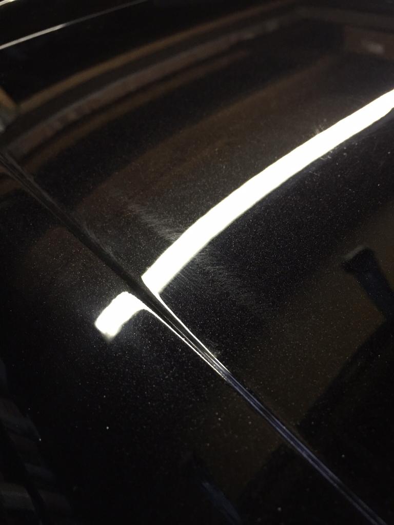

3. Ridges in the lacquer in the top of the rear quarter.

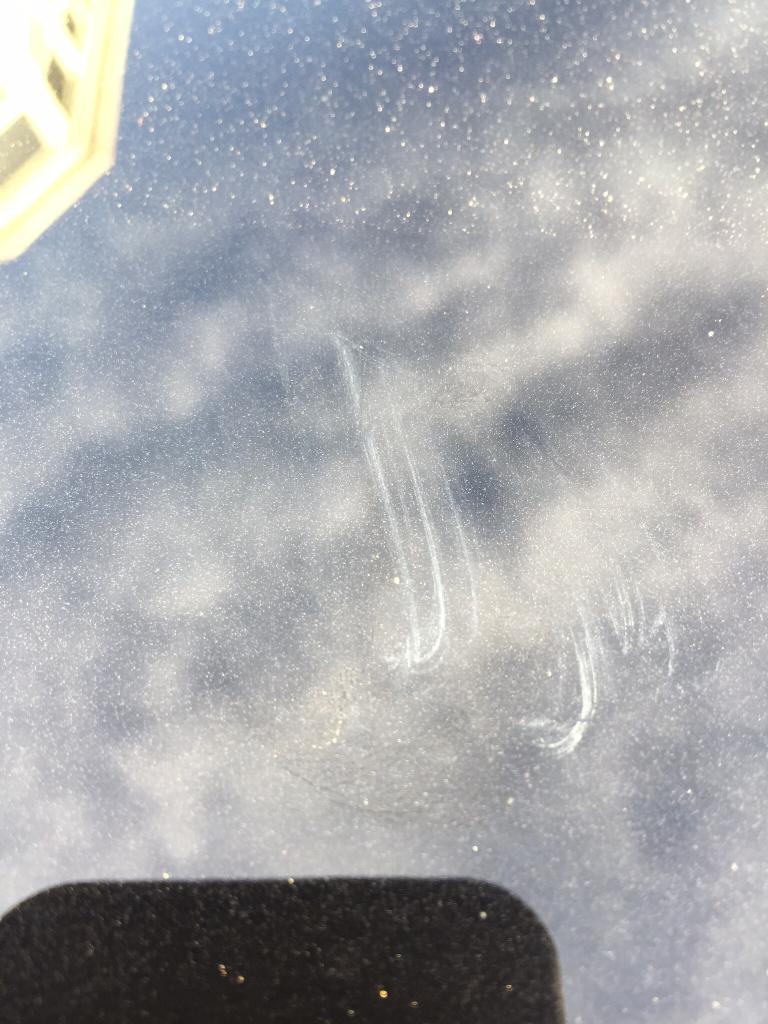

4. Scratches in the roof from buffing, 8" plus in length
5. Paint colour too light, and not blended into bumper or OSR door.

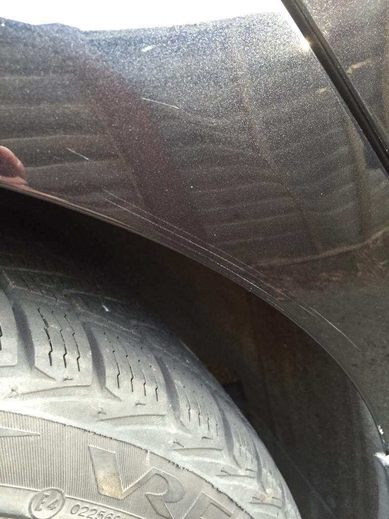

6. Several scratches of 5" to 8" in the newly painted panel

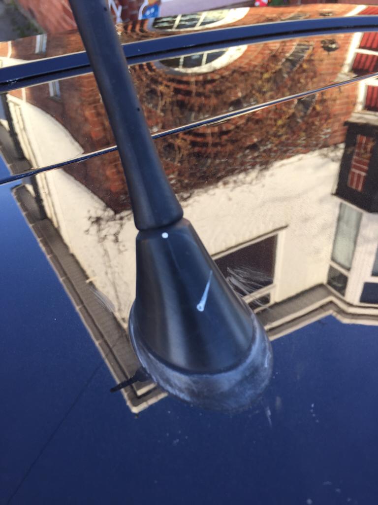

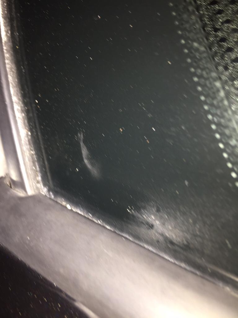

7. Polishing compound embedded in the rubber window surround, roof sill and aerial
8. No attempt to polish inside the boot lid or OSR door shut.
I returned to my local body shop, who agreed with me. Their estimate to put this lot right is £945
I've raised my concerns with the dealer & VW, and had the service manager take it up with the VW Approved Body shop. they naturally want me to leave my car in their hands to put this right. I am adamant that after a lack of quality control of such magnitude, they aren't touching my car again. My intention is to get my local trusty body shop to rectify this (at £945) and send the bill to the approved body shop. If they don't cough up, I'm likely to go County Court small claims track. I've told VW this, and they are calling me on 15 Jan 2015 to update me.

from looking at the pics, the majority looks like product left on the paint work, id hazard a guess that polishing may remove most of it,
the marks on the roof look like contact marks from a flatting disc, the quarter that's like a side ways run, so perhaps it silicone on them,
from the original pics, you could of got away with just blending the bumper, but it depends how big the repair got once filled
jake

as jake says most of those will come out with polishing
we have corrected far worse in the past, no guarantees that it would, but typically those are the kind of marks "most" average bodyshops leave on cars as well as dust etc everywhere.
scratches aren't good but then neither is putting metal tape measures in the paint which won't help.  :evilgrin:
Bodyshops will not deliver a car back to you as a detailer would.
tbh when my car went into ridgeway bodyshop i asked them not to wash it and true to their word it was not washed at least.
most of the paintwork would be resolved with a polish
i am not sure if you are into detailing or whatever yourself but a high likelyhood many scratches were there before hand just shown or brought to your attention with your now keener eye and a strong wash. of course they will swirl it and put a few scratches in it, no defenses from then there.
sorry you are having a bad time. sometimes best to stick to your gut feeling  :sad1:
Sadly, that's not the case. 3 weeks prior to this, the car was polished, two coats of jetseal & waxed. I can guarantee that these marks weren't present when I left the car at the dealer. I like to keep my car free from swirls and marring. I detail it regularly.
The chips on the roof are deep enough to require a full roof respray. And given the evidence of their poor masking, I'd not trust them around the windscreen with a roof respray.
