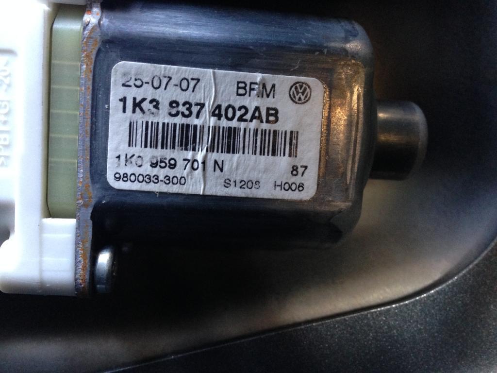

I have done loads and loads of reading and I am struggling to work out if my controllers are going to work so far I have fitted the drivers side mirror and coded the puddle light
I am waiting on the passenger mirror to be delivered and the new switch
Address 42: Door Elect, Driver        Labels: 1K0-959-701-MAX3.lbl
   Part No SW: 1K0 959 701 N    HW: 1K0 959 701 N
   Component: Tuer-SG         006 120B
   Coding: 0000564
   Shop #: WSC 01279 785 00200
   VCID: 3957C83A700F6AD693D-806C
Address 52: Door Elect, Pass.        Labels: 1K0-959-702-MAX3.lbl
   Part No SW: 1K0 959 702 N    HW: 1K0 959 702 N
   Coding: 0000820
   VCID: 3A55D736750961CE9A7-806F
stickers on the drivers door motor/controller
Dan..

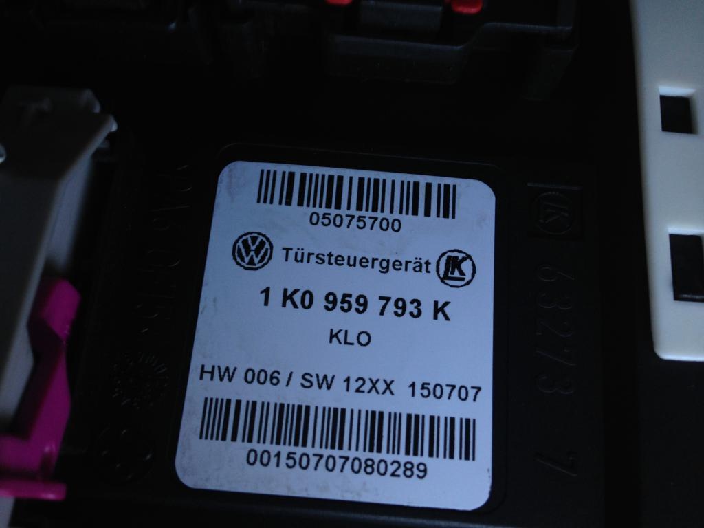

I have 793K on the drivers side with these functions

I've seen a couple of cars with controllers ending with N showing up as a MAX controller with vcds
supports everything but not folding.
Try an ouput test on the side where you have fitted folding mirror, see if it folds

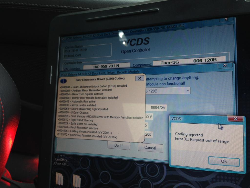

« Reply #4 on: January 25, 2015, 11:39:19 am »
cheers Eddie
so no movement in the output test and then i thought it might not work as i have not codded it yet
so tried to code and it will not except the coding
Dan..

Mine shows as an N though it is stamped as that.
Try 0000566 as coding temporarily, I have a 3dr with door warning lights, puddle lights etc
