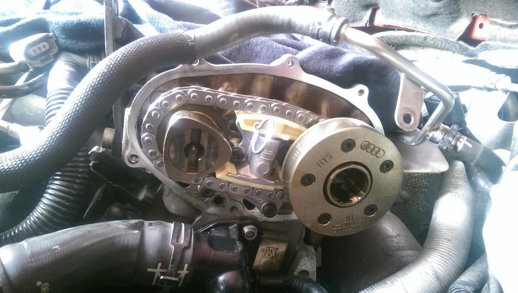

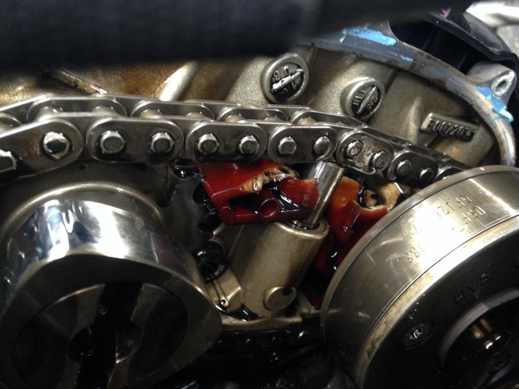

So this happened a few nights ago! Can't believe it, wedged the cam,stopping the engine and snapping the cambelt. Also bent a few valves in the process, gutted! Always serviced low mileage etc etc, can't believe the tensioner is sort of plastic! You guys heard of this before?
Here's what it should look like

I've seen quite a few people replace the can chain but not seen a failure before. That's real bad luck man. What you going to do, rebuild the engine?

mine had the bottom right hand portion broken off when my engine failed (AXX engine 87k) im not 100% sure what caused the failure but i had a snapped exhaust cam aswell, cost me around £900 to put right (replacement head, timing belt kit, cam chain & tensioner, 4x injector rebuild kits, some bolts, gaskets and broken dipstick tube and evap hose, also had to buy the cam locking kit and a polydrive bit for the head bolts adjuster bolt) did all the work myself so no labour charges

« Reply #4 on: February 07, 2015, 07:02:05 pm »
No warning signs, no more noise than normal, shocked!
Pistons and cylinders ok, just the valves gone, from what we can see so far!
So going to be rebuilt, new valves, belt kit and cam chain and tensioner and gaskets where needed.
