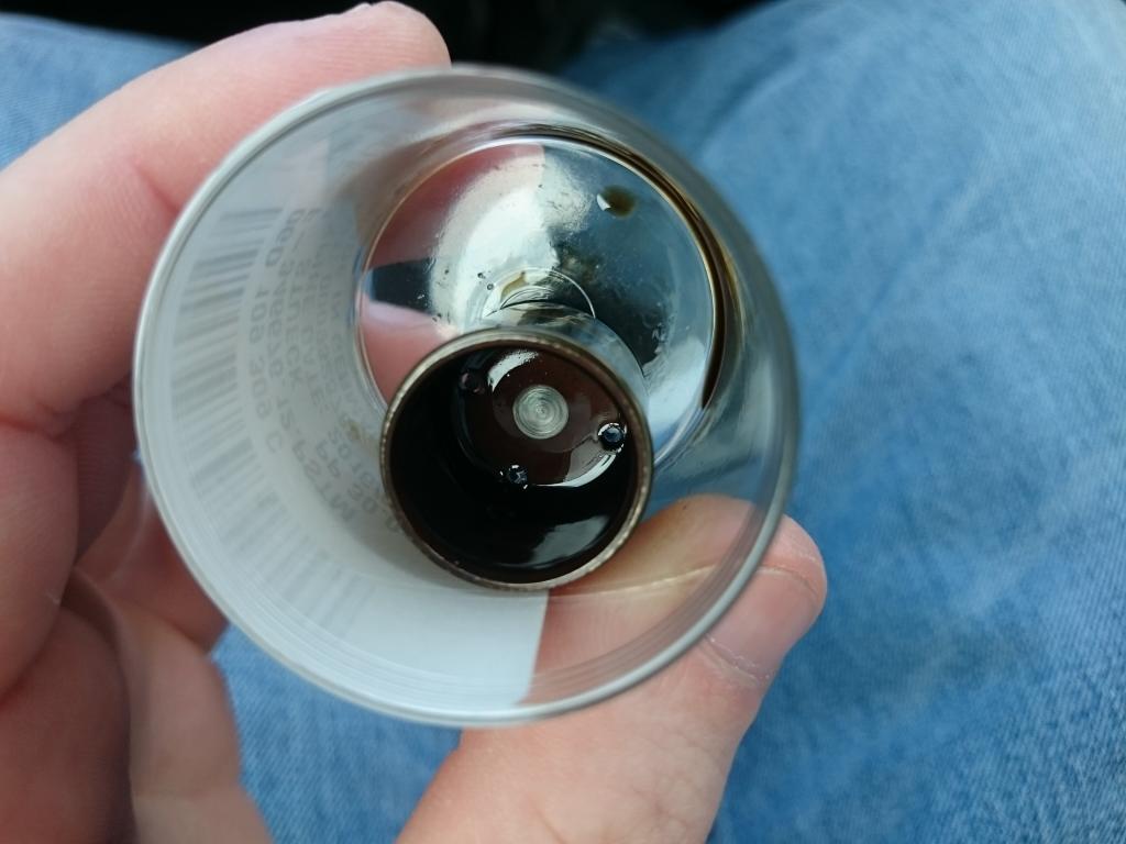

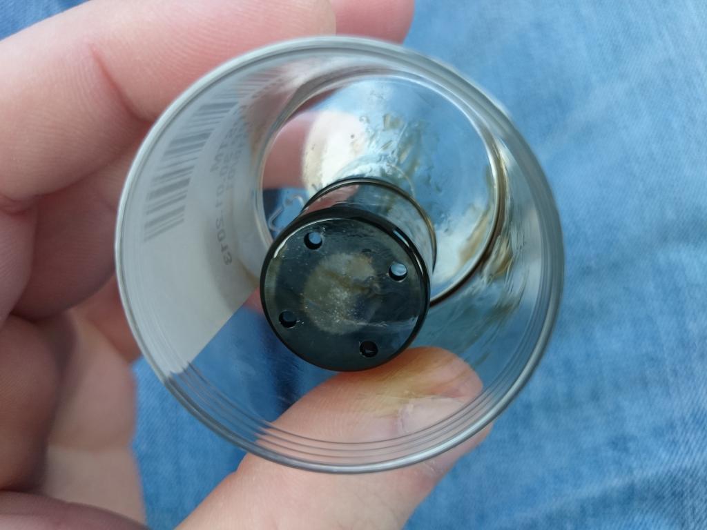

Got my valve changed last night along with my cam follower, also yesterday I manage to fit my red top coil packs with NGK IRIDIUM IX spark plugs BKR7EIX. Over all the idle is so much smoother, the characteristics through the rev range was nicer. Then got the valve changed later in the evening and to our discovery...it was in pieces. it feel apart when we took it out. The cam follower wasn't too bad to be honest, no history of it being changed. I'll get a picture of it later.
Now in neutral you can hear spool up when you rev it, didn't do that before. Noise factor through the exhaust is throaty boost. Spool up now even lower in the rev range. Felt weird pulling away from traffic lights with extra power. It must of been last year when the Rev D was failing.
Here's a picture I took last night once I picked up the parts from off the floor.

Re: Hesitating Boost help
« Reply #9 on: March 07, 2015, 10:38:55 am »
Offline muff1991
  • -Receive: 70
  • Posts: 929
« Reply #10 on: March 09, 2015, 12:23:43 pm »
wow, so she's all sorted... that's good news
ill be checking mine soon, I haven't checked it for 10 months so might be worth me checking.
personally I would of said that cam follower is borderline bad so good job you changed It anyway, I bet she's like an animal again  :jumping:
