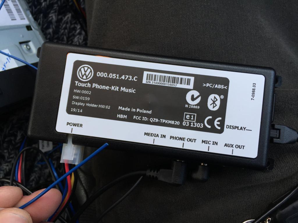

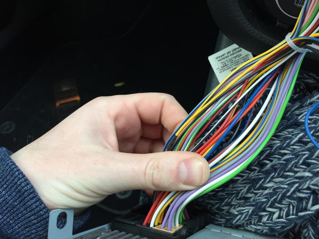

Looking for some help
wiring in a bury bluetooth kit to my mk5 golf gti and its all in except for the blue cable coming from the bury box which is "12 volt ignition positive" which is obviously the power for the unit as theres currently nothing when plugging it in. I just want to check what this should be connected to as I'm a newbie at electrics! is it to be crimped to the blue cable from the vehicle harness? or is it the yellow or red one?
Thanks in advance!

Youre better gettin am 'add a circuit' piggyback dual fuse and taking a switched live from the drivers side fusebox.
I put the same kit in when I sold mine and did just that, no tampering with wires that way
