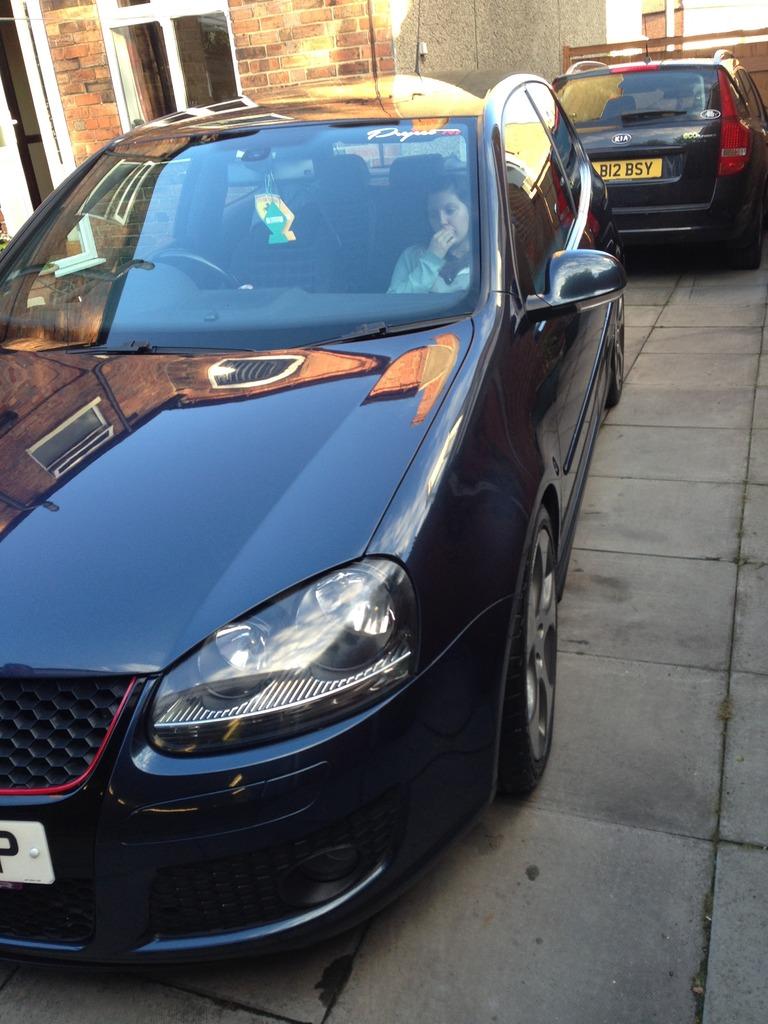

headlight before
headlight after(different side but same difference)

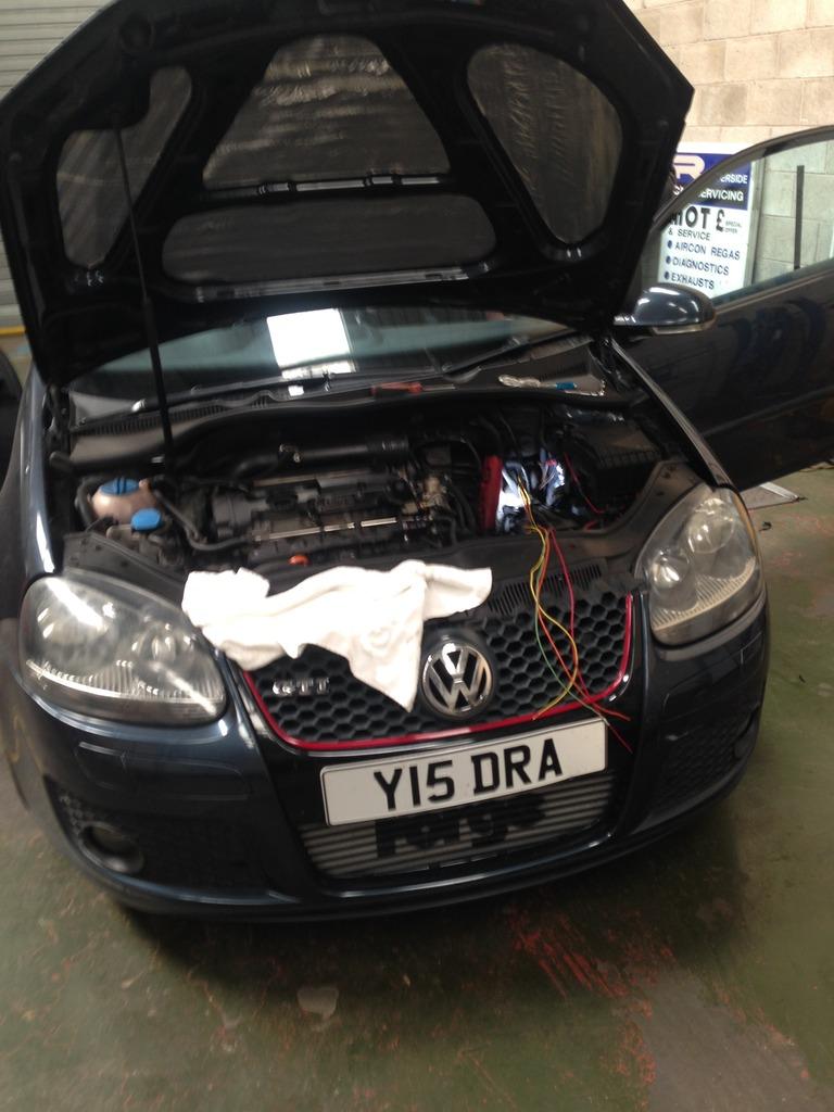

Finally got my Forge PCV
fitted my front mount intercooler at the week end love the look of it so left the grill off

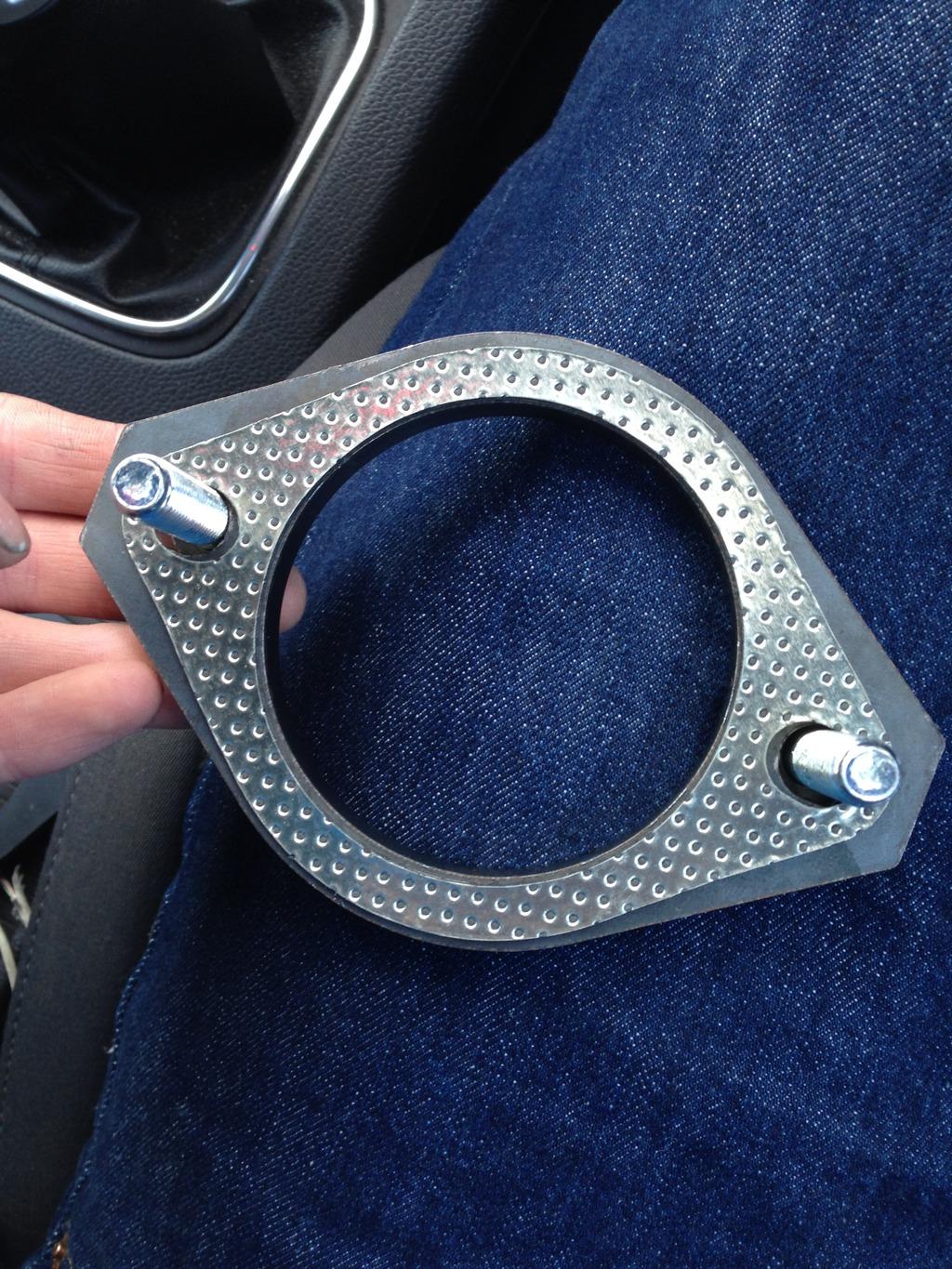

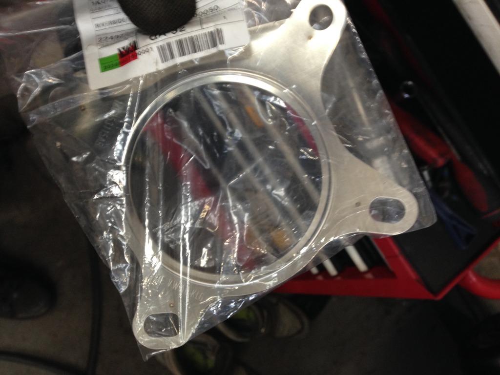

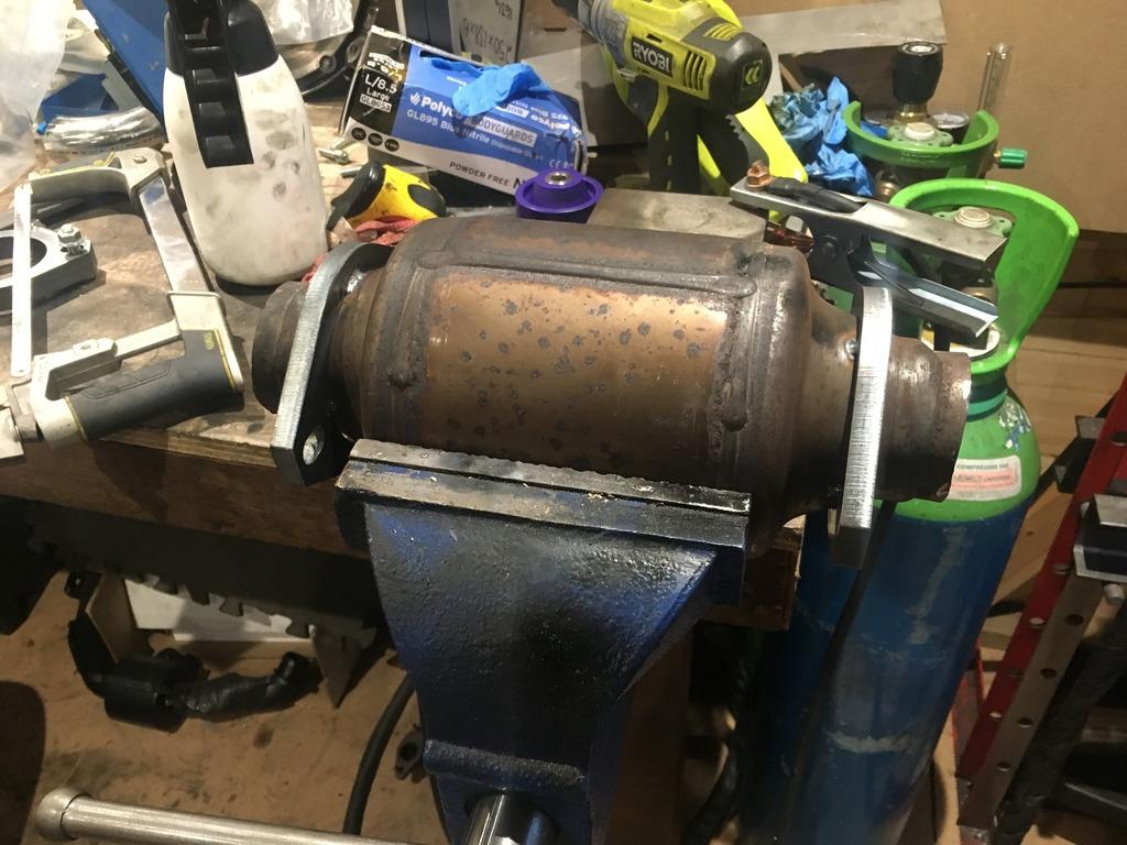

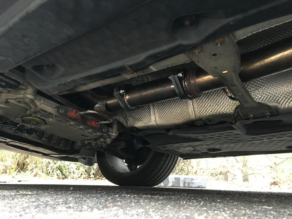

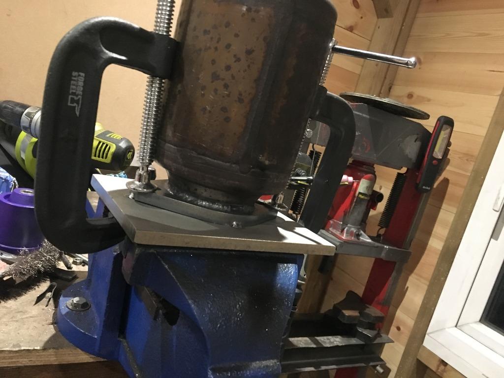

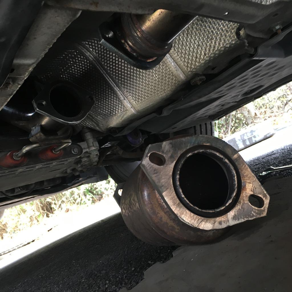

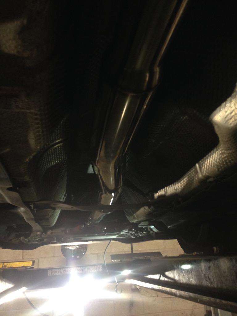

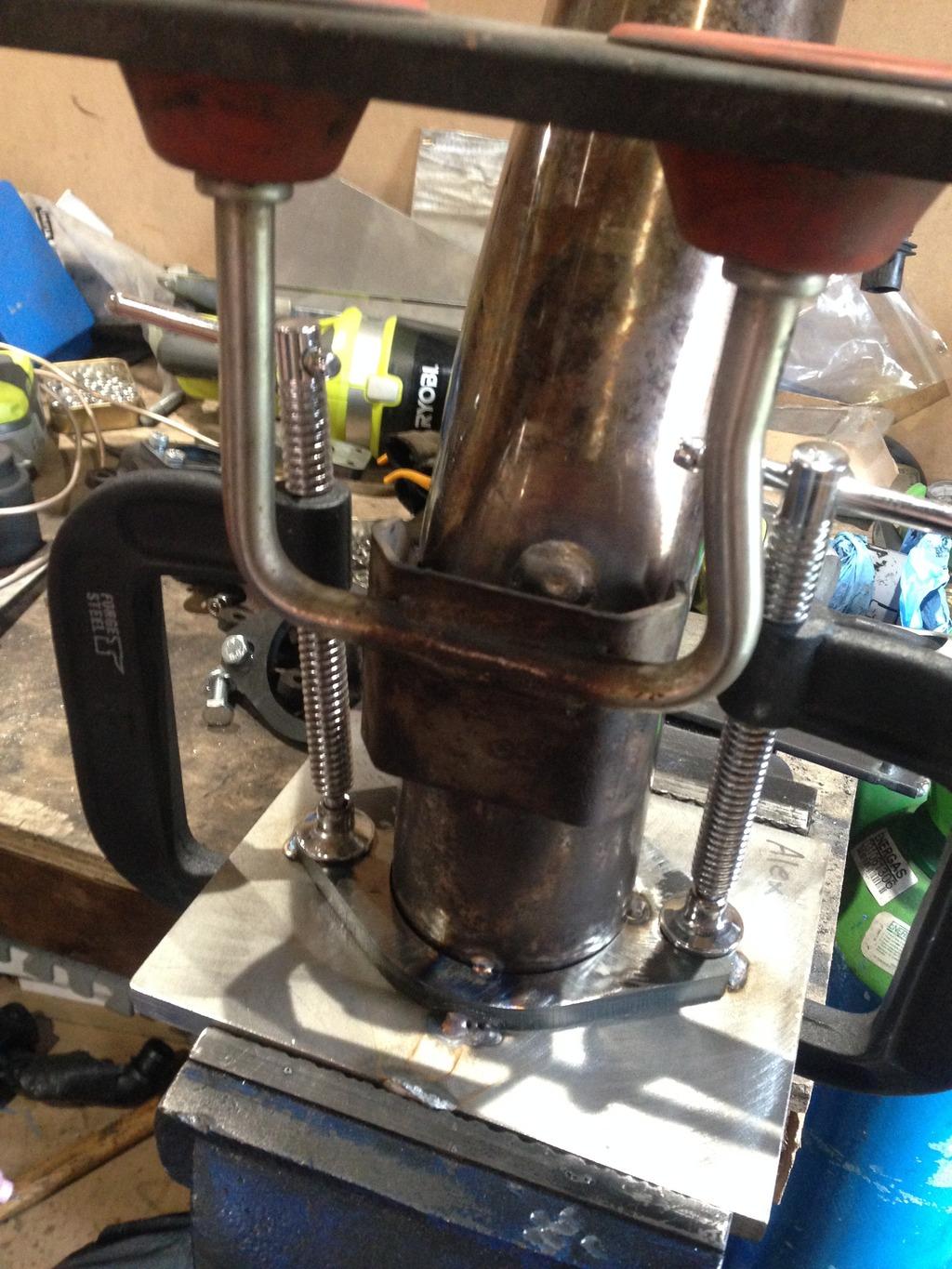

also got a new 3inch decat from eBay that i am going to weld flanges in and cut old cat from original downpipes so i can bolt the cat in for my MOT's and then bolt the straight bit back in.
3inch flanges and gaskets
original cat cut ready for flanges to be welded on
luckily they are tapered so can slide on till tight and then weld and kit the bit that is sticking out
needed to weld to metal plate so it doesn't warp with the heat
also got a go pro so suck to the rear of car and finally proof that it flames wow  :signLOL:
and i fitted 2 lower engine mount (doggone) bushes will take picture next time i work on it
will be uploading more pictures of my cat idea in 2 weeks as away this week end

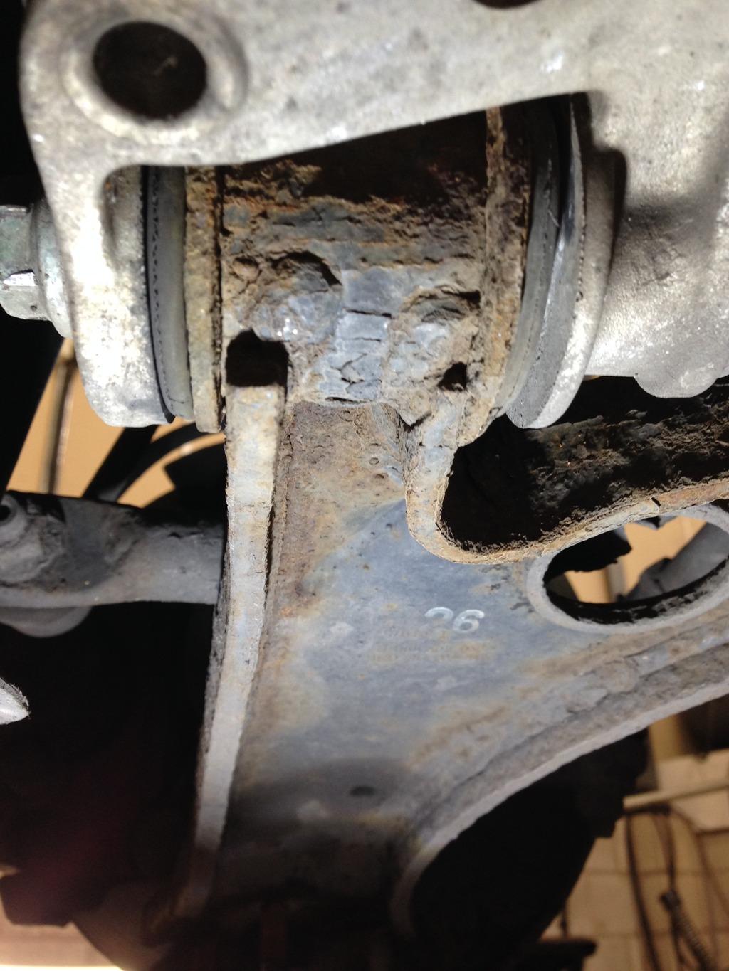

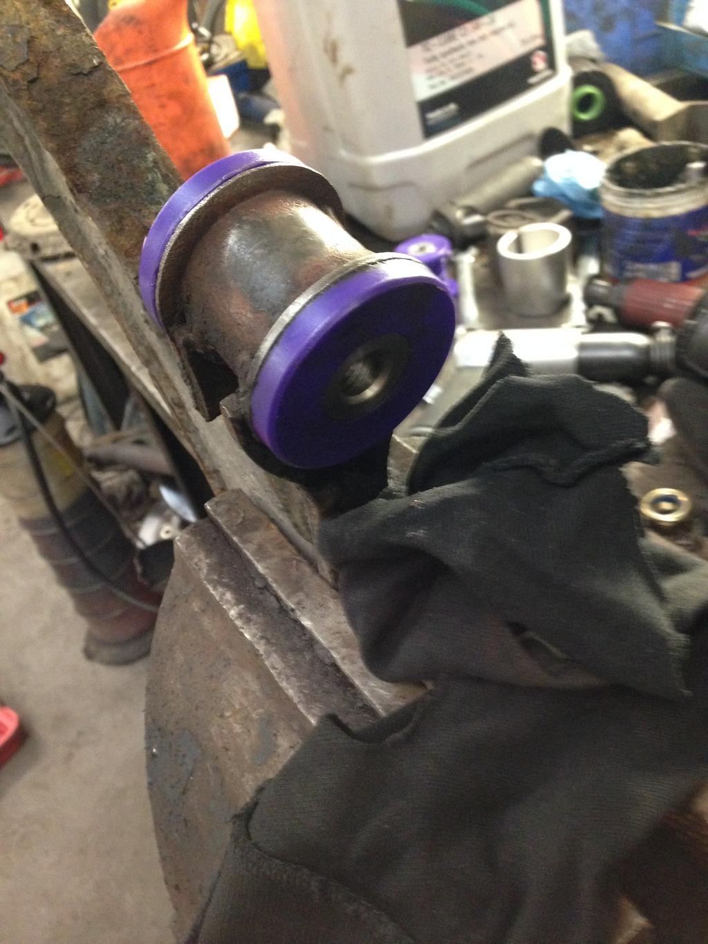

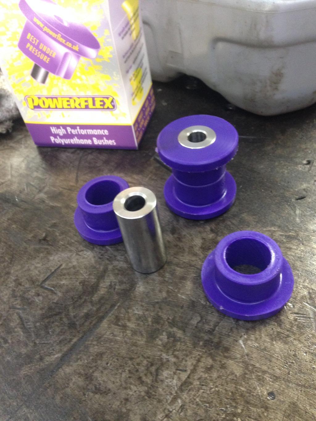

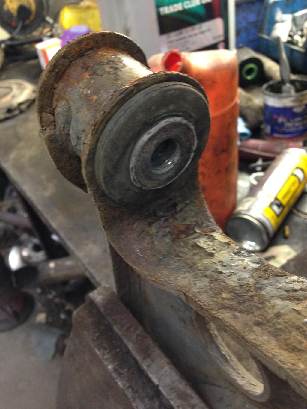

so i finally got round to fitting my front wish bone bushes (front)
heres a few picture

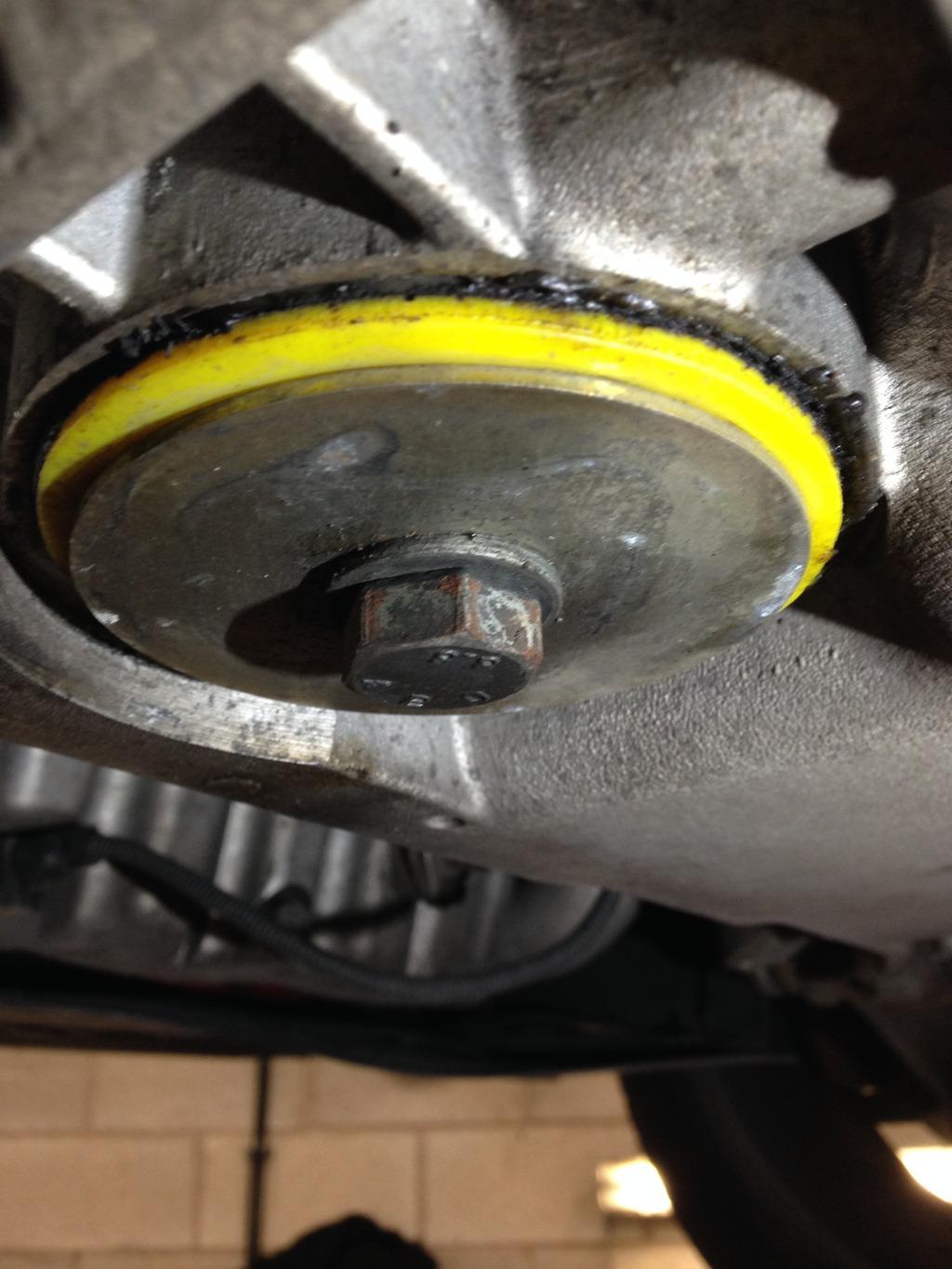

also here are two pictures that i managed to take of the dogbone mount bushes

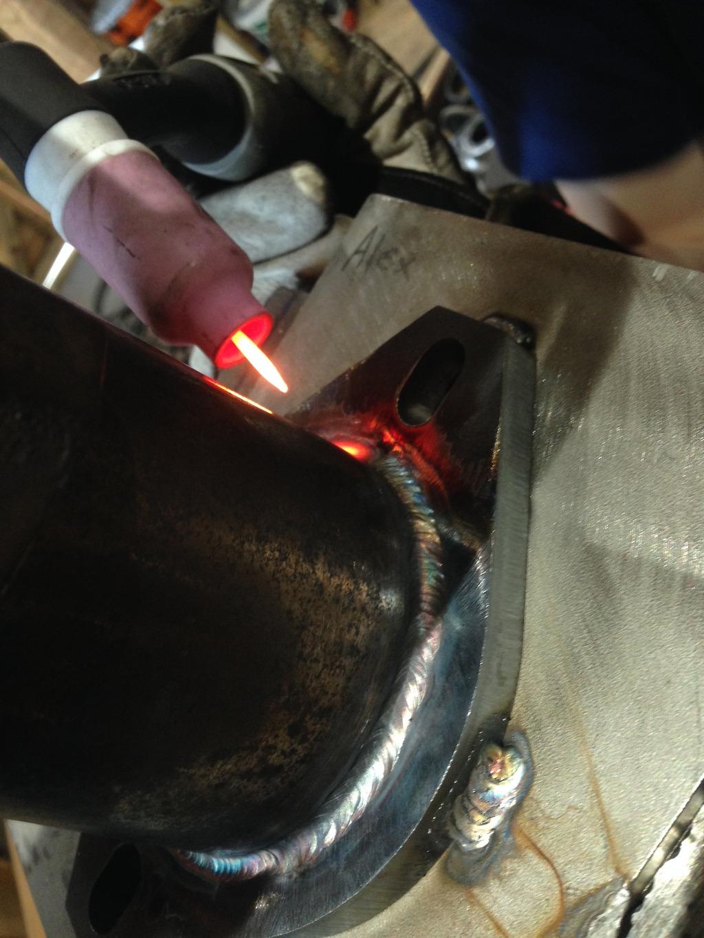

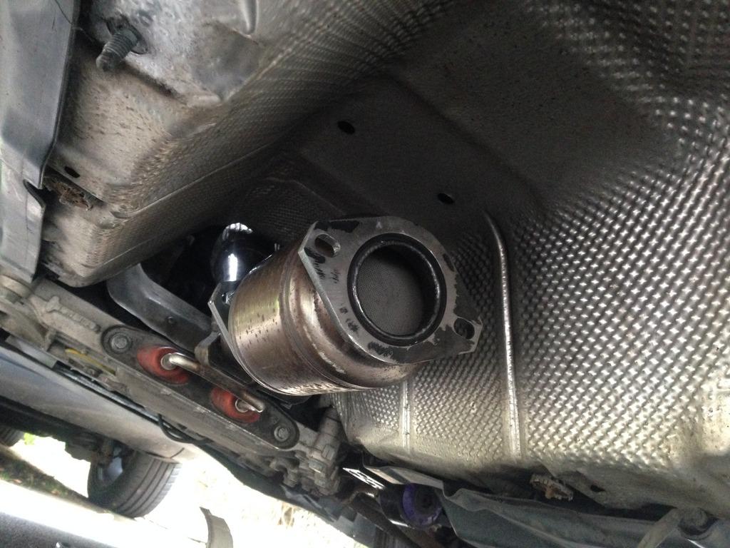

My car passed mot after my idea for that cat works  :happy2:
here are some pictures from last week end of making the removable cat,
we hat to tack the flanges on and test fit then tack to a plate so it doesn't warp when welding

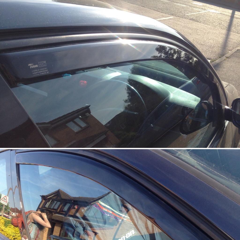

got some team Heko wind deflectors
