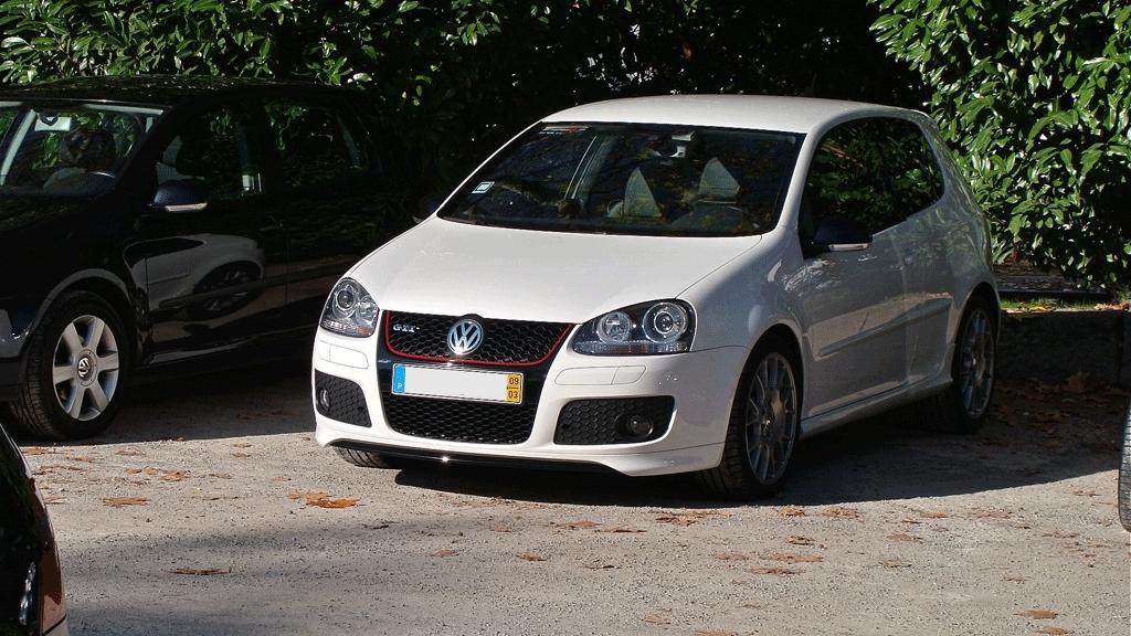

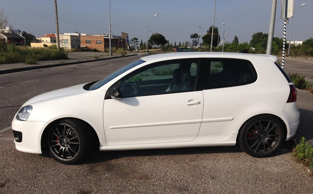

Hello again! After the diesel GT Sport I had to get the best petrol version. :grin:
So I'm the new owner of a Candy White 3 doors Ed. 30 with DSG MY2008. Most likely the only in my country with this colour. It's pretty much in mint condition and has less than 35.000 miles.
I already have a long list of mods to do and some were already ordered.
Here's an old picture. The previous owner made some changes to the centre grill and wheels but I'll return them to OEM look and fit my OZ instead.
My wife will have the diesel most of the times and we'll use it for long distance travels as well.

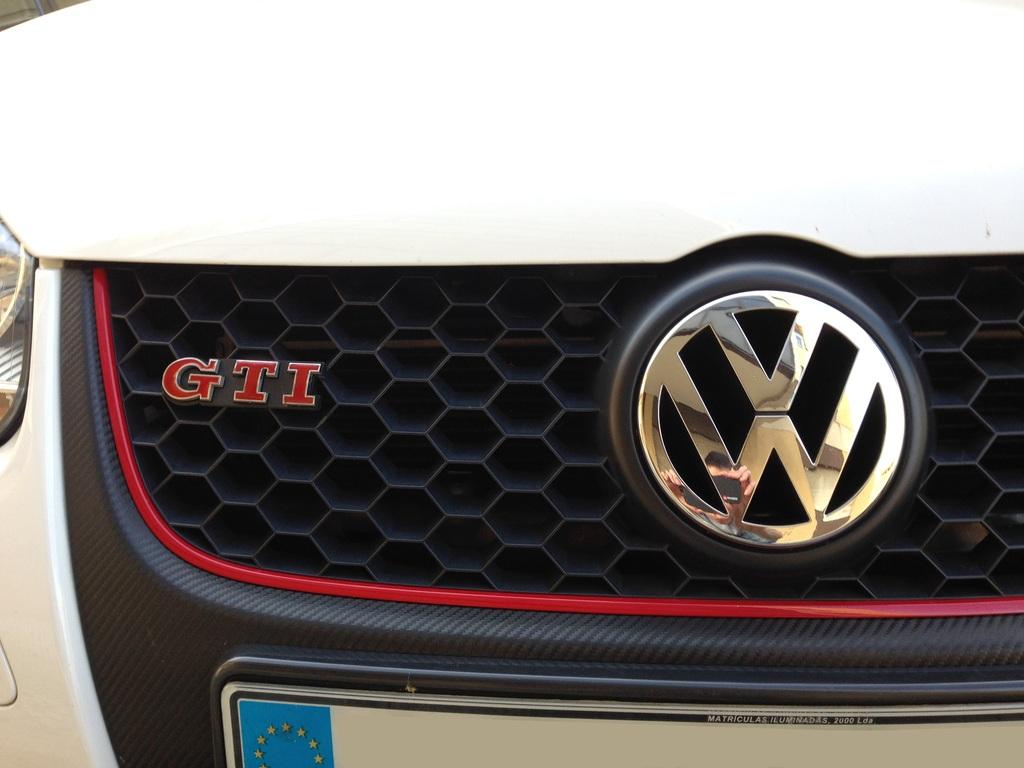

  • Front and rear red GTI badges
  • Edition 30 badge on the centre grill

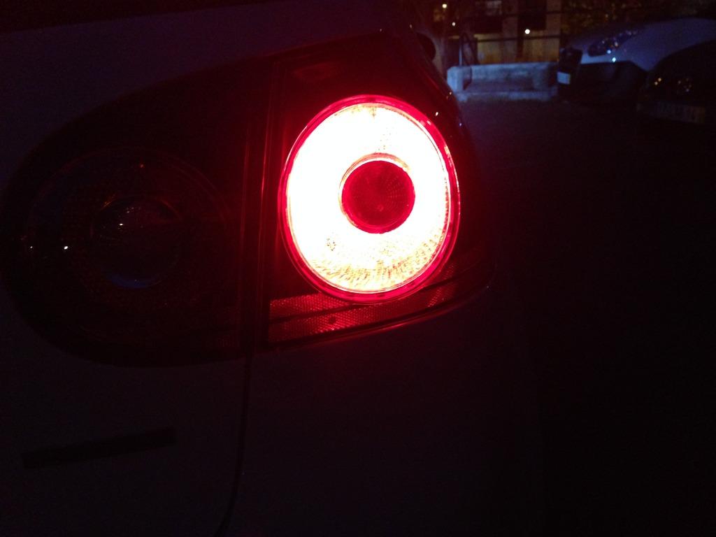

  • LED sidelights (6000K)
  • LED wing mirror puddle lights (6000K) -> upgraded
  • Full LED wing mirror puddle lights (6000K)
  • Mk6 Golf LED numberplate lights (1K8943021C)
  • LED brake and parking lights
  • LED reverse light (6000K)

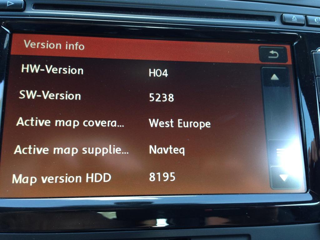

  • RNS-510 firmware upgrade to modified version 6276 with secret menu and VIM activated

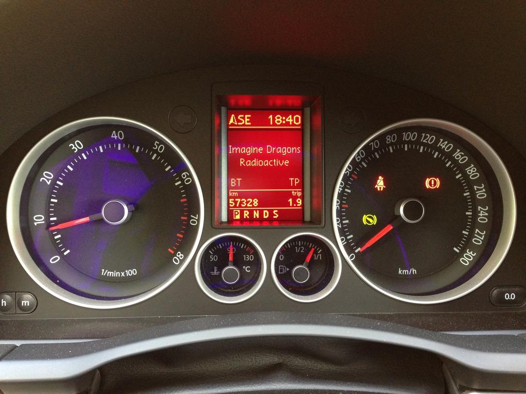

  • Bluetooth kit upgrade (7P6035730M) with Polar BT/Battery module for MFA+ display

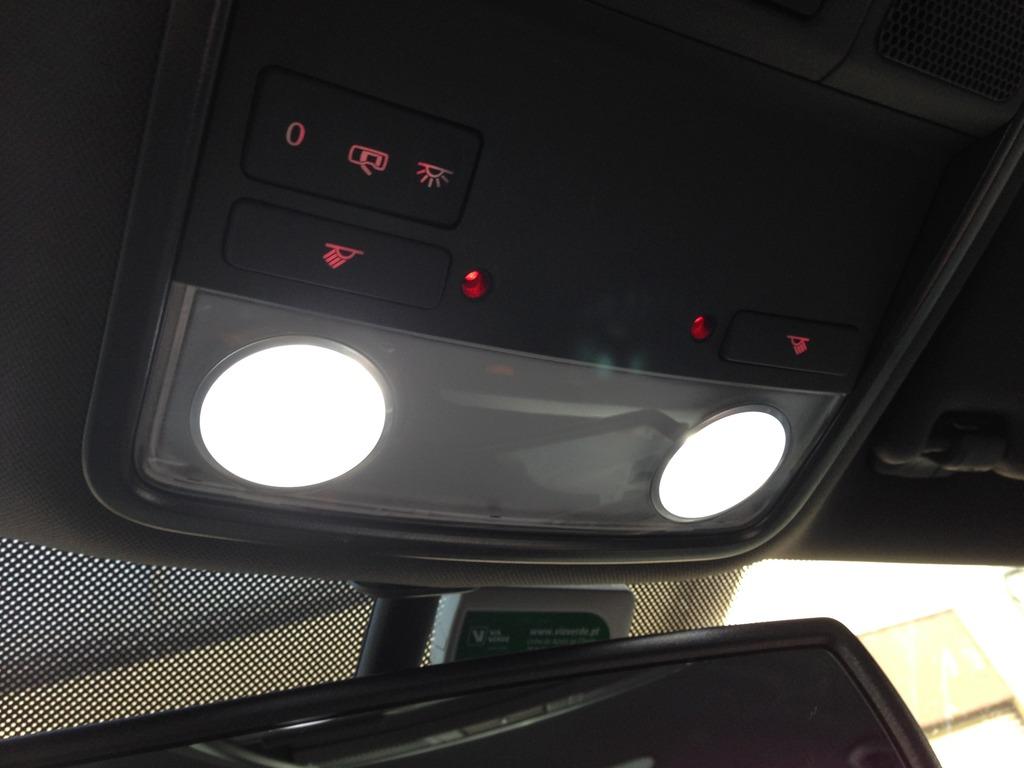

  • Complete interior LED set (6000K)

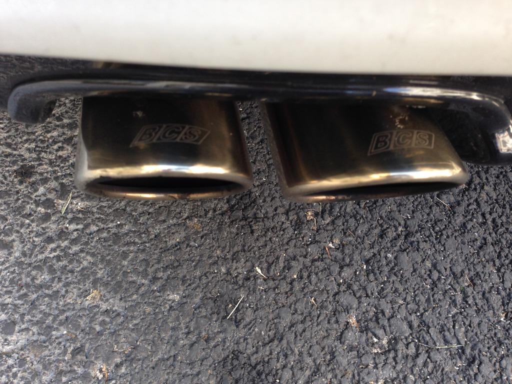

  • BCS Powervalve TBE Prestige system with 200 cell cat and wrapped downpipe

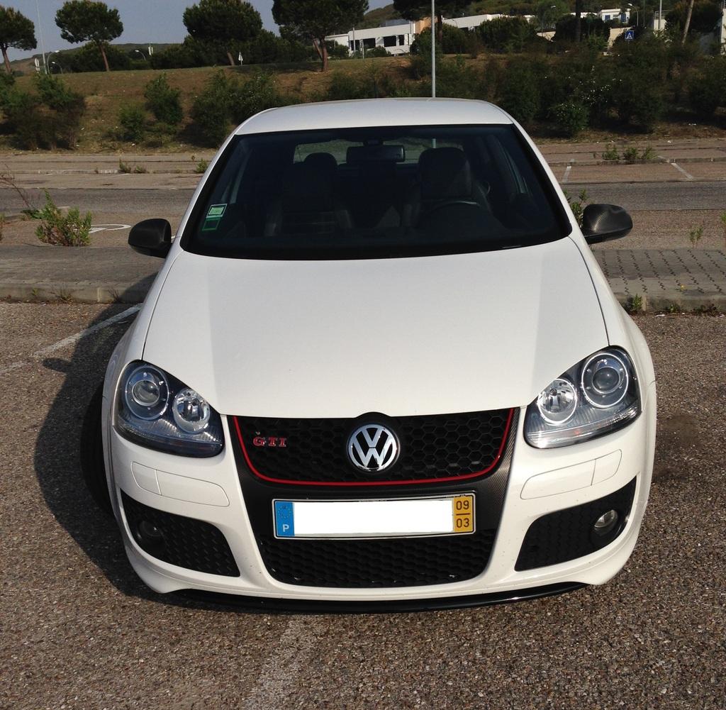

So far I've removed the carbon wrap of the VW front badge, fitted OEM LED numberplate lights, fitted the OZ and updated the RNS-510's firmware, maps and POI.

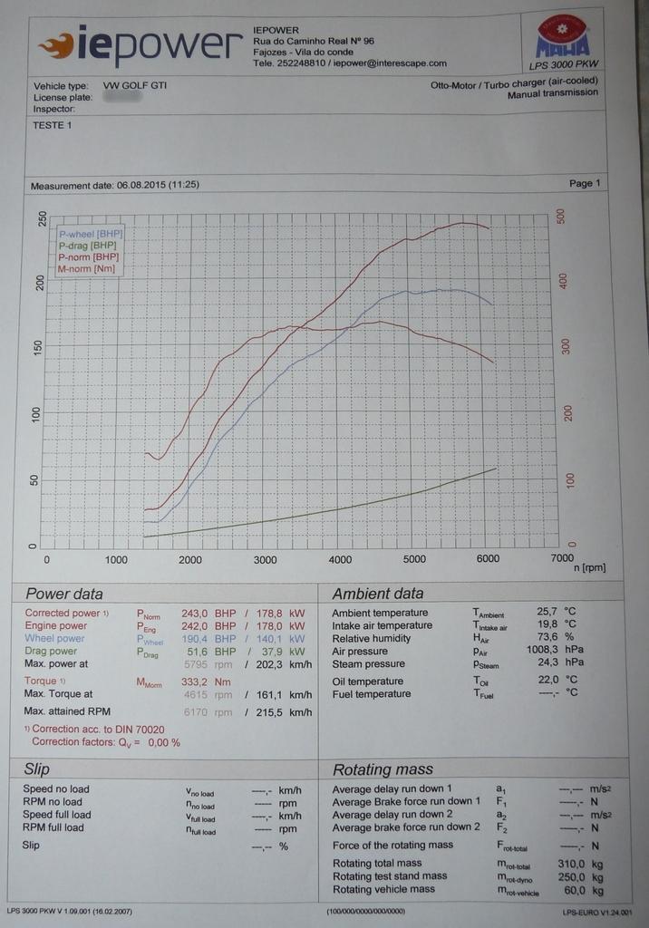

Here's the output with the stock map and the following mods:
  • ITG Profilter panel filter (WB586)
  • CM Exhaust manifold heat shield
  • NGK Iridium BKR7EIX spark plugs
  • R8 red ignition coil pack set
  • BCS Powervalve TBE Prestige system with 200 cell cat and wrapped DP

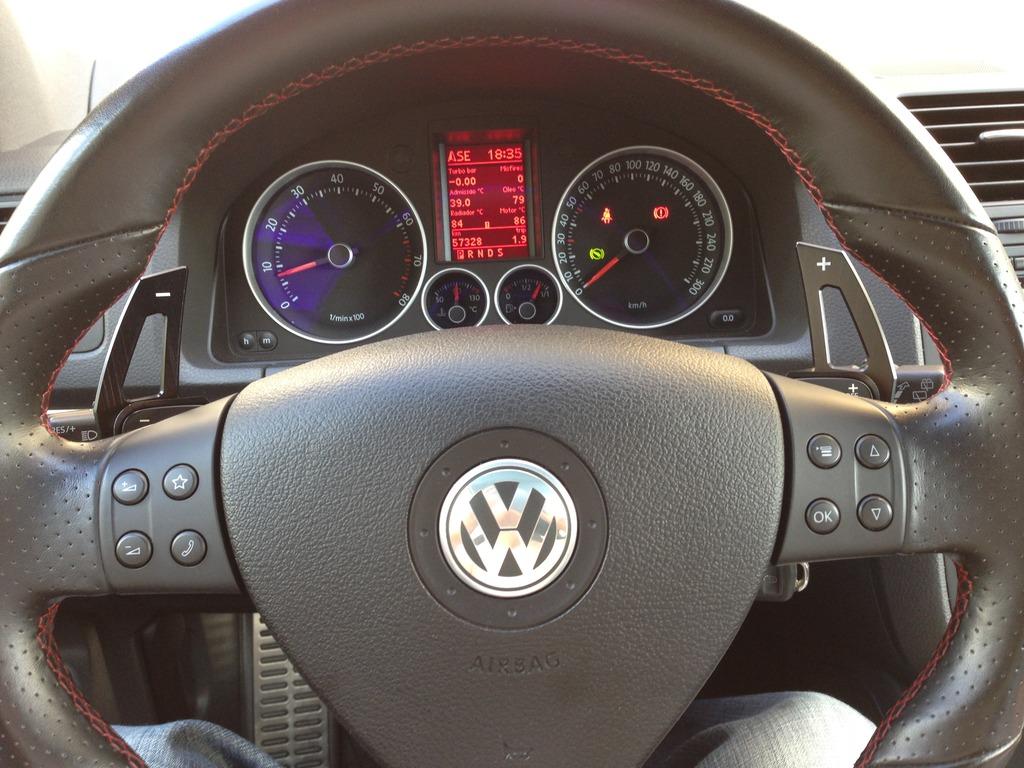

With all the mods fitted so far the car is making 330 BHP and 457 Nm/337 lbf*ft, with 1,4 bar of peak boost and 1,24-1.21 bar of stable boost.

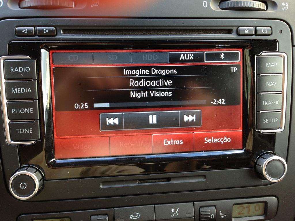

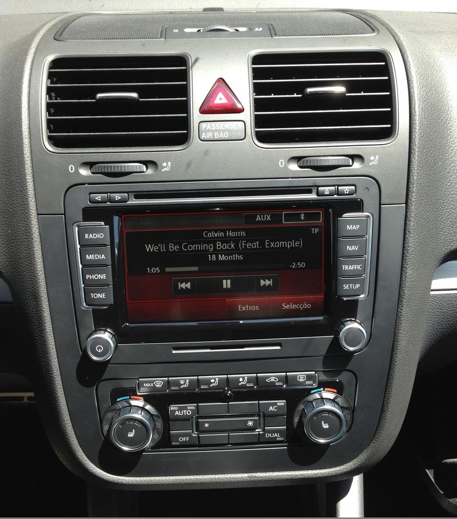

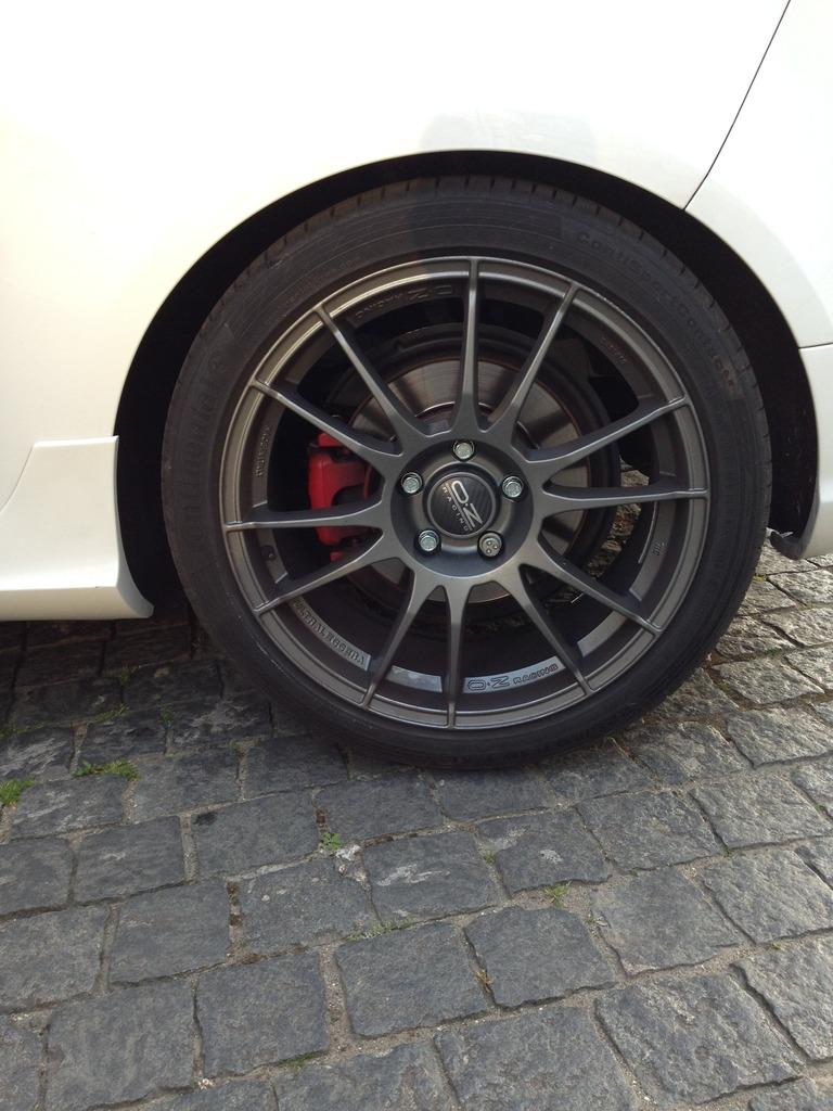

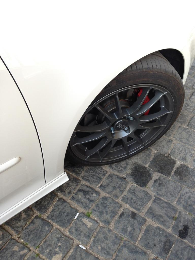

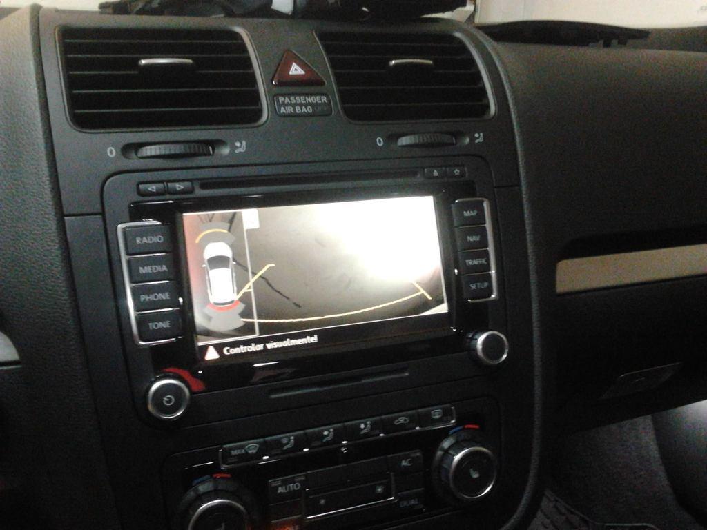

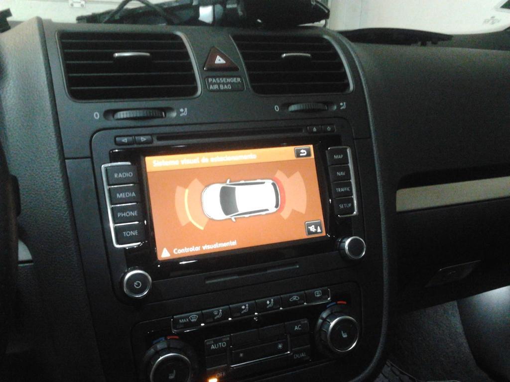

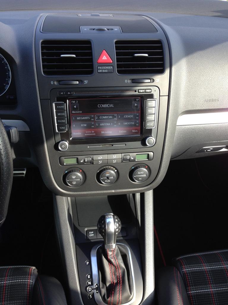

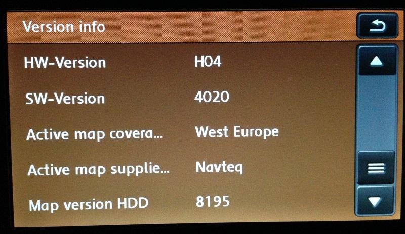

    Yeah, you're right, this is still very poor on pictures but only Thursday I had my OZ fitted and I didn't have any good chance to take them yet. :|
    Managed to update the factory fitted RNS-510 version A to a modified firmware that gives more disc space for maps, allowing to install the current V12 (2015) maps. Link for the firmware: http://www.rnsfirmware.com/firmware-4020-for-older-units-in-europe-with-hdd-rations-60355/
    I had to use a CD-R from Verbatim do get the unit to read it properly. It didn't like the CD-RW from Sony that I used previously to update a previous version B and my current version P. Fortunately it liked the DVD+R DL from Memorex and copied all of the maps at the 1st attempt.
    I'll try to take pictures soon, before it starts to rain like it's forecasted.
