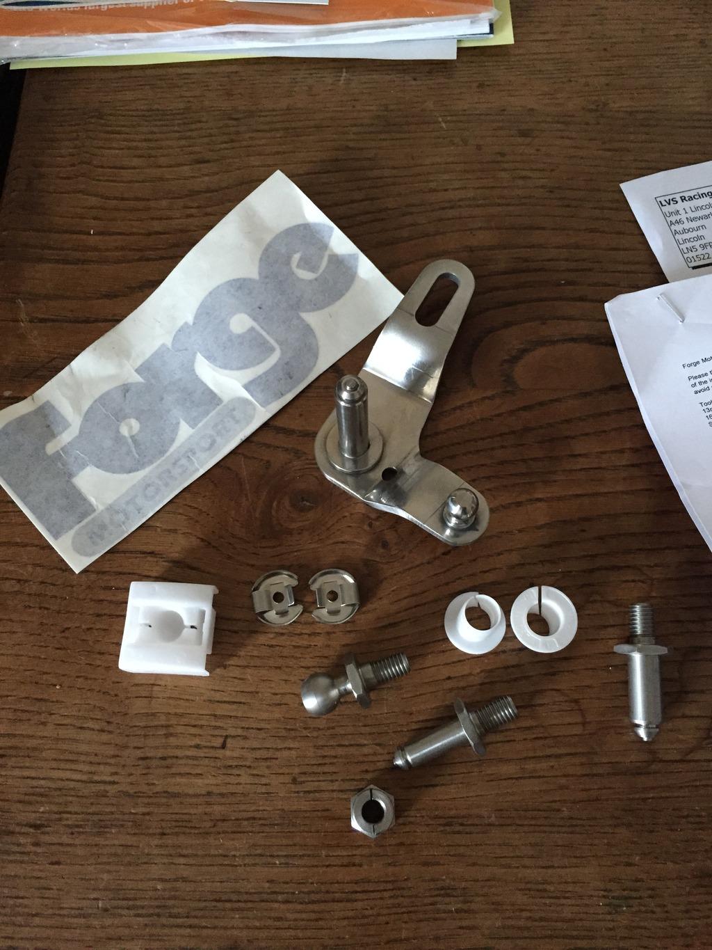

I had some pretty sloppy shifting so I installed a Forge Short Shift Kit
You can see the comparison of the OEM plastic version and the uprated Forge one - only took me 20mins to change
Great well made upgrade that has tightened up the gear stick
Got it from the link below
