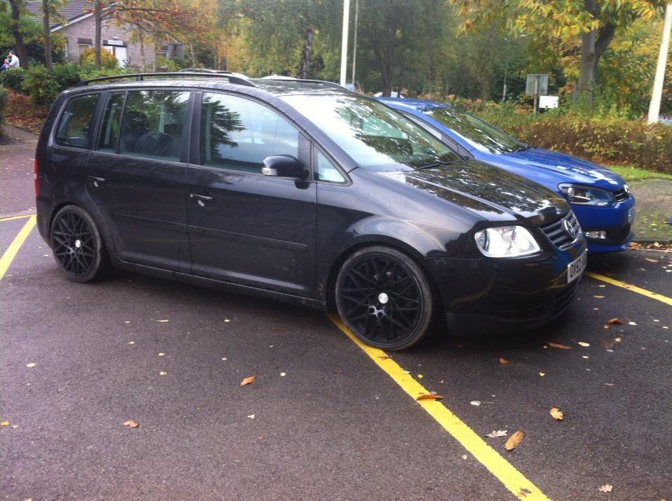

This is my old touran tdi on ap as low as they go
My current touran on kw as low as they can go
They are pretty similar heights, maybe 10mm difference but the ap handled much much better than the kw do, like i say raising is not an option especially as the ap performed much better at their lowest setting
