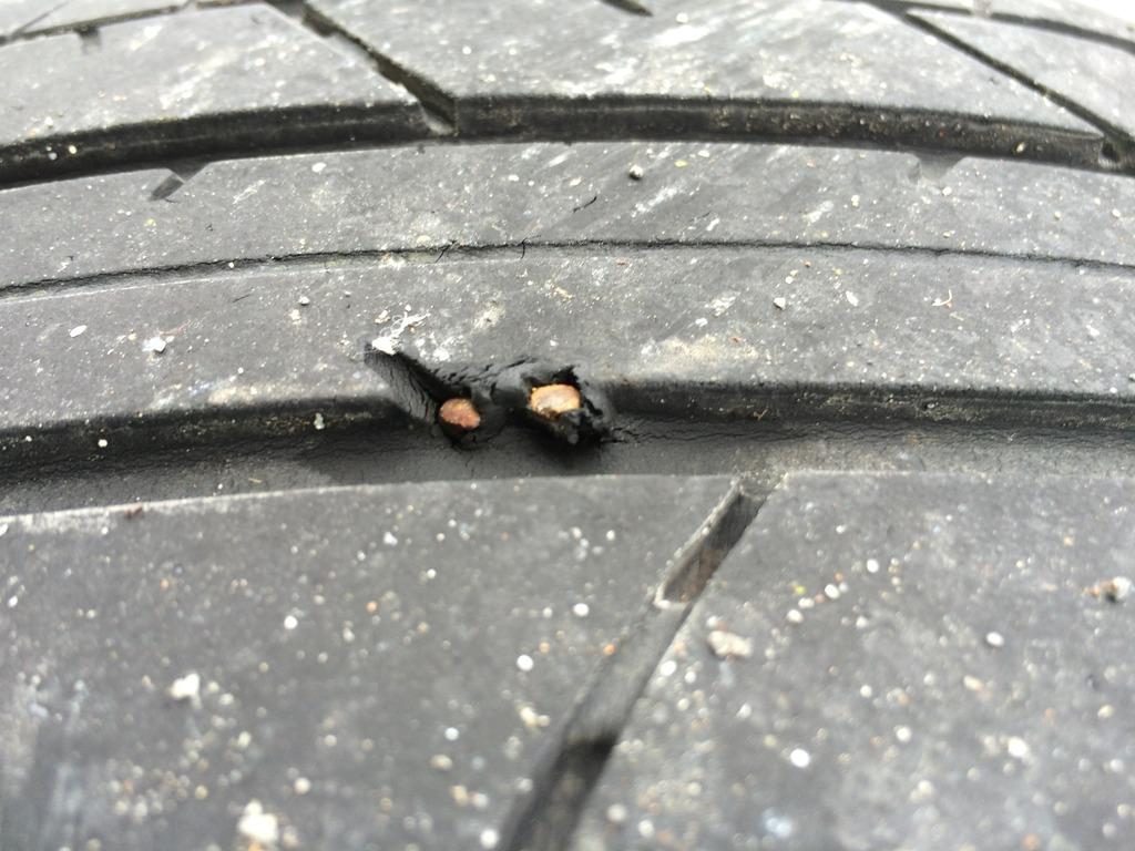

Last week my pressure sensor went off so I briefly checked the tyre and re inflated but missed the damage.
Took the tyre off today after dropping .4bar in a week and I see these 2 screws.
I've ordered a new tyre which won't be here until Monday.
Will I be ok for the week? Considering I already made it a week!

Quick update actually, as you can see from the photo there are 2 nails in the tyre.
Any tyre fitters able to tell me if this can be plugged?
I've left the car locked up for the few days until my new tyre arrives but this could be next week so I might just get it plugged.

« Reply #6 on: April 14, 2015, 09:59:15 am »
A competent tyre shop should easily be able to repair the affected areas, so long as they are on the central 3/4 width of the tread.
Some places may have a go at fixing punctures outside of this area, but they're not really covering themselves if they do

« Reply #7 on: April 14, 2015, 10:07:49 am »
@maxitrol
Id say that those are too close to be plugged separately. Andy will tell you for sure...

« Reply #9 on: April 14, 2015, 10:36:48 am »
They ARE TOO CLOSE to be plugged individually hopefully only one has gone through then that will be fine :)
Small plugs need around 15-20mm clearance on the inside of the tyre sure to surface area of the patch and large plugs need around 30-35mm hope this helped.

« Reply #12 on: April 14, 2015, 01:01:08 pm »
If both nails have gone through then as mentioned it can't be plugged just use the car but keep a watch on the tyre pressure
