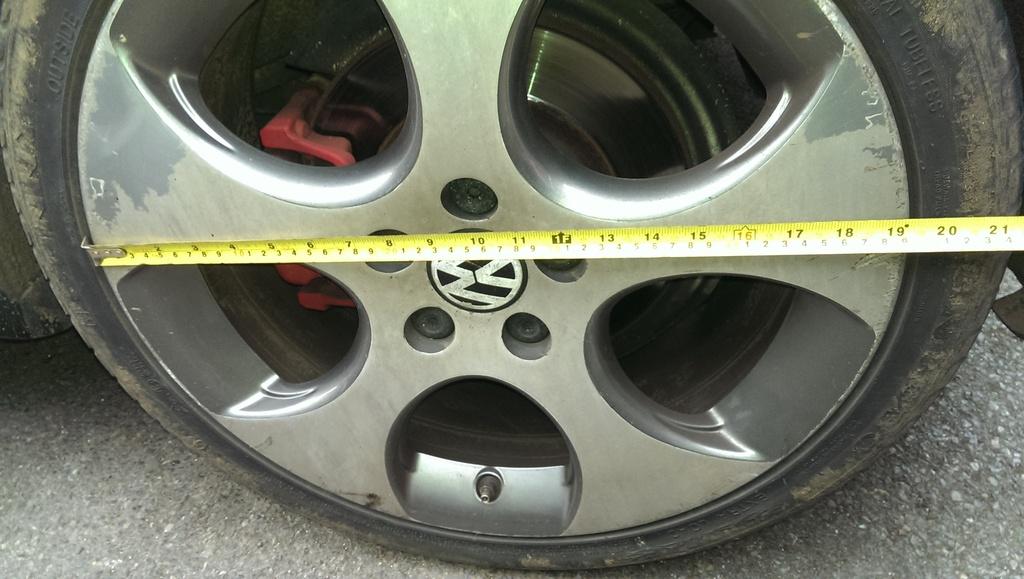

Wasn't sure what size my alloys were so decided to measure them...between the extents of the alloy (the true diameter of alloy) measured 495mm. When it says 17" or 18" does it mean 18" from one side of the alloy to the other? Or is it something weird. 18" in mm is 457.2

You measured lip to lip the outer edges but the Tyre sits below the lip so your size is 38 mm or so over 18 inch that's a 20 mm lip which sounds about right

Cheers, I think its a bit weird that the visible alloy is 19", but there called 18"!

CRUEL. Thought I had 19" monzas!... Even if they are in a terrible state. Won't be for long though...refurb planned

If the number on your tyre side wall reads 225/40/18, then you have 18" wheels.
