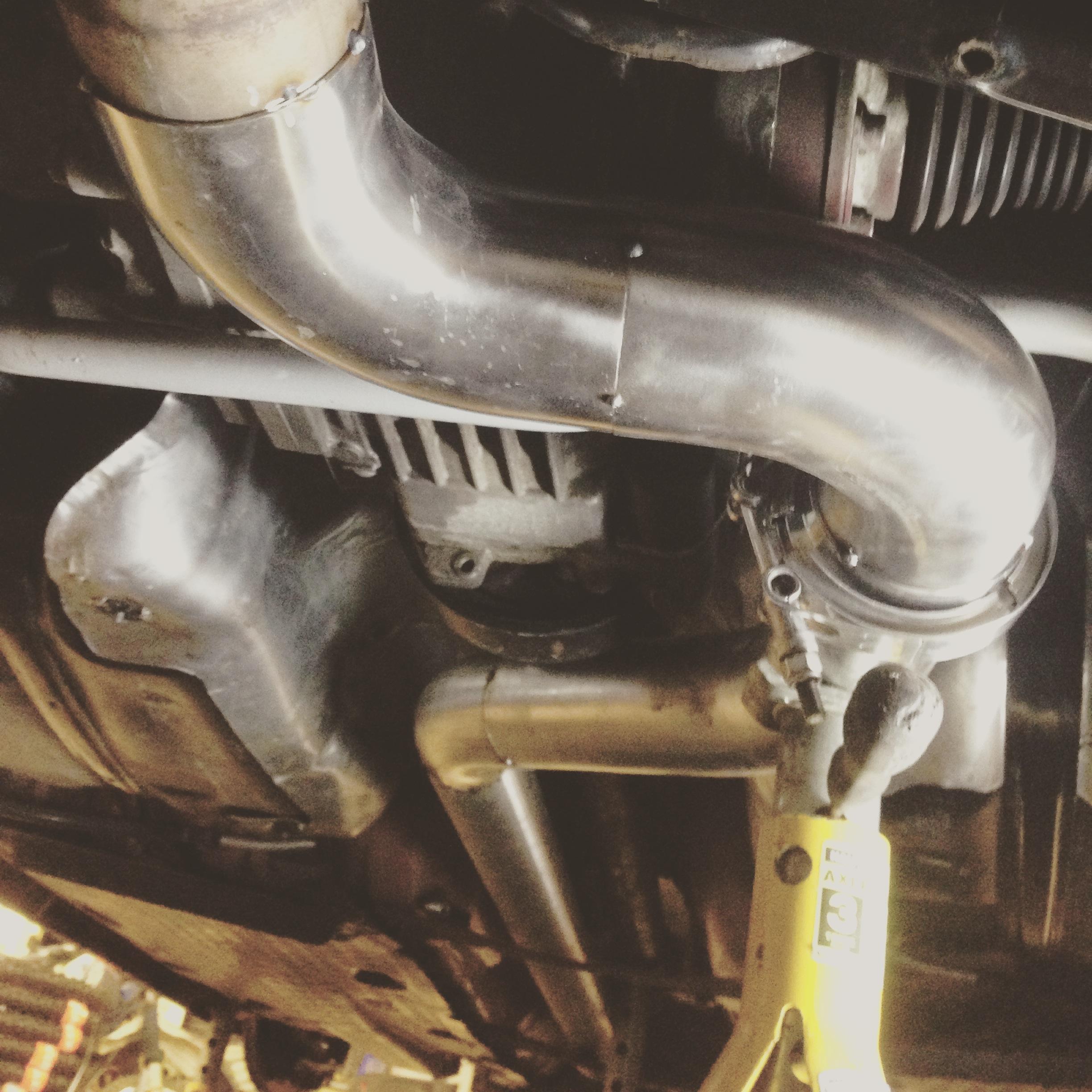

as far as the conversion goes it's done, i'm just waiting for feltham propshaft services to pull their finger out and do my propshaft, after giving it to them a week before i wanted it and explaining i had to have it by early last week they hadn't even started doing it by friday so looks like it's going to be a week late at least - thanks guys

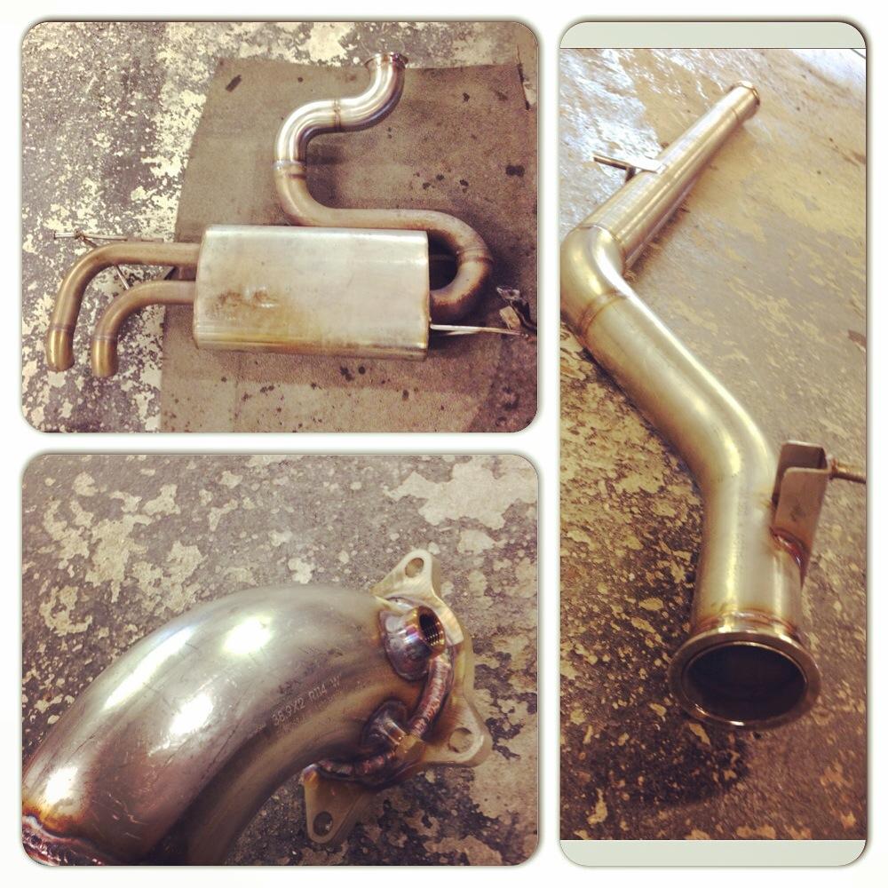

luckily i managed to borrow a prop off @moores_motors so i could build my exhaust / downpipe around it so that didn't hold me up further. i also ran into the problem of rear subframe bolts, touran ones were waay to short, s3 ones were 15mm too short after a day spent calling bolt suppliers i started to worry - so took it to facebook and luckily my buddy moose managed to find the perfect solution - M12 X 1.5 X 145mm rear subrame bolts off of 2009 audi a7 quattro, so rang vw who got them in via TPS same day :

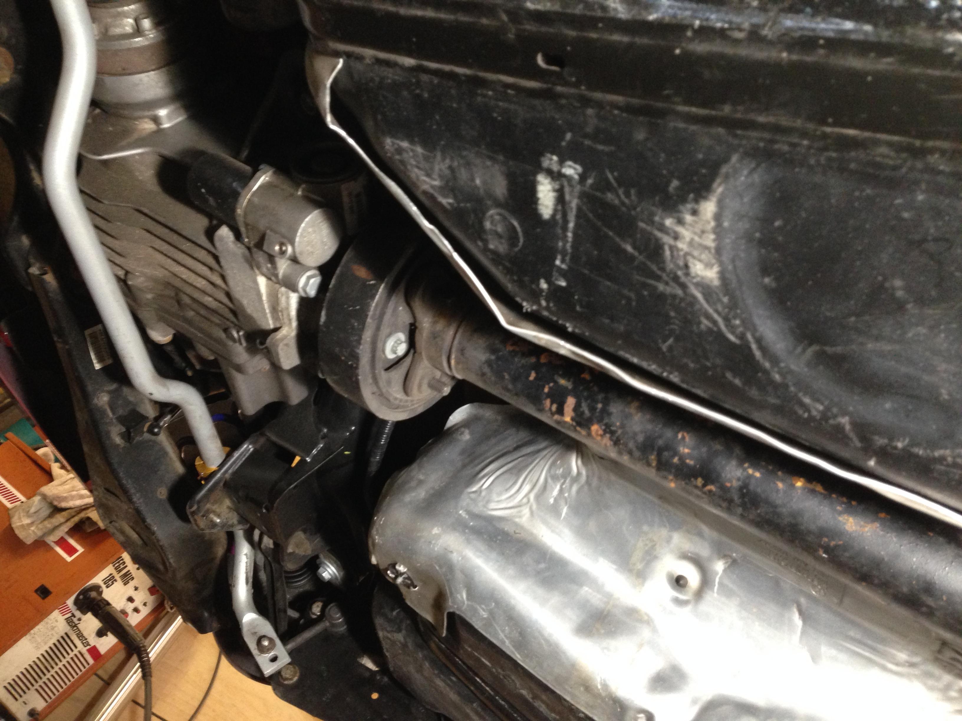

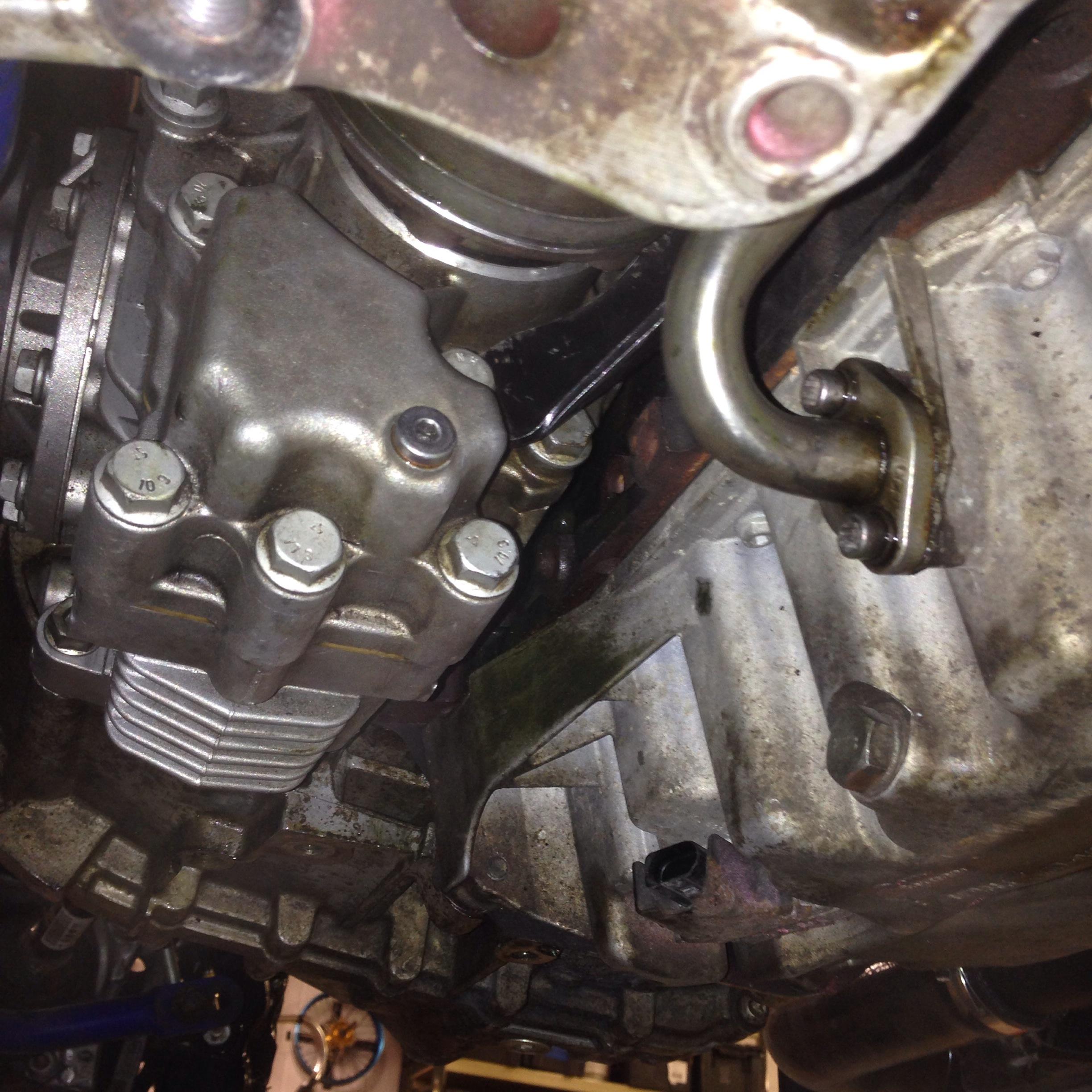

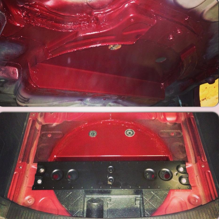

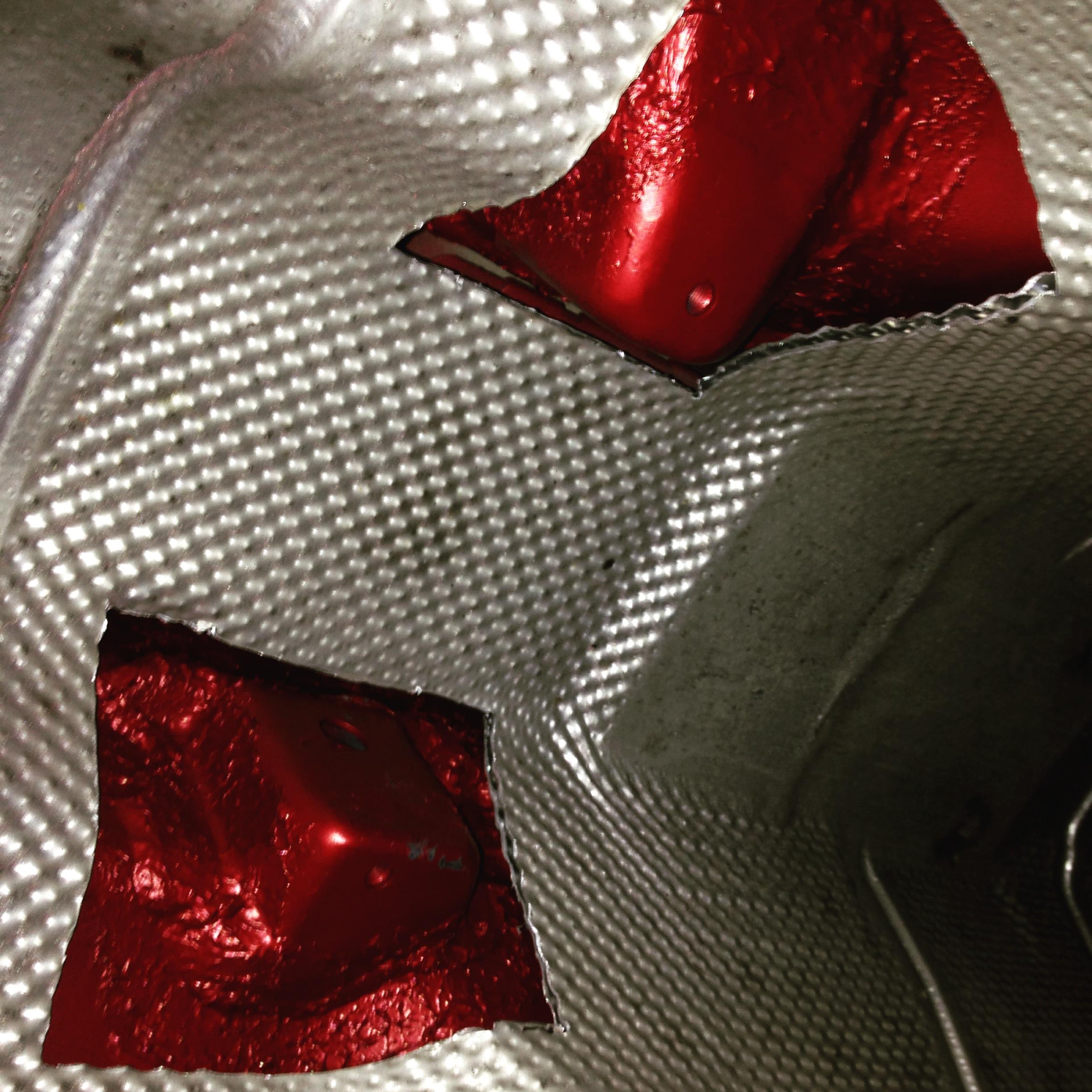

as far as the build goes i did underestimate how hard the rear end was going to be to fit up - i can confirm NO the rear floor is not the same as golf / leon / a3 etc - similar yes but not the same and far more work involved to get subframe mounted
also the fuel tank gave issues, the touran is longer in that portion of the body so all new mounts had to be made up to mount the tank and a new cross member installed .
on top of that the propshaft mounts i bought needed a lot of modifications/ fabrication, it was decided to extend the shorter part of the prop as the propshaft company was worried that extending the long part would make it too long and would give the 'skipping rope' effect
