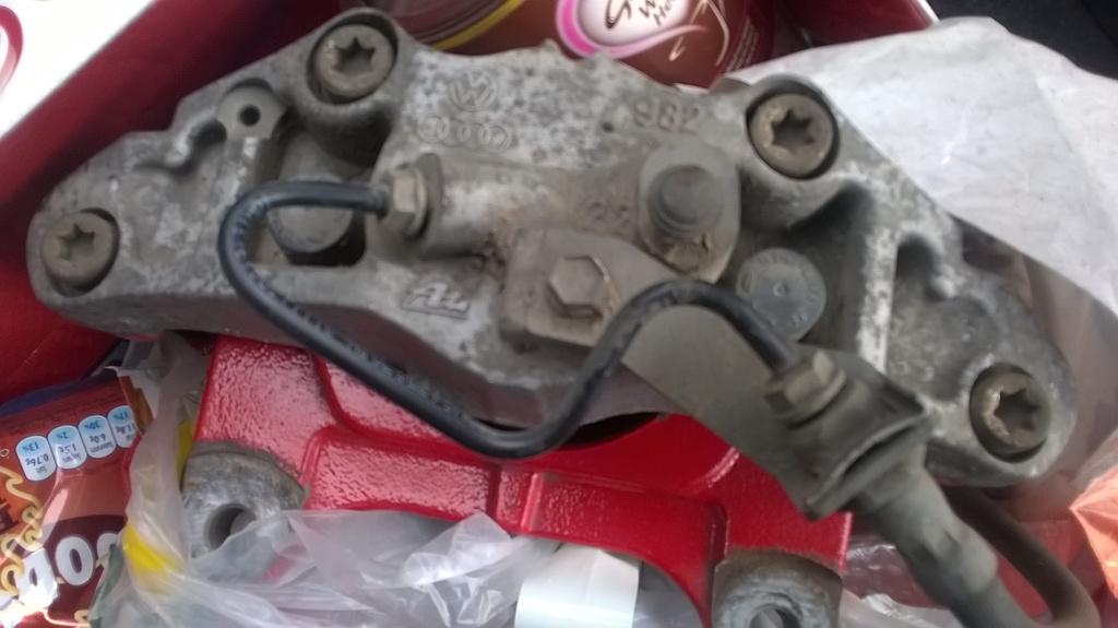

This is my r32 calipers, does this mean that r32 braided hoses will fit these to my gti no problem?
Offline skard
  • -Receive: 245
  • Posts: 2674
Re: r32 front brakes
« Reply #12 on: April 28, 2015, 10:03:53 am »
Yes just standard length R32 hoses will do. Same fittings you have now on the rubber hose but a little longer in length
