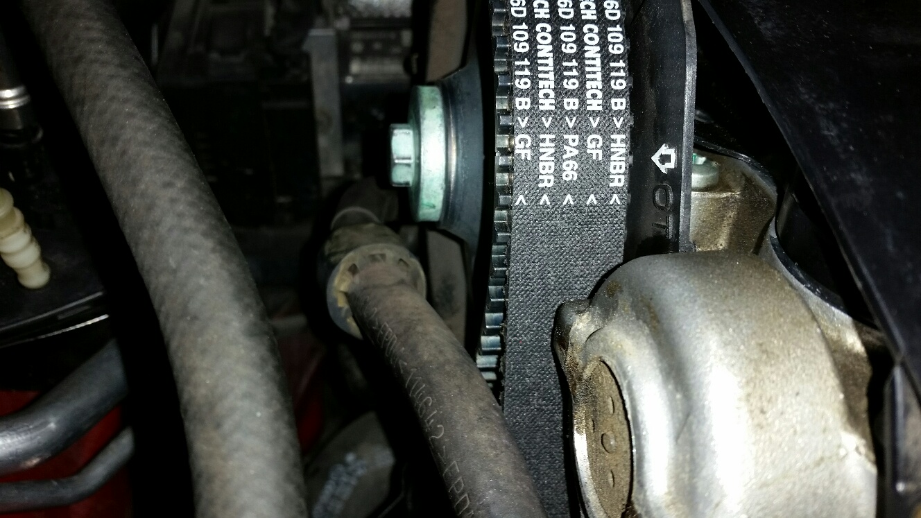

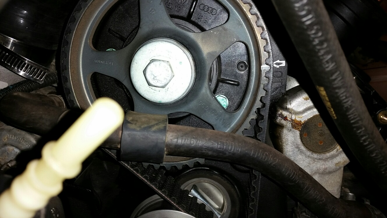

The belt is on just waiting on the new cover. Got it one tooth out the first time. Will triple check tomorrow when i put the pulley back on.
Got the main stat out hopefully will finish this all off tomorrow.

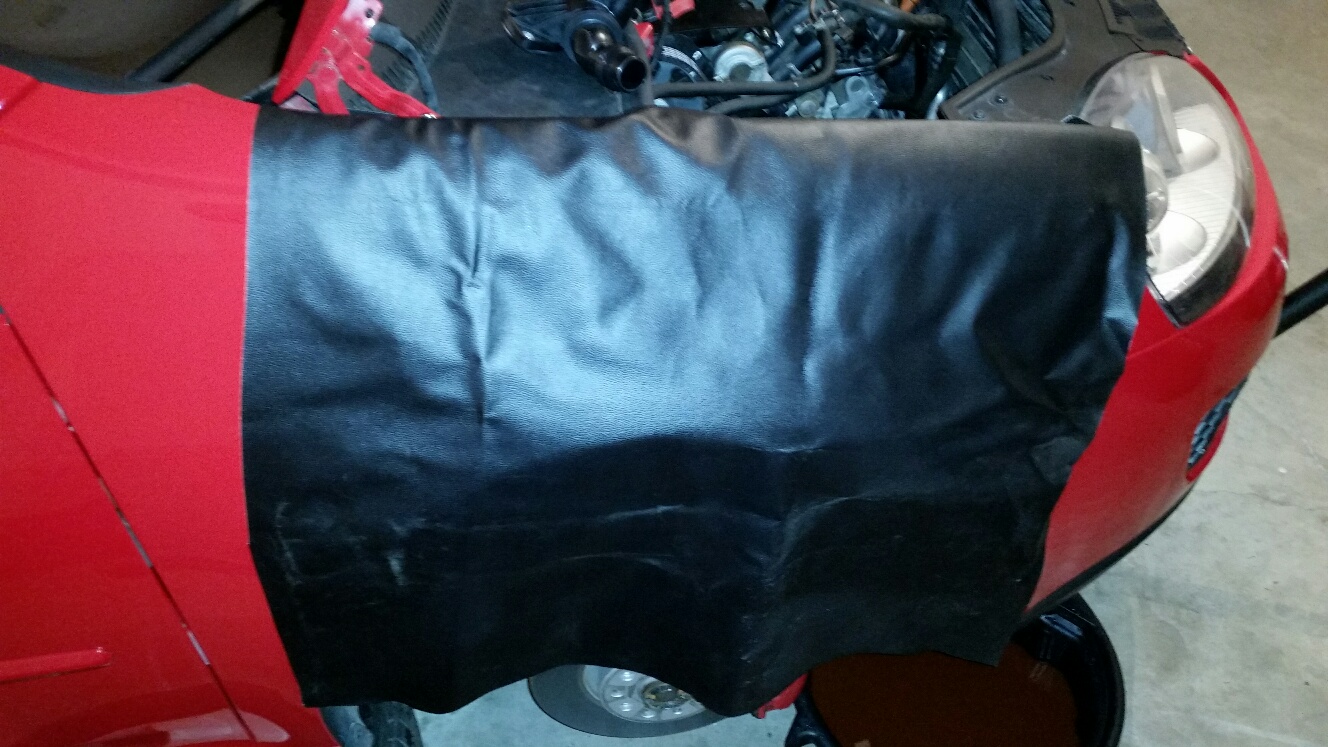

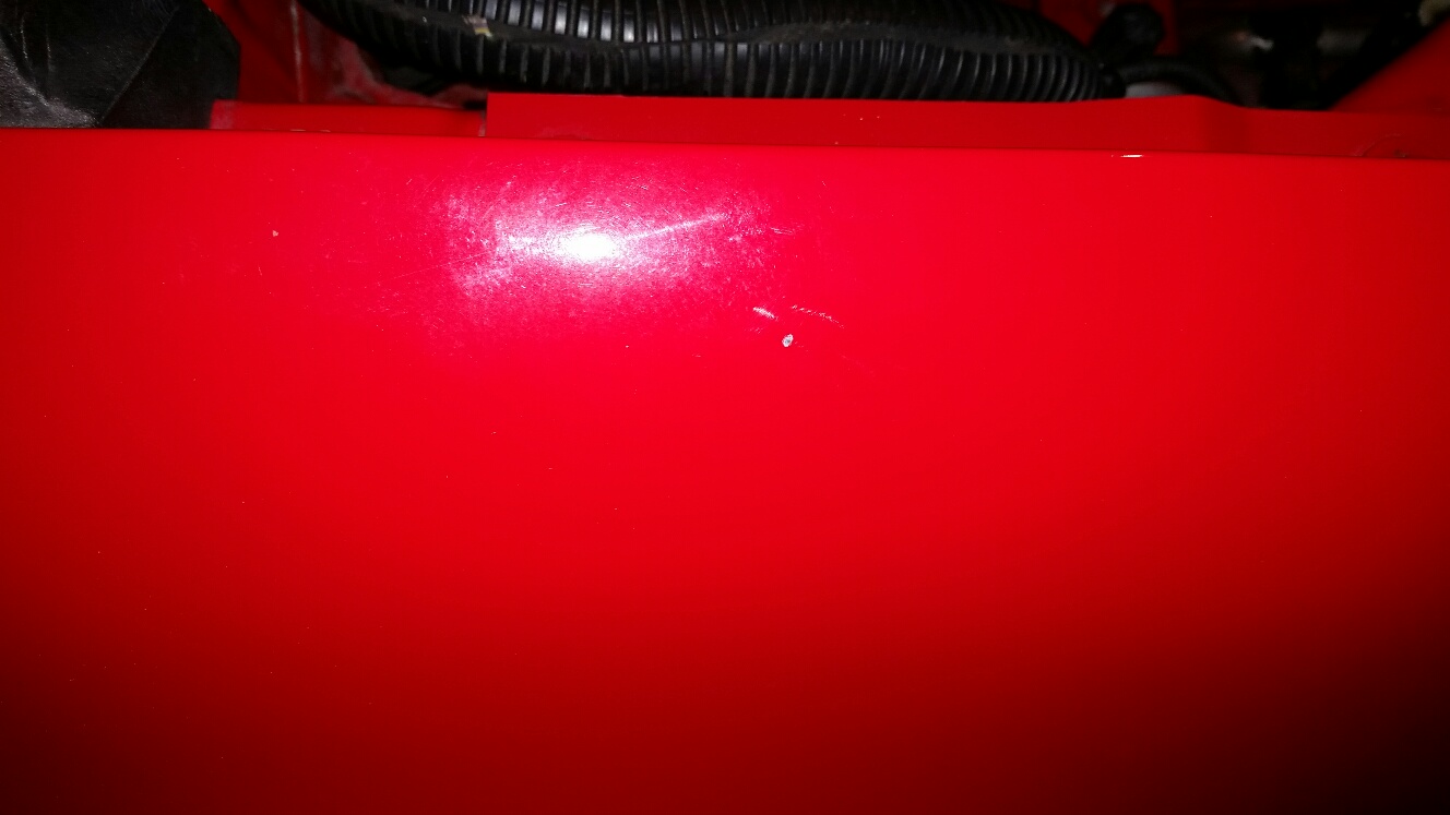

Thanks again for all you help guys. No way i could get through these DIY's without a bit of help.
Pretty gutted with my self chipped the wing.  :sad1:
Bit late now but bodged a fix with some leatherette from the boot build and some magnets left over from my numberplate.

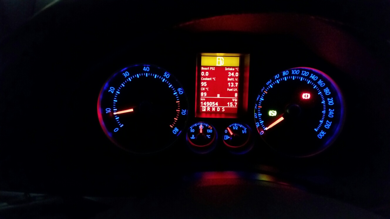

Cant believe its all done.
Only having one inline stat had me stumped for a while considering its DSG.
I really enjoyed the cam belt part of the job everything went to plan. The thermostat was a bit of a PITA.
The car is warming up nicely needle hit 90 quicker than ever. Polar is showing 90º to 95º.
