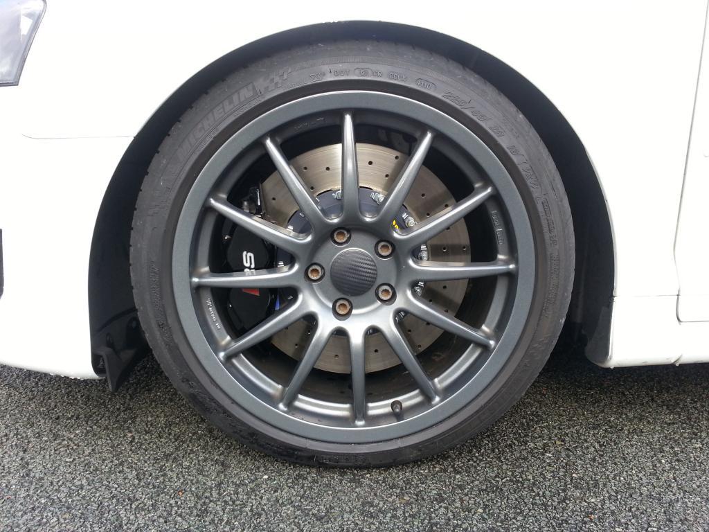

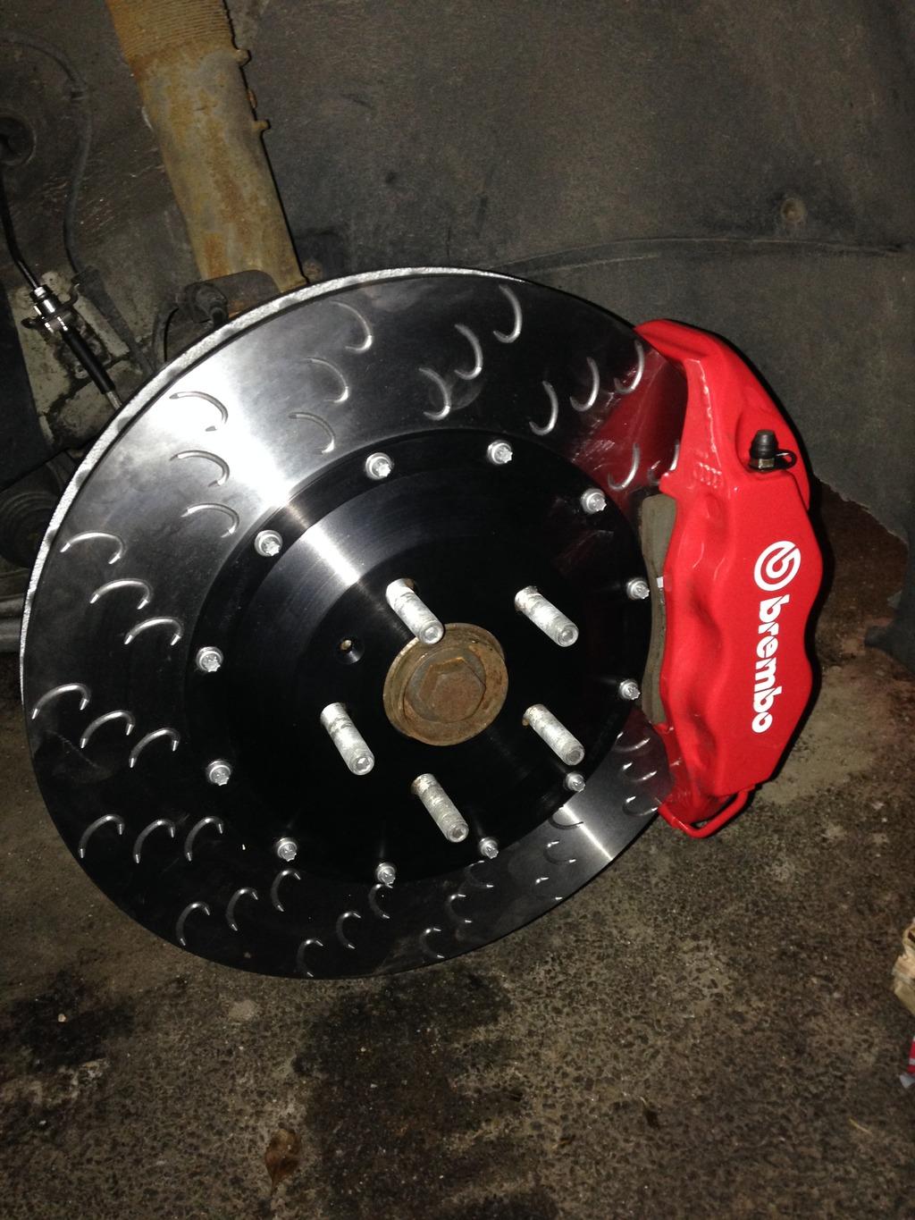

340/345mm is probably the most cost effective.
But if you are happy to spend out then you could get the DaveB 362mm floating setup.
Or Eddie A on here has a custom made 370mm floating setup from Reyland...
Not sure about prices on the floaters though!
