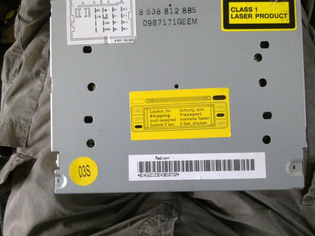

The transport lock is probably on!
It tells you on the unit itself how to disable the transport lock, there's 3 buttons you nees to press at the same time:
The eject button, the bottom button on the bank of 3 on the left and the middle button on the bank of 3 on the right. Hold these down for 5 seconds.
