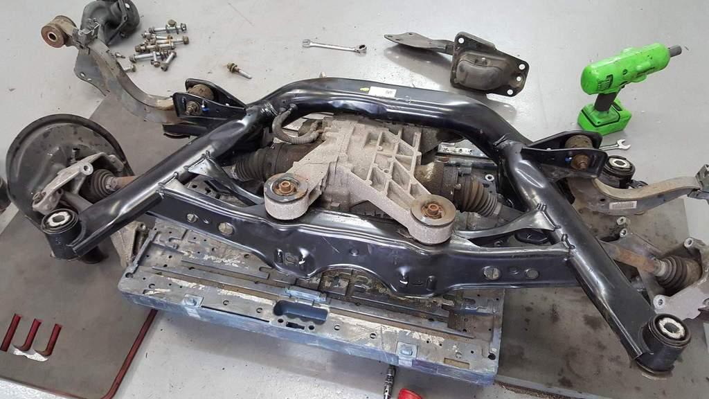

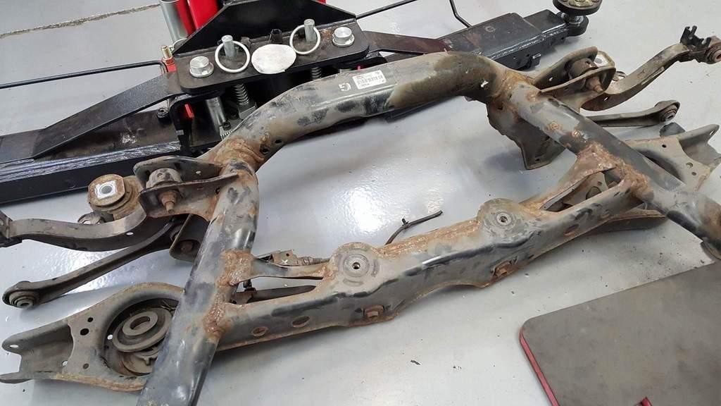

The original rear subframe was looking a little worse for wear so was replaced by a much newer one before adding all the Haldex goodies.

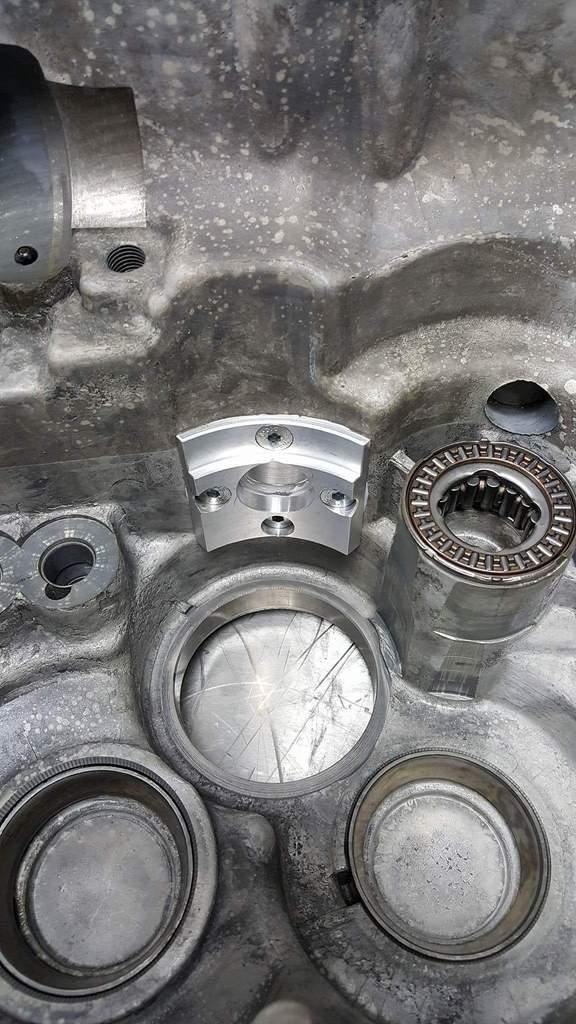

I wanted the new AWD box to be bulletproof so it was fully stripped and rebuilt adding strengthening mods such as stronger shift forks and the input shaft mod. As I previously had a Quaiffe LSD I wanted to keep one in this new box, this time I chose the Peloquins High Torque option.
