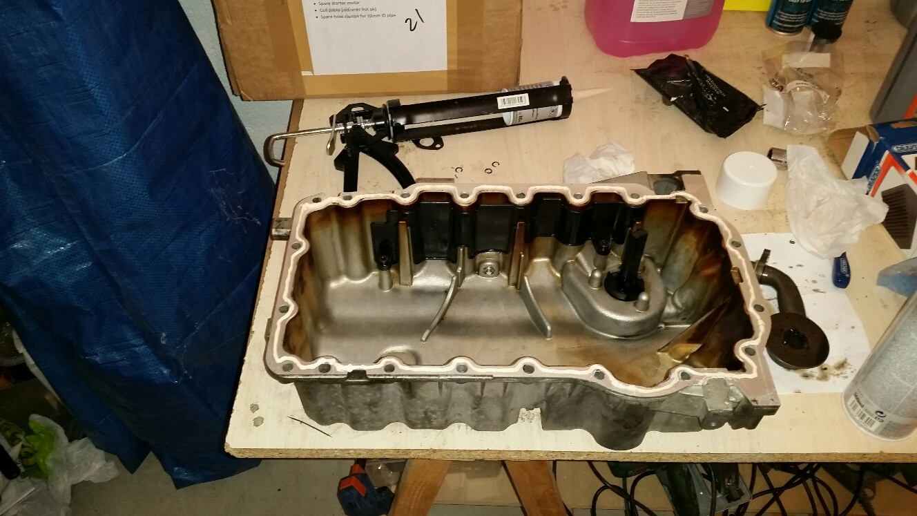

Magnetic sump plug installed.
New pickup pipe in.
My arms were a bit numb after 6 test fits of the sump. I managed to get a thinner line as i went on.
Sump is in bolts torque to 15nm??
When my arms recover i will finish it off.

Went for a quick spin. No leaks at the moment.
Thanks for all your help guys. Onto the cam belt now.
