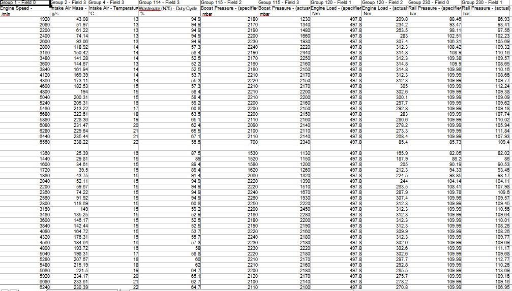

I found these from a Bluefin stage 1 Edition 30. They may be of some use.

looks like you need to get superchips to send you another map. Looking at hedges post, actual and requested boost levels are completely differnt at the same revs, by some way on yours Subaru.
