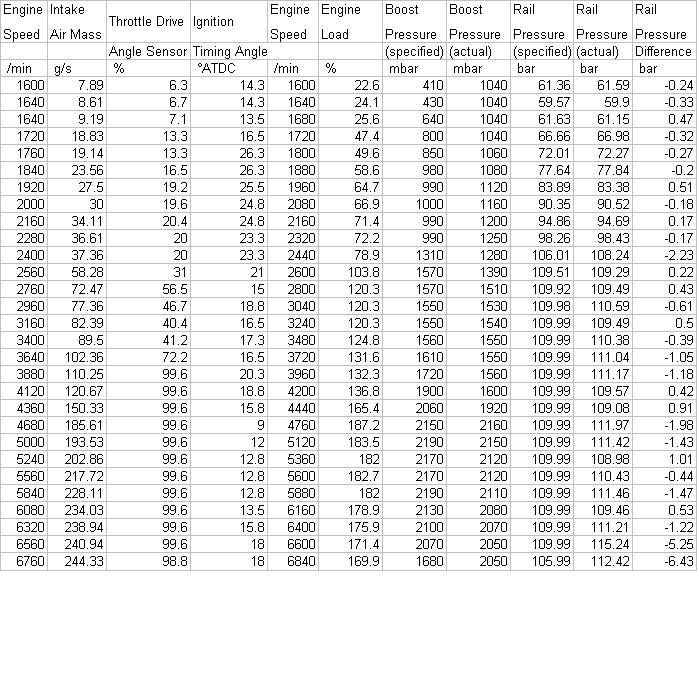

next lot of logs being put up here now.

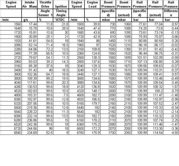

Offline Janner_Sy
  • -Receive: 113
  • Posts: 5392
Re: New car on Tuesday ....Cited !
« Reply #151 on: December 14, 2009, 09:00:39 pm »
heres his second run logs very much similar
Offline john_o
  • -Given: 136
  • -Receive: 108
  • Posts: 2946
    • My Car Blog
« Reply #152 on: December 14, 2009, 10:15:03 pm »
same ish profile , up , down , then back up again on throttle angle sensor ......
have you tried logging in a higher gear e.g. 6th ?
have you checked for fault codes?
have you done a throttle body reset?
but my first suggestion....
flash it back to stock and log again to see if you get the correct 99.6% at point of WOT.....
« Last Edit: December 14, 2009, 10:16:55 pm by john_o »

Offline Janner_Sy
  • -Receive: 113
  • Posts: 5392
« Reply #153 on: December 14, 2009, 10:40:58 pm »
logging in 6th on public roads, prob wouldnt reccomend that. whats 1500rpm in 6th about 35mph @ a guess id say if you pull that through the rev range your in some seriously  high spped, and you aint going to have much road to pull that off.
3rd and 4th gear all the way.
Good advice though to takethe bluefin off and see how it is without that.  Ddefinately worth the try.
But the thing is though, his throttle angle does hit 99% after 3800rpm, which surely means it is working, and does function, but something in his ecu or map is not telling it to open up all the way below that?
Offline john_o
  • -Given: 136
  • -Receive: 108
  • Posts: 2946
    • My Car Blog
« Reply #154 on: December 14, 2009, 11:03:36 pm »
lol wasn't suggesting full run in sixth. Just enough to prove full throttle below 3800.  sounds like its the low power bf map to protect the dsg box maybe? Stock mode is good start. Or take it to a respected vw special list
  You close to Jkm?
Red ED35 5dr DSG
BLOG | BUILD
Offline djhorace
  • Posts: 459
« Reply #155 on: December 15, 2009, 07:38:52 am »
  You close to Jkm?
Nope - About as far away in the UK as you could be from them lol
Offline john_o
  • -Given: 136
  • -Receive: 108
  • Posts: 2946
    • My Car Blog
« Reply #156 on: December 15, 2009, 08:02:46 am »
ah ok  :signLOL:
check for codes then
flash to stock to get the 'default' behaviour for the throttle % and take it from there.....
(with further logging in std mode for N75 and angle delays)
and then try ESP off when logging in BF mode
Dont thrash the car silly until you can ascertain why its not running right (enough to log only)
there are 2 sensors so if you log both they should add to 99.6%
remember you can try this with the engine off
[edited : whilst not related to your issue ,  this post
http://www.golfmkv.com/forums/showthread.php?t=82165
confirms that 99.6% is the value you should be seeing if everything was ok for 'one of the bluefin' maps, this fits with the other tuners maps Ive seen logs for.
It also looks like the signal gets modulated when issues occur.]
« Last Edit: December 15, 2009, 08:46:11 am by john_o »

Offline subaru26675
  • Posts: 237
« Reply #157 on: December 15, 2009, 11:34:13 am »
Right, first of all a BIG thanks to you guys for spending the time to plot up the graphs and tables etc, really appreciate your time in looking into my fault and cant thank you lot enough  :notworthy:   I am on nightshift mode just now so sorry if it looks like i am not replying enough to your posts  :ashamed:.
I am just of the phone to the lad in Aberdeen with the VAGCOM and i will not be able to do the standard run until tomorrow. Should i just do the run with the same logging paramaters or is there anything else that needs to be logged ?
The car is in standard form just now and ready to be tested.  Really am a bit depressed just now, the car only being 18 months old, i expected just to plug in the SC map and be away with no problems whatsoever, however on the other hand i am on a steep learning curve on the VAGCOM diagnostics and have met DJHorace through this,  so its not all bad. DJHorace (Allen) has been the most helpful guy i think i have ever met, nothing seems to be a problem for meeting up, he gave up his friday night at the drop of a hat to do some logging on my car and has spent some time making enquiries for me...absolute gent !  :drinking:

« Reply #158 on: December 15, 2009, 12:01:36 pm »
Log the N75 Duty Cycle.
You can log up to 12 with advanced measuring blocks if need be.
Offline john_o
  • -Given: 136
  • -Receive: 108
  • Posts: 2946
    • My Car Blog
« Reply #159 on: December 15, 2009, 12:24:06 pm »
tis what forums are for  :happy2:
im not expert btw just a keen forum member.
you are looking to prove your car behaves correctly on the std map :
i.e.  99.6% throttle at WOT from point of run (1500 rpm ?) , boost spool early to peak at 3k rpm ish , N75 duty cycle common profile.
good luck
Red ED35 5dr DSG
BLOG | BUILD
Offline Janner_Sy
  • -Receive: 113
  • Posts: 5392
« Reply #160 on: December 15, 2009, 12:30:50 pm »
you need to do those logs on both maps though.
hopefully it performs fine on the standard map, if so then you can give it too superchips to sort out, and you wont hve to replace anything on your car.
anyone know what blocks they are that he needs to log?
« Reply #161 on: December 15, 2009, 12:36:29 pm »
Try here in the VCDS section.
http://www.mk5golfgti.co.uk/forum/index.php?topic=5026.0
Does the OP know it is possible to log on the Bluefin handset?
Offline Janner_Sy
  • -Receive: 113
  • Posts: 5392
« Reply #162 on: December 15, 2009, 01:12:25 pm »
cool, didint know that. presuming that is part of the new software on the handset. mine was the old software and couldnt read DTCs
Offline djhorace
  • Posts: 459
« Reply #163 on: December 17, 2009, 03:31:02 pm »
OK - Car was logged just now in mapped and standard mode logging 003 114 and 115 & 003 114 and 230
Throttle seems to be perfect in standard mode . Logs below. Again, if someone can tell me how to post these properly, it would be appreciated
