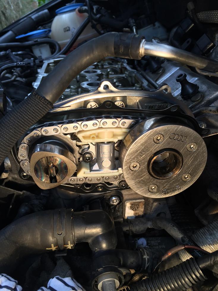

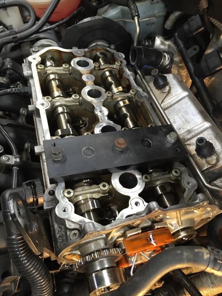

Got it done in approx 5 hours.  Removing the Cam adjuster bolt was the only butt clenching moment, but it cracked off nicely.
The weird thing is it all looked fine!  I nearly didn't bother but then I thought feck it, I've bought the bits so why not.
I was impressed by the condition of my engine at 100K.  It's a BYD lump.  It's clearly been looked after before I bought it and I change the oil every 5K with Mobil 1 ESP 5W/30.
Barely any staining at all and the tensioner is hardly touched either.
Although mine wasn't mega noisy at idle, I'm glad I did it as there's a fair bit of chain droop at TDC compared to a new chain.
New chain and the droop is a lot less.  Car is quieter at idle now which is a bonus.  I caught it early I think!
Those running a Loba HPFP, you might wanna change your follower more frequently than usual.  It's starting to go after only 20K miles.  Must be the stronger spring in the pump I reckon?
The only 2 things I'd recommend, based on my experience, is use the VW tools and torque wrench or a very rigid breaker bar to remove the cam adjuster bolt, otherwise it's all straight forward. Add a vacuum pump O ring to the parts list as well because it's a lot easier with that out of the way.

The vacuum pump seals to the chain cover with an O ring.  I found the bottom chain cover bolt is easier to get at with the vacuum pump removed.
Yeah my old tensioner seeped oil when I pushed it down Pesky mate.
Just been out for a 50 odd mile shake down and it drives and idles soooooo much better.  I guess it was all worn out more than it looked.

Excellent pics pudding. You got a part number for this o ring?
Is that a gen. Cam locker?
Cheers.  Impressive pics for a phone!  I remember paying £1000s in SLR to get that image quality 20 years ago!!
Anyway, I didn't change the O ring mate as I didn't plan on removing the vacuum pump, so didn't get one in.   As it turned out, the O ring was still springy and sealed up OK.  The only gasket that had gone hard was the rocker one.  I just put that in there as a recommendation for others.  I would have replaced it if I had one!
Yeah that's a genuine locker  :happy2:
