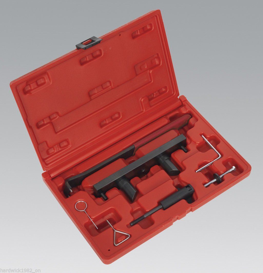

The job isn't difficult but I warn anyone thinking of doing this you need both tooling T40080 and T10252 items to be quality products as the bolt holding the chain adjuster on is "tight" and cheap tooling will result in another wise very doable DIY repair turning into a nightmare!

I had access to the genuine tools over the weekend but that adjuster bolt is F***ing tight and you need that socket a locking tool to do the business!

I know of one person who used a Laser locking tool and the locking pins just bent apart when undoing the adjuster bolt!
I also know of one person who used a Proto tool (Poly-head 10 socket) that just twisted and delayed the job by a day until TPS got him the correct socket!

The sealey locking tool seems ok. It's been used a couple of times now.
