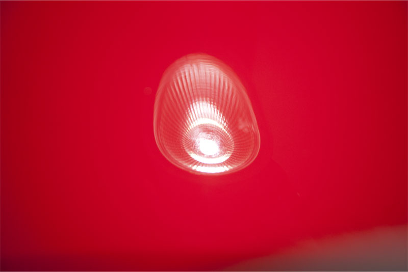

Any tips for dealing with this? Most of it has polished out just left with a fine line.

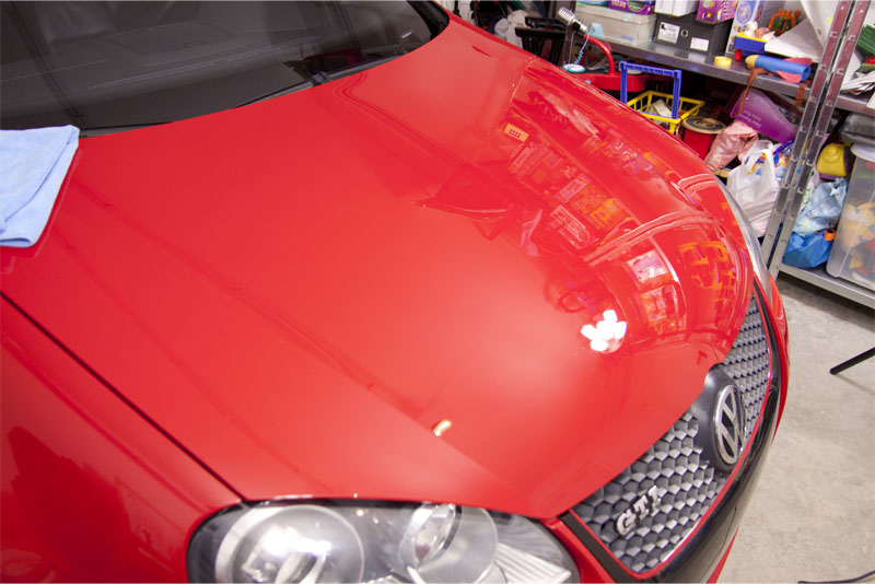

Very hard to see. TBH the paint looks very blotchy and hazy. But I think your referring to the scratch to the left of the main light source. Without knowing the paint depth I wouldn't advise chasing it. If there is good paint depth then I'd use a 3" spot will pad to focus the polishing on that area and then go over again with the 5.5" pad to refine it down.

Hopefully the paint looked terrible due to having not cleaned it for over a month. Which made me notice the scratch straight away as there was a clean swipe across the bonnet.
How the bonnet is at the moment. I can still find the scratch with a lamp but could not pick it up in a photo. The paint depth around the scratch is 113-128. I have some 3 inch pads but will they do much on the das6?
A close up of the wing i have just finished. Cant find any swirls but there are a couple of fine scratches will probably leave these as if i try and get everything out i will be at it forever.
