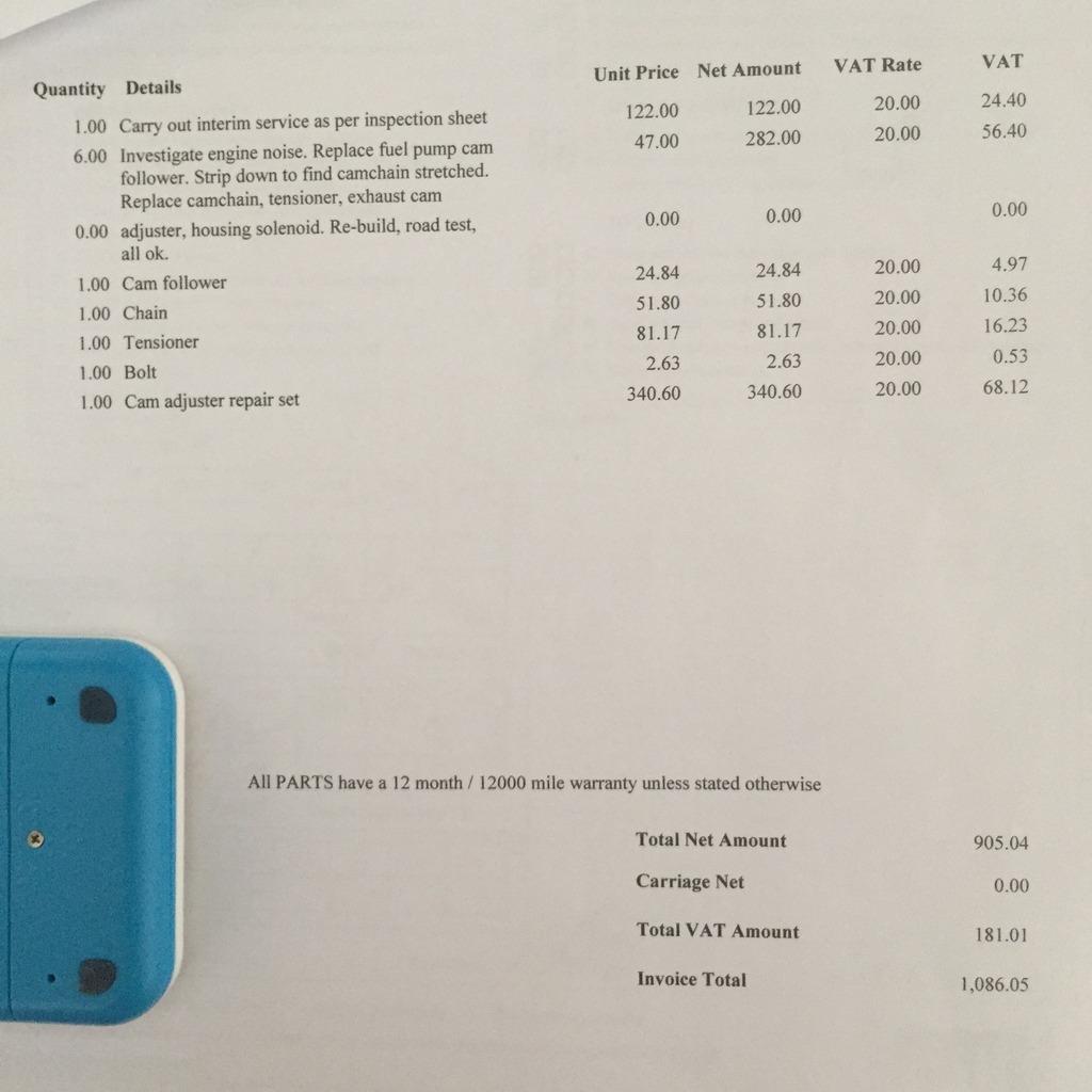

« Reply #47 on: June 29, 2015, 10:48:25 am »
I really didnt want to re-visit this invoice but here it is anyway. The morale of the story is dont drive it hard when its cold.
That invoice needs burning!  :signLOL: - Ouch...
The Cam Adjuster is a horrible price.

It does make sense to do the lot, I just think I wont be able to afford it! without the adjustor I still think it will be around 5-600.
