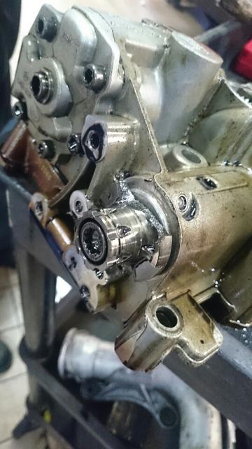

so last week after what seemed like a lifetime wait it went to my mate for a cam chain , variable timing unit and other bits needed to cure this its a revised part so you have to change the whole lot this came in at £670 part alone ,
this was changed cured the start up rattle but the hot running tappet noise was still there my mechanic traced the noise to the bottom left hand rear of the engine he'd already dropped the sump when doing the valve gear
when he looked for the noise he found this in the balance shaft unit

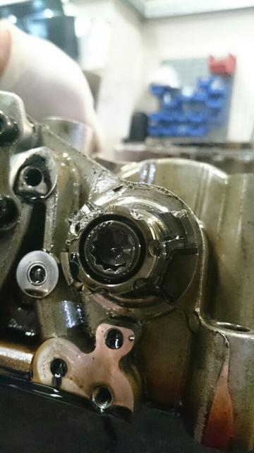

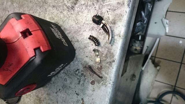

this is the balance shaft unit it also houses the oil pump , its driven by a chain from the front of the crank shaft
the sprocket drive is a damped type and was moving side to side and when removed look like this
the balancer shaft unit has no serviceable parts apart from the oil pump and is sold as a complete unit cost £1200 lucky my mate had a second hand unit that was good and is now on the car running quieter than its ever done

This is interesting. Did he find this in the sump or after removing the balance shaft unit?

After removing the balance unit it was where the balance lobes are the area in front of the gears in my pic , the sprocket drive is at the top of my pic so traveled a fair way

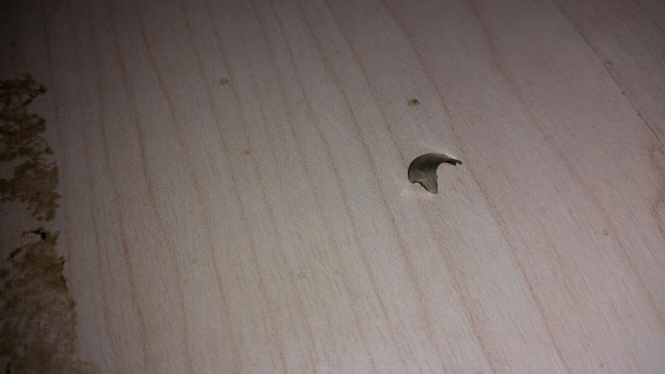

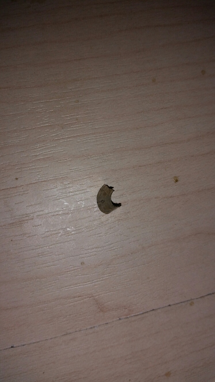

Could a piece of metal from here work its way down into the sump? I've changed my cam chain tension etc. But still think its too noisy (probably being paranoid).
This is what i found stuck in the pickup pipe.
05 | Tornado Red | DSG

Mine sounded look classic tap pets noise but from the bottom of the engine , if you drop the sump you should be able to check for side to side play in the sprocket its where the springs came from in my pic the metal bit are off the casting
