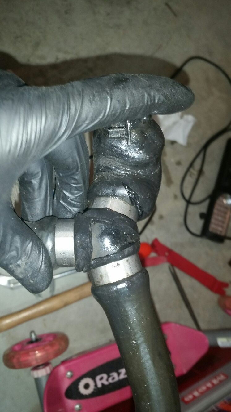

Done a bit of work on the beater recently changed the injector pump gasket as its been leaking for years.
Decided to change the thermostat as the gauge has never got above a quarter in the 5 years i've owned it.  :ashamed:
After changing the thermostat there was a leak when the needle got to 90 so i replaced the thermostat o ring again  :rolleye: (should have more faith in my diy skills.)

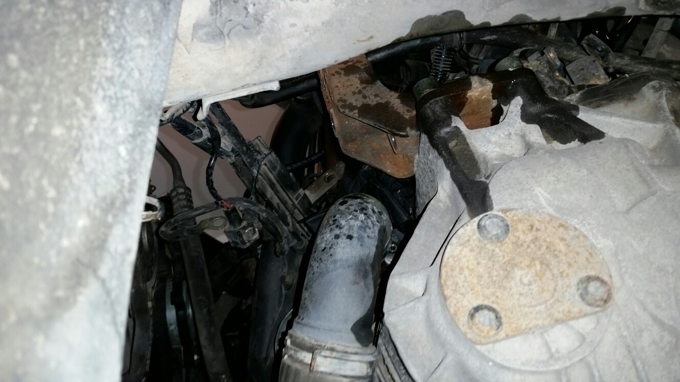

Then i found this.
I've also changed the temp sensor. The car is warming up now but the needle floats above the half way mark. VCDC shows a temp of 92.7ยบ. Is it normal on older cars for the temp needle not to stay put?

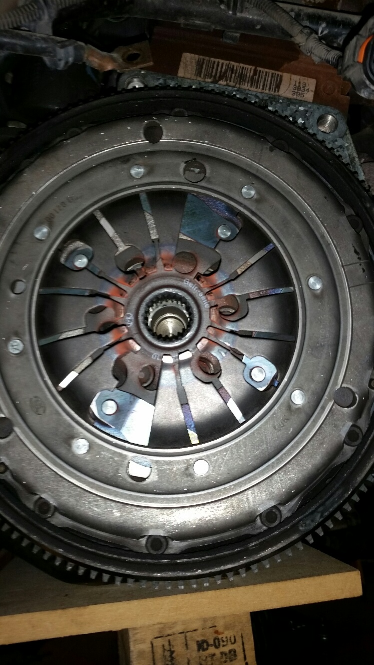

Just received the luk dmf and clutch kit. Its preassembled  :rolleye:
I was expecting to mount the dmf then use a centring tool to put the clutch plate and pressure plate in. Im  :confused:

How are you going to bolt the flywheel on with it all assembled like that?
The bolts are already in there and the fingers have holes where the bolts are.
I've made a start its not easy as i have no idea what i'm doing. More info is available on the mk2.

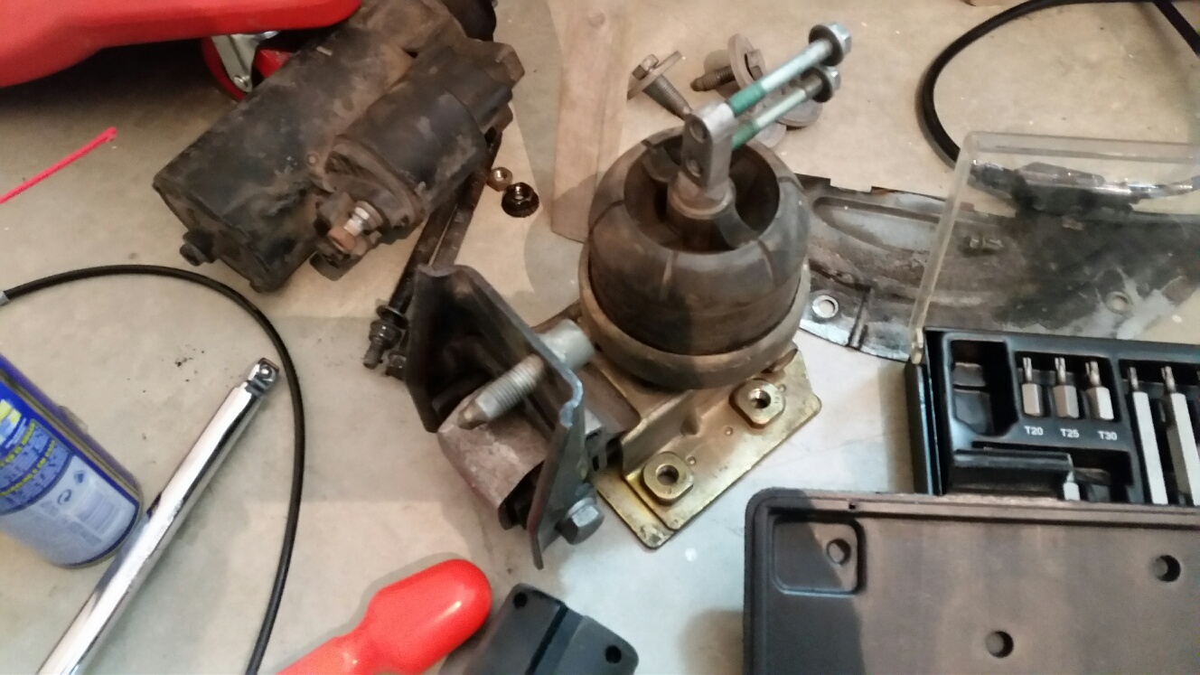

Gearbox mount was a pita to remove.
As its suspended from a plate beneath the battery tray.

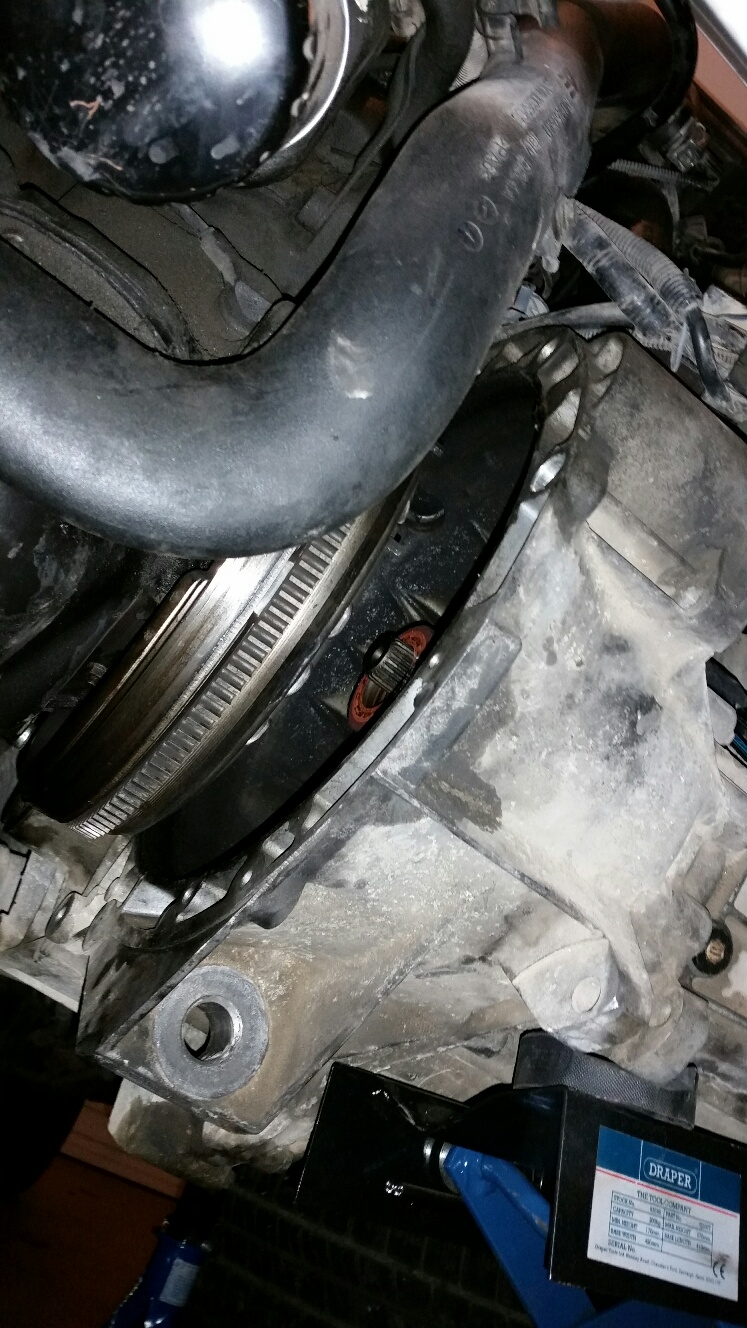

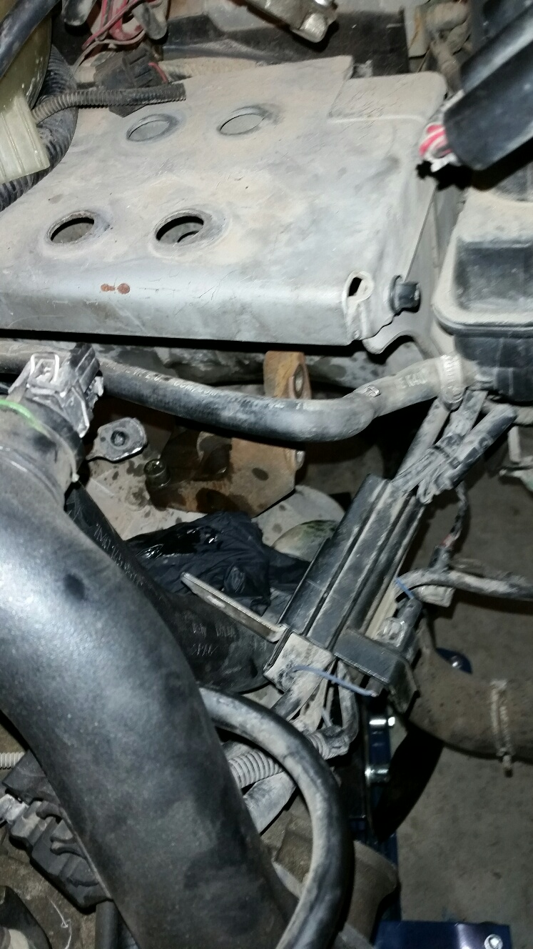

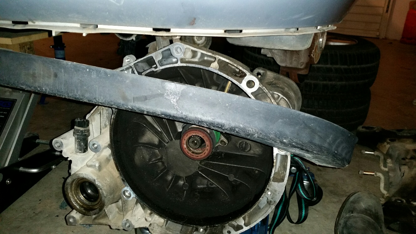

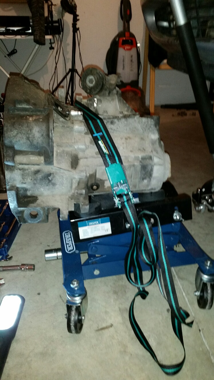

« Reply #39 on: February 04, 2016, 08:13:03 pm »
Well happy. I was pussyfooting along with this as i thought i would struggle getting the box out on my own.
That does not look good.
Couldnt help but take a few more pics. Beer o'clock.

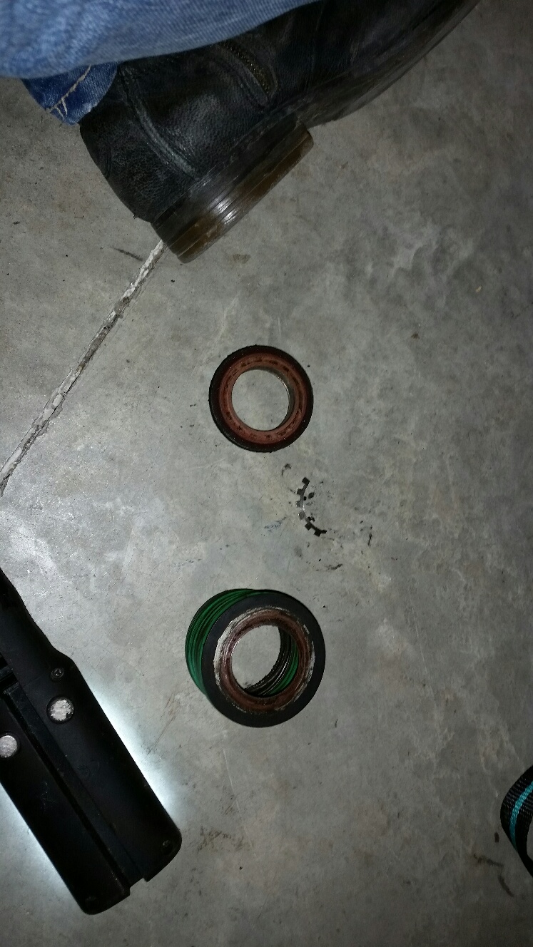

Re: Brakes on the Beater. Seat Alhambra 98
« Reply #40 on: February 04, 2016, 08:26:19 pm »
Well done as always Dazza on your DIY skills and your fearless attitude  :happy2:
Refitting will be a bitch and will take two people cause on your own it would be easier wining the lottery.
The slave seal may need protecting or the little rubber oring could go missing if it's the type I'm thinking also bleeding of the slave should be kept in mind before refitting everything as new items can come faulty.

« Reply #41 on: February 04, 2016, 09:14:08 pm »
Thanks mate!
The luk kit says to throw the oring and use loctite 5980??
I will have to try and get it in on my own now.  :stupid: A mate has offered to help when i fail.
I suppose i could connect and bleed it when its still on the jack??
« Reply #42 on: February 06, 2016, 07:33:15 pm »
Gearbox is in, managed it on my own in the end. I'm fooked now will sort the gearbox mount tomorrow.
05 | Tornado Red | DSG
