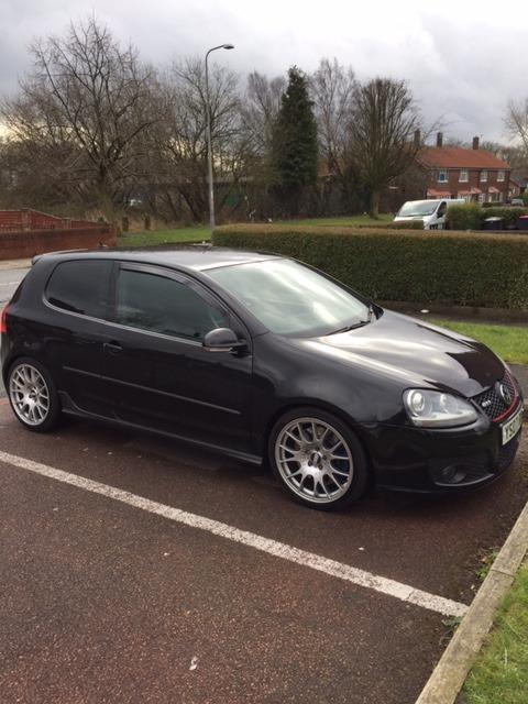

Here's mine on 30mm H&R springs, perfect height I think, low enough to look good but high enough to make it over most speed bumps. :driver:
