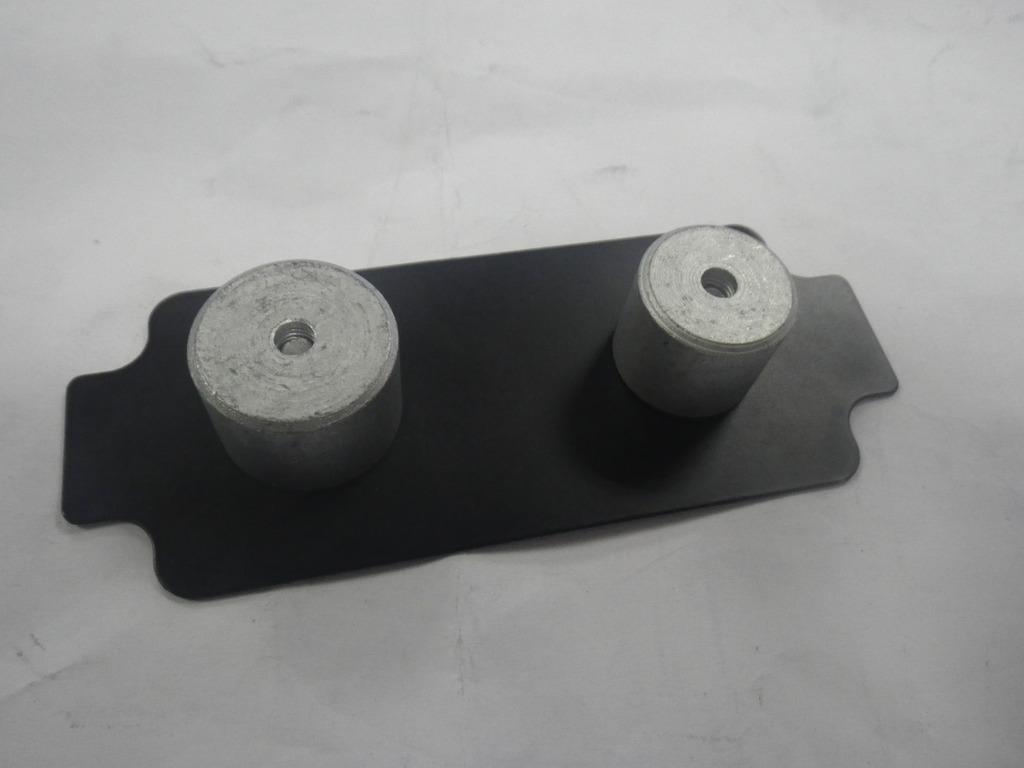

Hello, I have just taken delivery of some 986 Pagid pads from Eurocarparts along with some 36/40mm anti rattle shims which fit into the respective Pistons.
The pads already have standard Pagid dampers adhered to the back of each pad so do I pull these off to fix the Porsche ones on or just stick the Porsche dampers / anti-rattle shims over the top??

« Reply #4 on: June 12, 2015, 01:24:01 pm »
Thanks for your replies bacillus, please see imgaes below:
As you can see the pads have a standard looking vibration / damper / shim thing attached, do I pull this off?
Also see above a picture of the Porsche shim with a adhesive backing.
Regards,
Mike.
« Last Edit: June 12, 2015, 03:00:39 pm by AIR_CHILLED »

« Reply #5 on: June 12, 2015, 08:04:21 pm »
Hmm, if you could cleanly remove that anti-squeal/rattle pad then I would do so. As you can tell the boxster anti-rattle shim needs a flat and clean surface to adhere to and I suspect that just sticking it on to those pads (as is), will make the fitting too thick with a 25mm disc.

I would leave that pad as is.... and just put the shim ontop!

Hi, fitted these brakes today and with the Pistons pushed back fully there was enough clearance to fit the pads as is.
Porsche shims were smeared with Pagid Cera-tec grease then fitted into the caliper Pistons before bolting them to the adaptors.
No brake squeal or vibration whatsoever.
