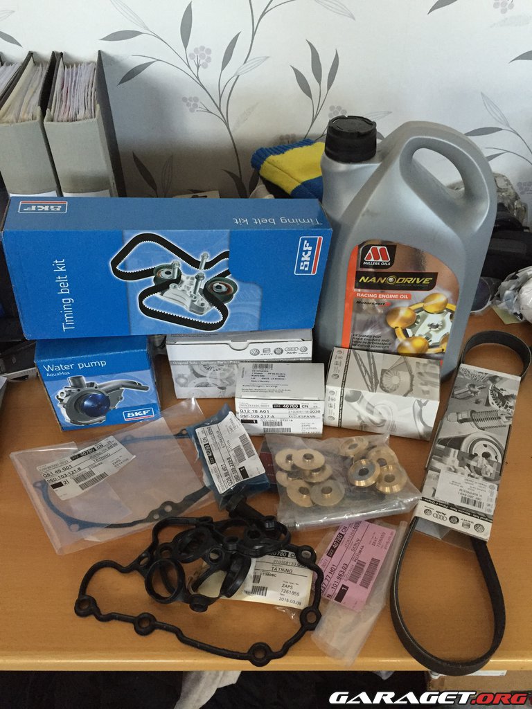

Had this knocking myself when taking off ond stopping one knoch could be heard! Went for the big solution straight away because i read that the VW spacer kit not always worked...
This is the sh*t!:
http://www.tyrolsport.com/suspension/chassis/tyrolsport-deadset-rigid-subframe-collar-kit-for-all-mk5/6-jetta-gli-and-mk2-audi-tt/
