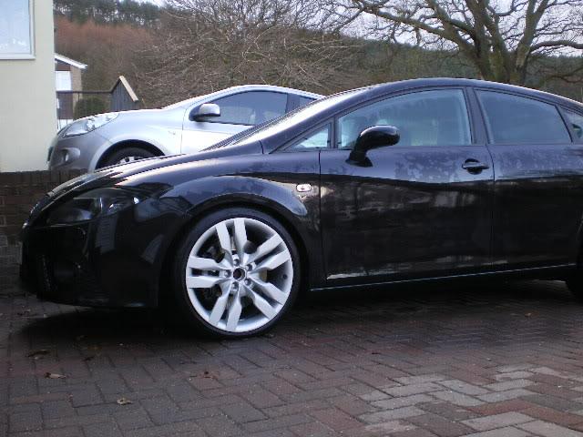

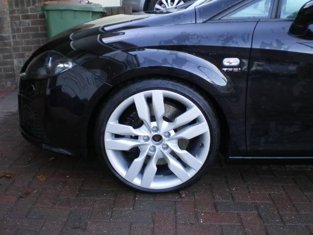

« Reply #9 on: February 10, 2010, 12:57:31 pm »
Thaks for the input guys
I went for the 235 35 19 Michelin PS2's
There is a slight stretch but nothing major.
The ride is also very good which surprised me. The sidewalls of the PS2's are really soft so will have to be carefull of the potholes
Am really happy with the wheels so i thought I'd put a picture up
This is with a 10mm spacer to clear the front struts
Have just ordered some 6mm spacers so they sit a little more snugly in the arches, the 10mm's can then go on the back
Thanks again :happy2:

Nice, looks good on the Seat   :congrats:
Over the top mod list ;o)
Re: 9Jx19 ET52 - What width of tyres?
« Reply #11 on: February 10, 2010, 01:37:28 pm »
They look the Bollox Jon!  :drool:
