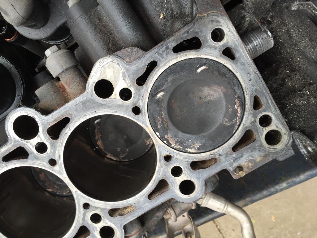

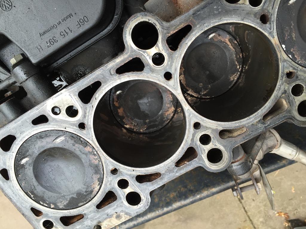

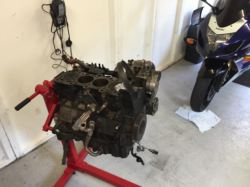

Thanks for the snappy reply earlier. Went and looked at the engine, not much I could check so just gave it a few turns over and it all felt fine.
Took the risk and bought it as I couldn't leave it at the price he wanted for it.
Anyway got it home and took the head off straight away.
And it's all fine, couldn't be happier!
