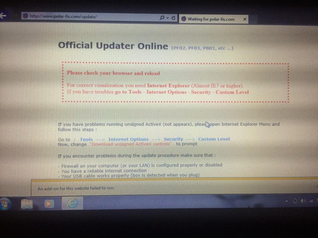

Yep using internet explorer 11. Have change the activex settings and literally tried +10 times. Get a yellow box said failed to run.. Wonder if their system is down although doubt it. Just got my dad to try and he couldn't get it going on his either but he's even less computer literate than me  :laugh:

"Add on failed to run"

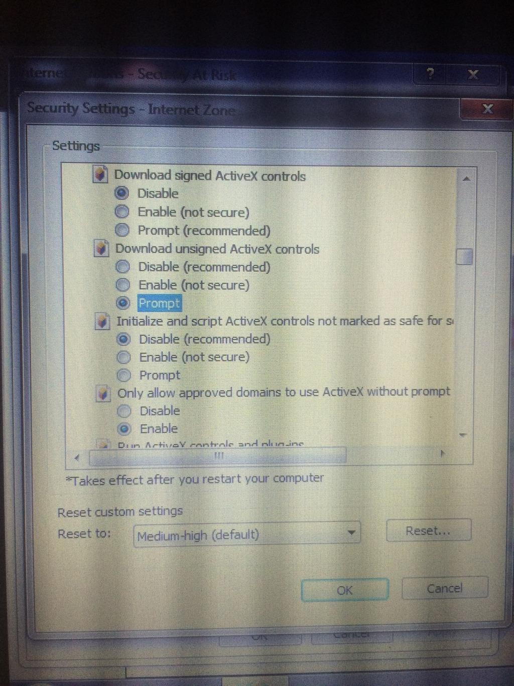

Don't think thats right. Did u change "download unsigned activex controls to prompt?

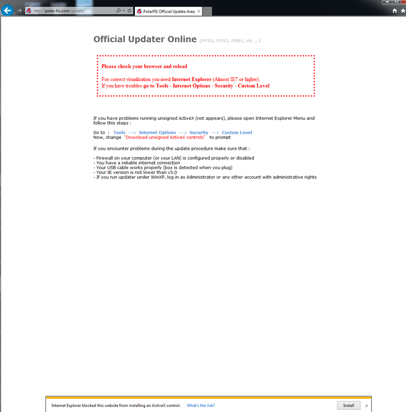

« Reply #8 on: June 29, 2015, 09:54:51 pm »
this is what u should see. I don't get the first popup.
05 | Tornado Red | DSG

Ok thanks bacillus, will put the laptop away for now as a little frustrated with it. Dazza these are my setting will try again in the morning thanks for the quick response guy  :happy2: :happy2:
