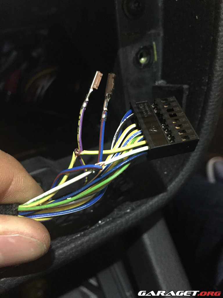

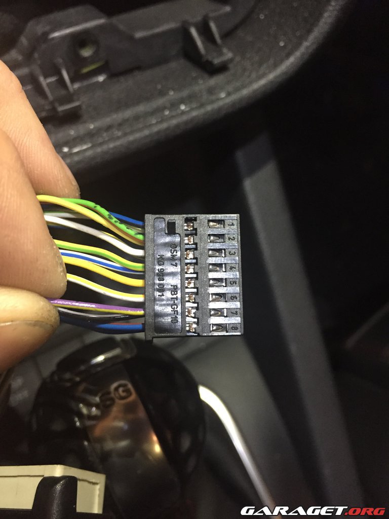

That problem i also had!!! To fix that you have to solder the two flaps in parrallel, this connector!
To this
Hope you can see the colours on the wires!!!
After that everything is ok!!!

Do you have vcds? Check the old can gateway in vcds and take pictures of everything! Then simply change the can gateway and check the same boxes that the old one had checked.
On the black connector (picture on my last post) you move 7 and 8 to ? And ? , don't remember the numbers but you can see the wire colours! That is for parrallel connecting the two vents so air could come front mid dashboard.
