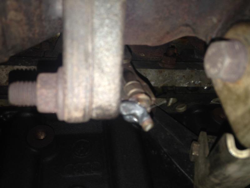

Crawled back under her today and found the fault
The actuator arm is broke in the middle and the part on the manifold is just hanging down :-(
There's some sort of blue stuff on it where it look like someone had put it back together in the past
What are my options? Can it be repaired?
I'll pop a pic up soon
Jay

« Reply #4 on: July 15, 2015, 07:46:45 pm »
And how mine looks :-(
Snapped just near the connector on the manifold
