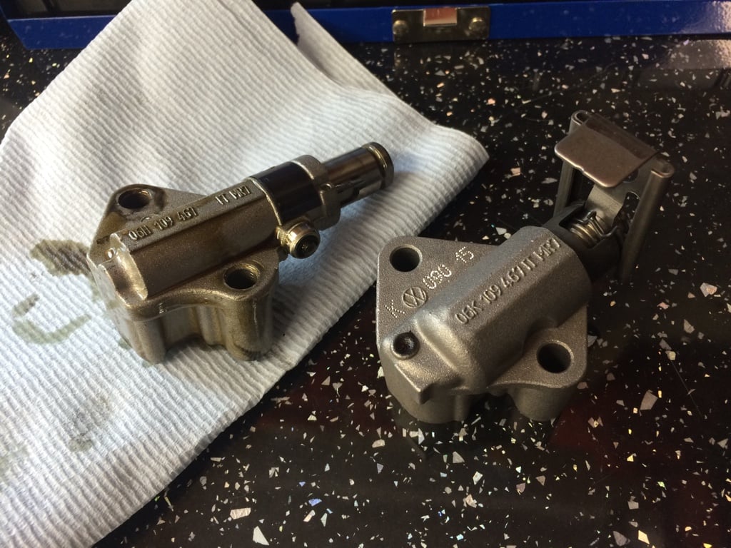

So, due to the fact the TSI has a very common problem with the timing chain tensioner ratchet failing and near on destroying the engine when it does- i thought it was a must to take preventative action to stop this from being a possibility!
New revised tensioner purchased from VW, which now cant fail like the old ratchet style ones could and did!

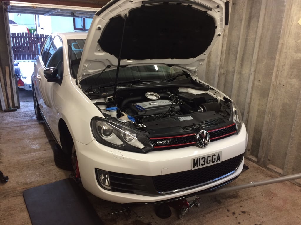

Went about fitting it tonight.
Old vs New Style;

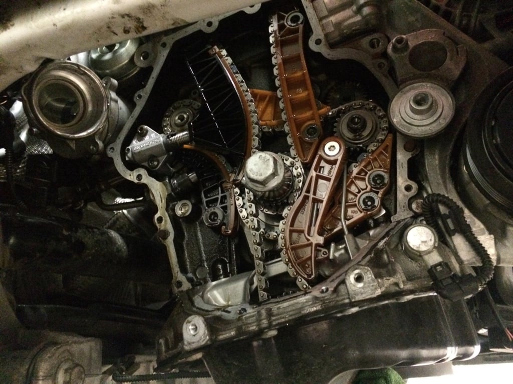

New tensioner fitted;
Now stuck until i get new lower chain cover ordered from VW as it needed some prying off so not happy putting that back on.

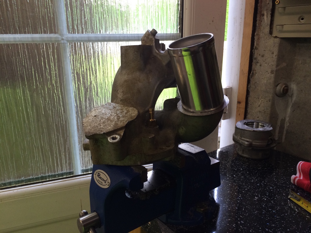

Been buying bits and cutting sh1t for the K04 conversion.

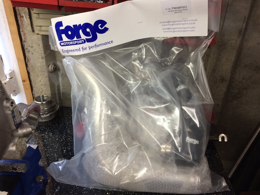

Bought Forge boost pipe kit to get rid of the restrictive pancake pipes and so i can fit a standard fitment silicone hose between turbo outlet and turbo outlet pipe.
Bought some other random silicone hoses so i have a selection when it comes to fitting to the turbo, and an alloy pipe to cut up to have welded to turbo outlet as silencer needs removed for fitting to the TSI.
Silencer cut off and alloy pipe cut to be welded on
After a wee wash this morning!
