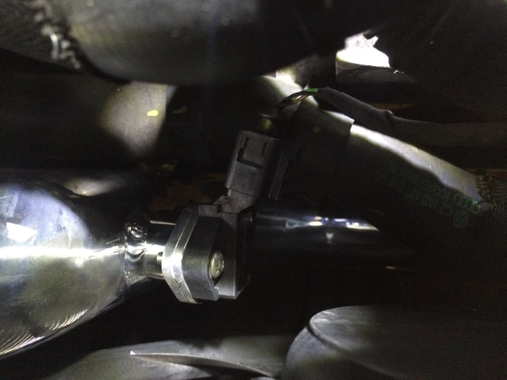

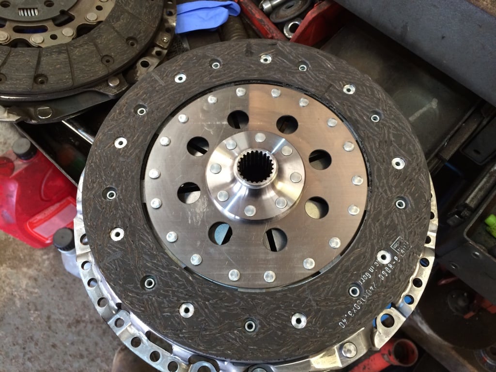

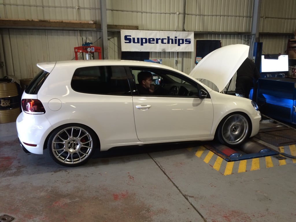

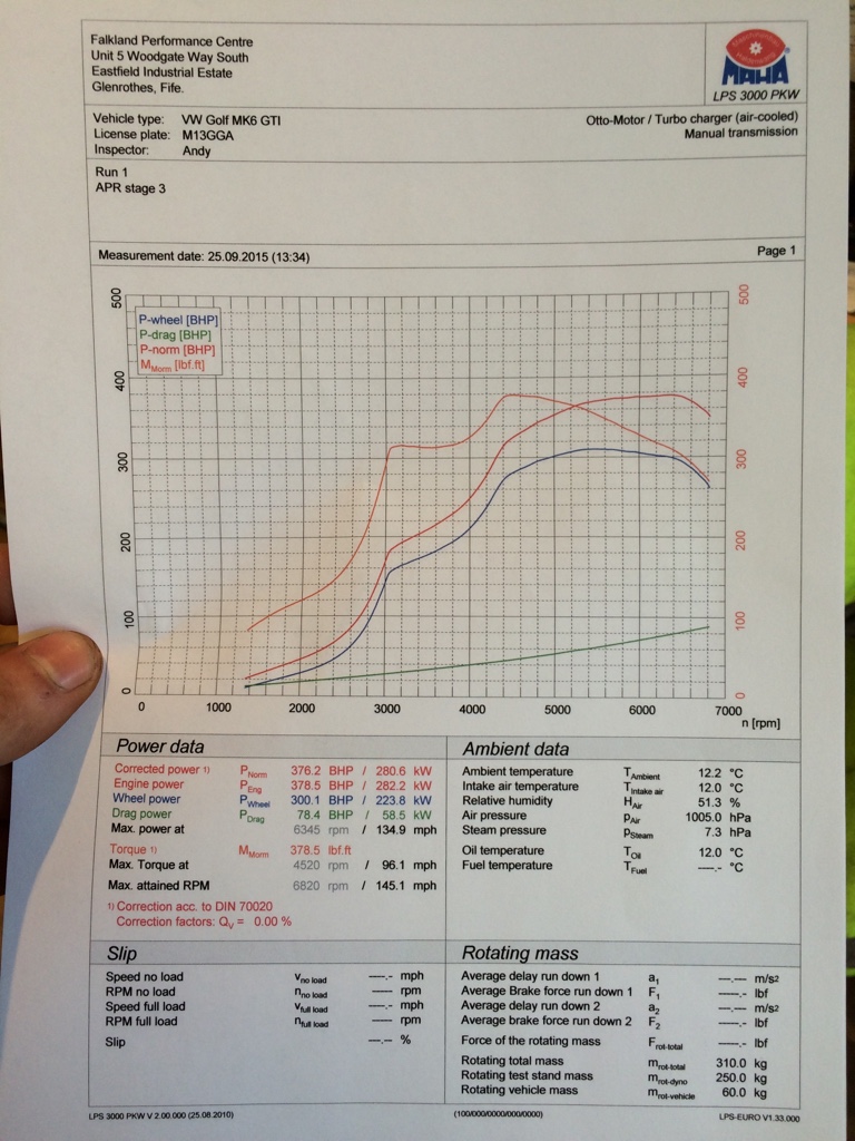

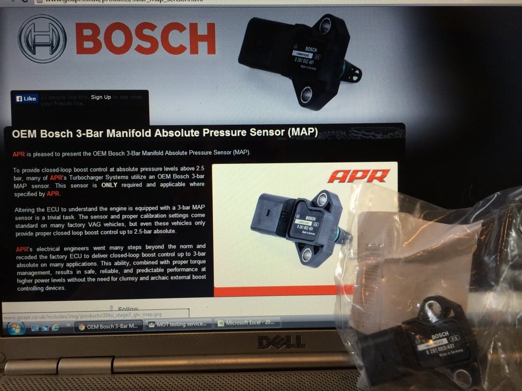

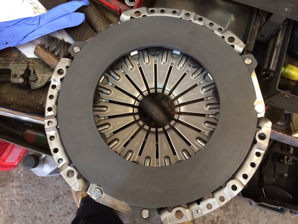

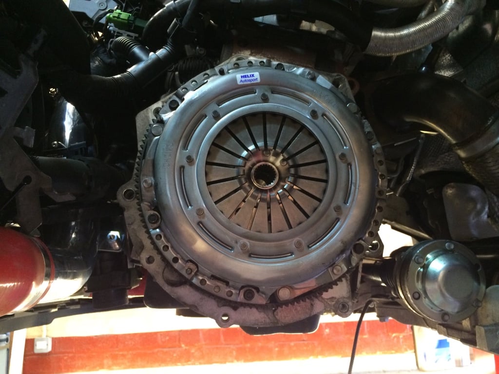

So, Helix clutch eventually arrived and fitted.
3 bar map sensor fitted and away for APR v3 stage 3 map.
Going like sh1t off a shovel so ran clutch in a little and got a power run done
376bhp and 380lbs/ft. :)

Reply #103 on:
September 25, 2015, 11:27:26 pm »
Thanks, Im happy to know what power figure its running for every time someone asks! Lol
Save me saying, not sure but should be 360bhp plus-ish!!
