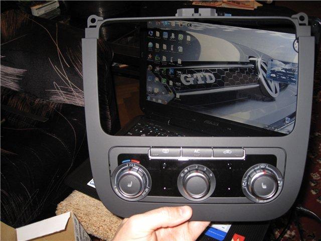

Alrightythere peeps
I have searched but not found info if I can change my aircon controls from Mk5
To Mk6 (without the heated seats)
Any help would be appreciated

You can't. Yours are mechanical and the mk6's are electronic.  :wink:
You'd need to change all the AC components, for which work is better to upgrade to automatic AC.

Not necessarily true. I've changed my MY07 Golf Plus climatronic to mk6 climatronic unit. Only thing I needed to do is to cut one pin and move it to another location. Of course Air quality sensor installation was needed as well but that I could do later, it did not affect the way climatronic works.
Here's a good thread about this :
http://forums.vwvortex.com/showthread.php?4938269-OEM-MKVI-Climatronic-on-a-MKV-on-a-RNS-510-Screen-installed
They discuss about climatronic but at later pages also Climatics are discussed and from what I recall, they state that it's basically plug'play for it.

If you look better you can see that the question asked was about a climatic panel (manual AC), not a climatronic panel (auto AC). :wink:
They're different as I said. So what you said is only valid for climatronic panels. I have the mk6 version in both my Golfs.

Yes, I noticed that :) I just don't get what are the differences?
Out of curiosity I looked at ELSA yesterday and made a quick comparison between MK5 climatic and MK6 climatic electrical connections, and I could not see any big differences. Only thing that might give issues as far as I know for sure, is the air recycling selection. Older MK5s have two flaps for the fresh air/interior air recycler selection and newer MK5s and all MK6s have only one.
But again, I did not do any deeper comparison, just looked that same bits and pieces are on both and both seem to have roughly the same connections.
Of course changing from Climatic to Climatronic is a big task as you need to do a lot of rewiring but you also need to install new flap motors, new air ducts and new vents.
EDIT :
Ahahaa, I looked at MY2007 onwards on MK5 and that looks pretty much the same. Older models are not, they have the mechanical shaft on air control flap. Newer ones seem to have electronic flap motor.

Yep...bought all the bits yo do this on my mk5.
The manual flap adjuster is the obvious difference but also I wasn't able to code aircon either.
Don't waste you time and money.

Not sure I misread downtime's post right about climatic. I have the manual controls but would prefer the 'manual' controls of the mk6.
For a minute I thought he'd cracked it with the part numbers... I guess not

Nope sorry. I was just looking at the electrical diagrams for mk5 climatic vs mk6 climatic. But as Marko wrote a couple of posts earlier it's not easy to do due to mechanical flap control.
