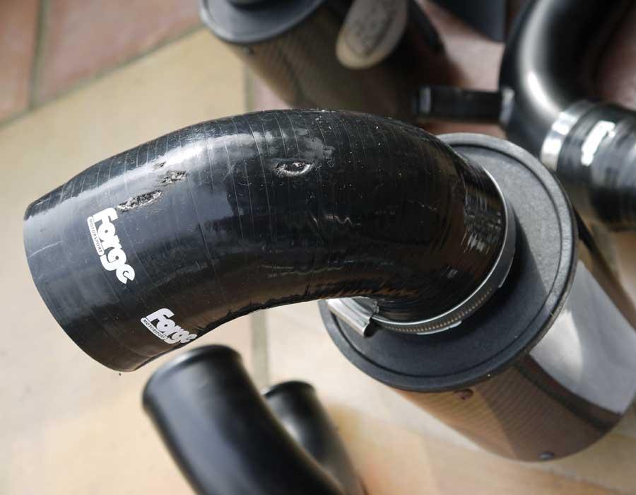

Just taken my TWINtake of and sold it, found this which was rubbing out of sight somewhere, not right through though.
Re: GTI Forge TWINtake air intake - Review....
« Reply #388 on: March 26, 2013, 12:43:39 am »
....So that appears to be against rubber piping on the engine side and is hidden from view by the front mounted filter cannister.

did notice the potential for this rubbing issue when installing my twintake and spent ages trying to adjust it out,  i never had an issue with it but the car was sold a few month later so i guess the above is the outcome.
