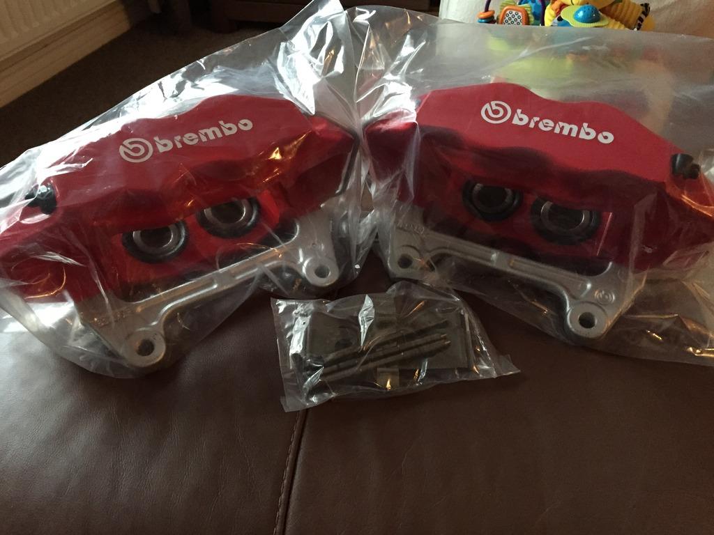

« Reply #27 on: August 22, 2015, 10:49:01 pm »
My shiney TTRS calipers waiting to be fitted
My Cupra front brakes will be for sale soon, coming off MY61 reg,25k mile Seat.
Looking forward to the improved stopping power
Did you get those referbed? If so.. Who by and how much did they charge? :)

« Reply #29 on: August 23, 2015, 07:54:06 am »
[/quote]
[/quote]
I bought them from a company on eBay who specialise in caliper refurbs, core supplies I think, I paid £350 delivered .They  are available in a range of colours and decals
