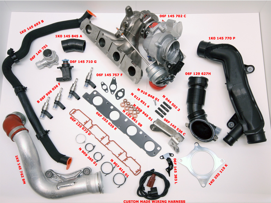

Have a look at R-Techs website, they have a guide.
http://r-techperformance.co.uk/axx-bwa-tfsi-k04-turbo-conversion/

Wow. That’s a lot of parts.

That’s very tempting indeed, there’s also reconditioned turbos on eBay for less, but I can I just pop that turbo in instead of the K03 or do I need to go and find all the other parts from that R-Teck picture,  as well? The guy from Autotune said to “make sure the turbo comes with DV etc” but I have no idea what the etc means. :grin:
He also said that I’ll need S3 injectors.
