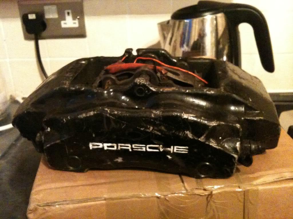

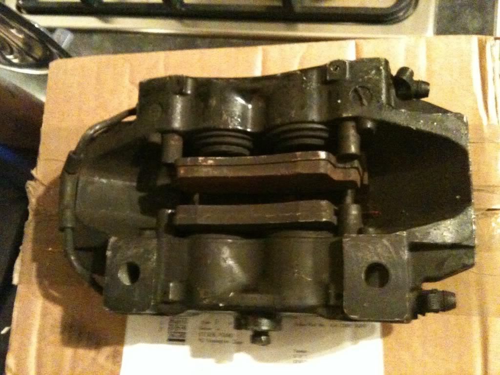

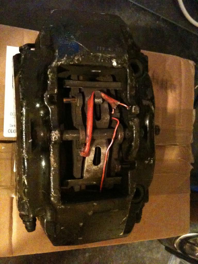

Chaps this is hotting up a little with a few guys looking for the fitting kits, just one important thing that I forgot to mention thats pretty important is that with multipot calipers invariably the pistons are staggered in terms of size.
Its important to remember that the small piston MUST "see" the disc first so imagine the disc rotating within the caliper the small piston must get first bite, so on a golf where the caliper "leads" instead of "lagging" the small piston will be at the top.
On a porsche the calipers "lag" on the front, this means that the calipers need reversing for a golf application.
Very briefly the left side connecting pipe goes to the right side where the bleed nipples reside as standard and vice versa, I do it as a matter of course on refurb calipers but anybody doing a DIY needs to have a little look at this diagram
Any snags simply PM me, the best method for removing the connecting pipes is not a 10mm spanner, much better is a large 8" pair of vice grips and sharp pressure until they give a crack and then use the spanner! Its actually 10 times more straightforward than Ive described!!!
I managed to do this today although cracking a couple of the bolts on the connecting pipes was a beeeatch even with mole grips and heat. Luckily I could get one off on each side before i chewed things up too much with the mole grips and could then bend the pipe away and feed a ring spanner along the line to get to the other one. Bending the pipe slightly was not ideal as it was a bit of a nuisance getting it bent back so that it lined up perfectly for re-attachment to the caliper and being careful not over-do it and kink it.
Oh, and I had a worrying moment when I hadn't lined it up perfectly...it's stating the obvious really but these alloy calipers are light but way softer than the pig iron ones - it is easy to strip a thread for the bleed nipples or lines if you are not carfull! I managed to rescue the situation thankfully.
PS - does anyone know where I can get caliper bridges from? I noticed a nick out of one of mine which may be OK but I'd hate to sprout a leak. The only place I see them is here http://www.design911.co.uk/fu/pt66_1409_-cma81-cmo82/Porsche/Boxster/Caliper-Lines/#7826  with Mfg Part# 99635296100 and 200 for the other side but I'll risk it if I can't see them cheaper.
