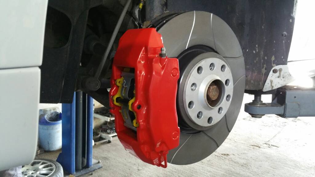

Finally got the kit installed
Everything is "almost" perfect, I got some squealing noise but I guess this is how the RS29 should be. What worries me most is that one heated on heavy breaking they become noisy. Not squealing it's a deeper noise like friction. I wonder if this is normal due the the slotted nature of Brembo max rotors or it's something wrong

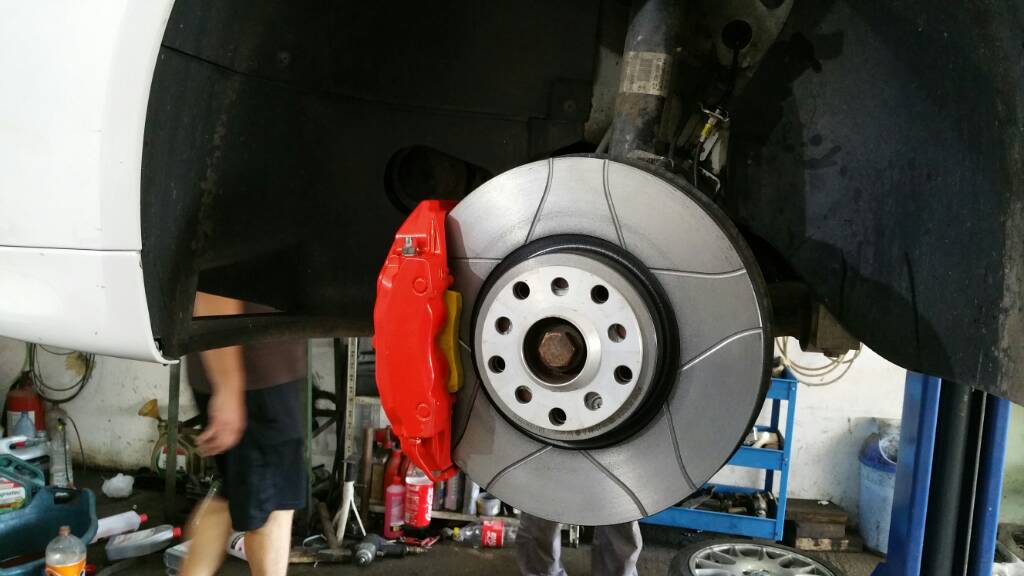

« Reply #908 on: July 04, 2015, 04:56:44 pm »
I'm worried that the mechanic did the install wrong or something else is wrong.
The pad holes for pins at the retaining system are not symmetrical on both sides. Can someone show me some pictures with the kit installed? How many pins do you have installed?
And the most worrying thing is a click click noise when full stopped and pressing the brake pedal. So standing still click click noises comes from the right caliper when the brake pedal travels down. It also perceptible in the pedal. What can be? I have no shims just the RS 29 Pagid pads on Brembo max discs

« Reply #909 on: July 04, 2015, 06:04:35 pm »
There is only one pad retaining pin per side...
Sent from my SM-N910F using Tapatalk
Hello All!  I just joined this forum over from the states the reply to this comment.  I've had the NQSBBK setup since around September of 2014, and starting around spring of this year I get the same exact noise described above.  I can't for the life of me figure it out.  I've bought new retaining "springs" and pins, lubed the pins, lubed where the pads slide, lubed the back of the pads, installed the vibration dampers.. Pretty much everything you can think of, and like above, as soon as the brakes get warm, even after normal driving, I get this clicking noise.  I rebuild the calipers with new seals and dust boots when installed and I am running SS lines, ECS Tuning Geomet rotors and Stoptech Street Pads.  Anyone that could provide any help would be greatly appreciated!!
Please let us know if the rebuild cured the clicking noise. A mechanic of mine said the dust seals are burned buy the electrostatic painting that was executed with the caliper fully equipped. I don't see how those can make the clicking noise or how a 200 Celsius temperature could burn them...
