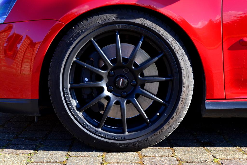

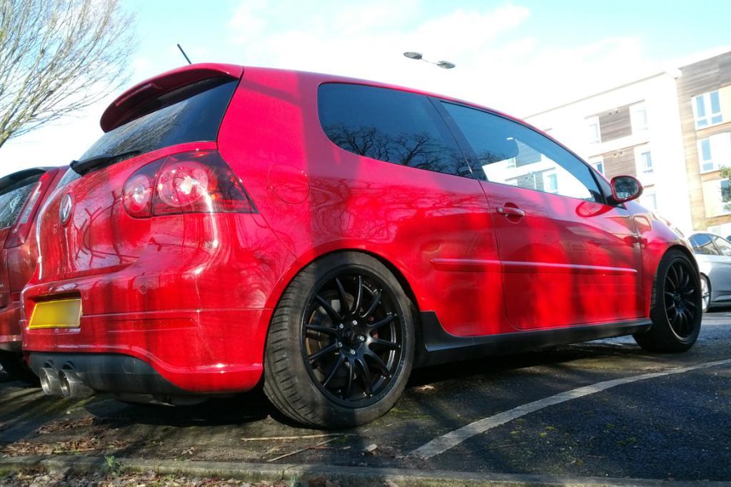

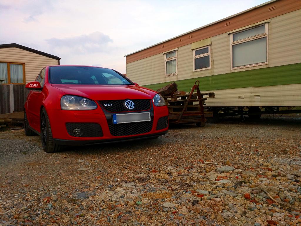

So in keeping with monthly updates, I've chucked together a few photos and some text. First little change up was returning to a stock grill:
Also added some R32 rear lights:
And now running some Team Dynamic Pro Race 1.2's in an 18 inch matt black flavour:
Also signed up to a group buy for a BCS turbo back exhaust sytem which will be with me end of April all being well. Oh, and decided to get some new brakes:

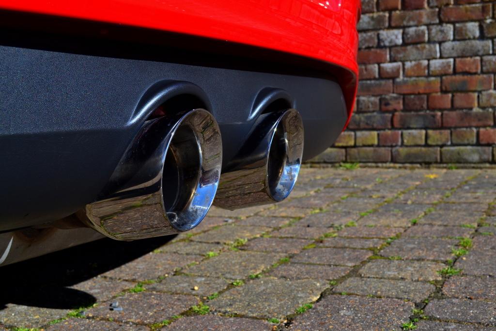

Car insurance is due next month and the exhaust isn't cheap (despit being a good deal!) so slower progress over the coming months.

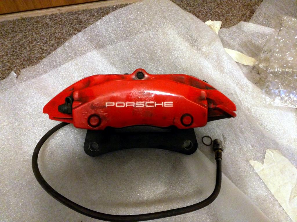

Decided the NQSBBK isn't for me, so got the harder brother! 330mm discs and slightly larger Brembo calipers, nice! NQSBBK now going back for sale if anyone is or knows someone who's interested. Also got some Forge coolant pipes, need the lower ones and some fittings then I'm good to attempt that. Might make a start on my ED30 splitter this week too if I get time.

Thanks man. The calipers are indeed big red Porsche calipers. :happy2:

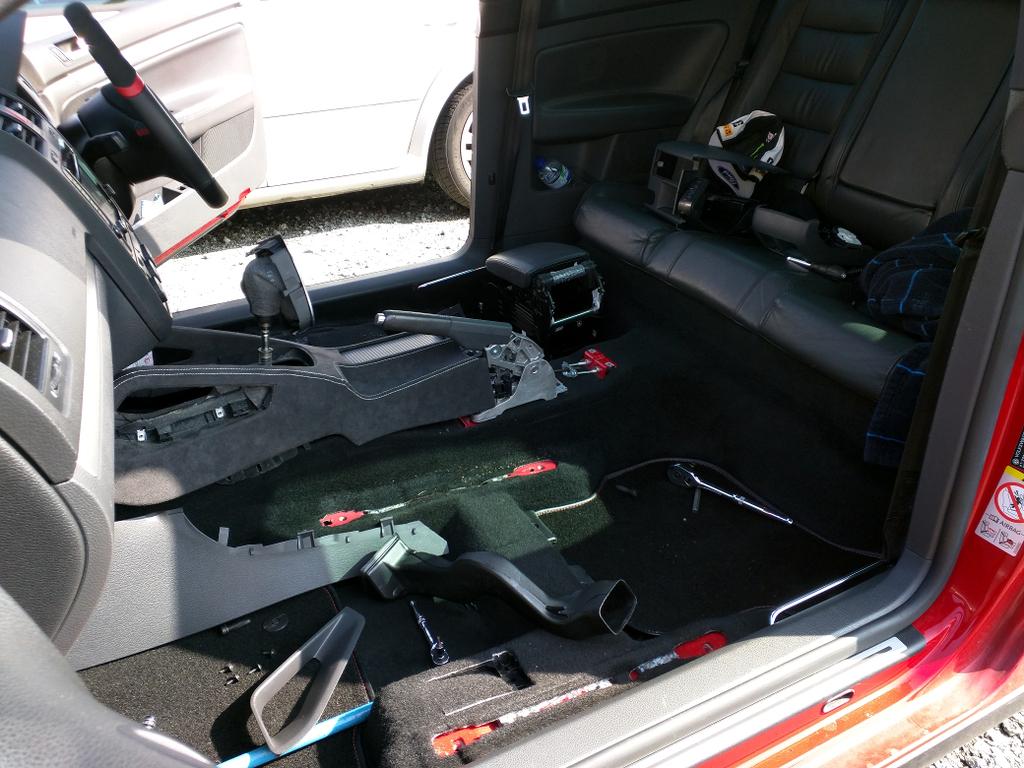

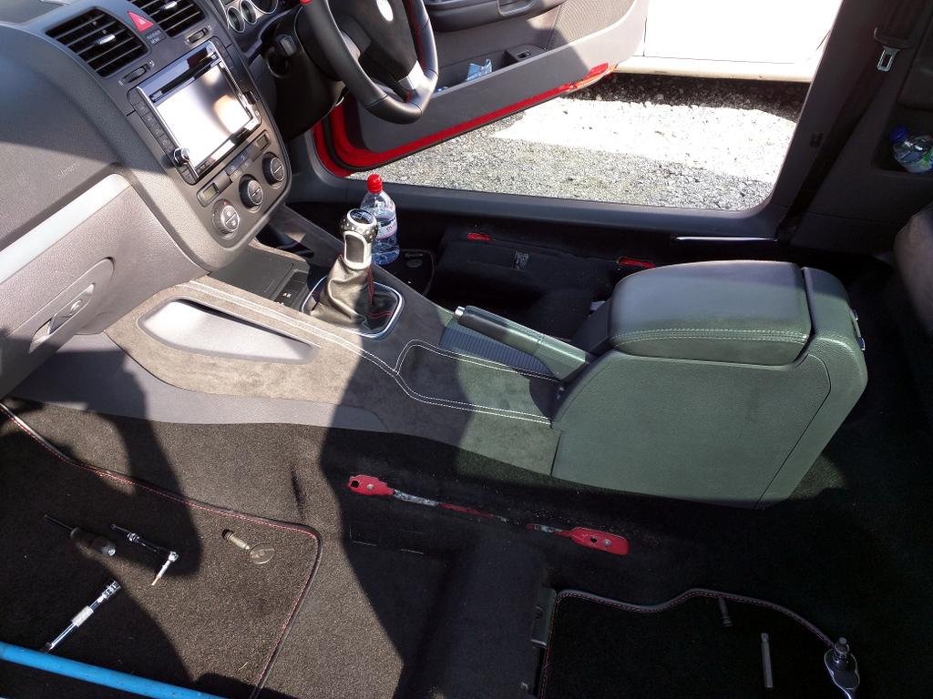

So, it’s only taken since January of this year to sort it out, but I finally have my arm rest fully installed! The hold-up came from no access to the sides of the arm rest with the seats in, plus I needed to re-remove the centre console to fit the air duct pipework for the rear vents. So after (scarily) just under an hour later it looked like this:
One of the main access problems was this one screw:
But my perfectionist side is now happy as its all bolted back in and there are no spare screws! Every single one is accounted for and where it should be:
Really, I’d of liked to hoover the hell out of my interior while the car is in the state above, but due to personal circumstances massively changing in the last week, the location for this work is far from an ideal location. Still, it’s another job done and dusted, last job of the interior is to fit my front JBL speakers and possibly wire them up to the rear amplifier, although this is unlikely unless I can cleverly do it without removing the whole interior again. Seriously, it’s no joke that to wire up an amplifier in the rear you pretty much remove all the interior, just check my previous posts!

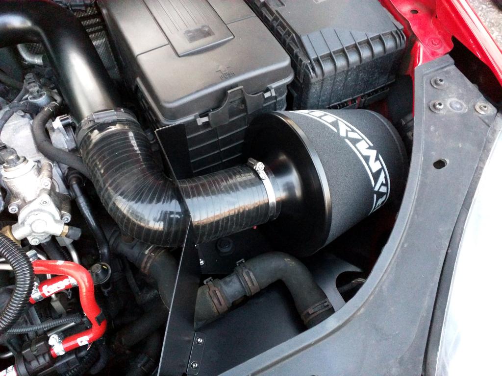

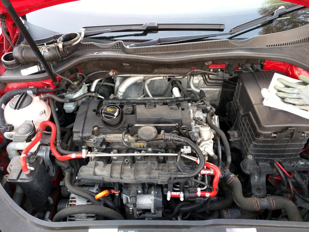

So, time for an actual update in keeping with the monthly progress. This month it's all about being a hypocrite! I've always voiced an opinion that a full CAI on a K03 turbo engine as overkill and kills torque lower down the rev range... Well I decided that I needed one anyway regardless as retail therapy is always a winner, right?
So, just to guage how big the cone filter is on the RamAir intake, I put it next to a 1 litre water bottle. Oh my, what a big cone filter you have grandma:

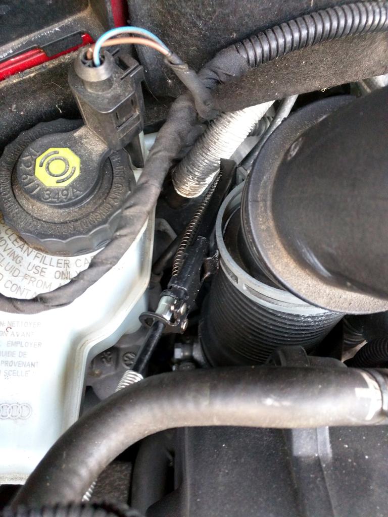

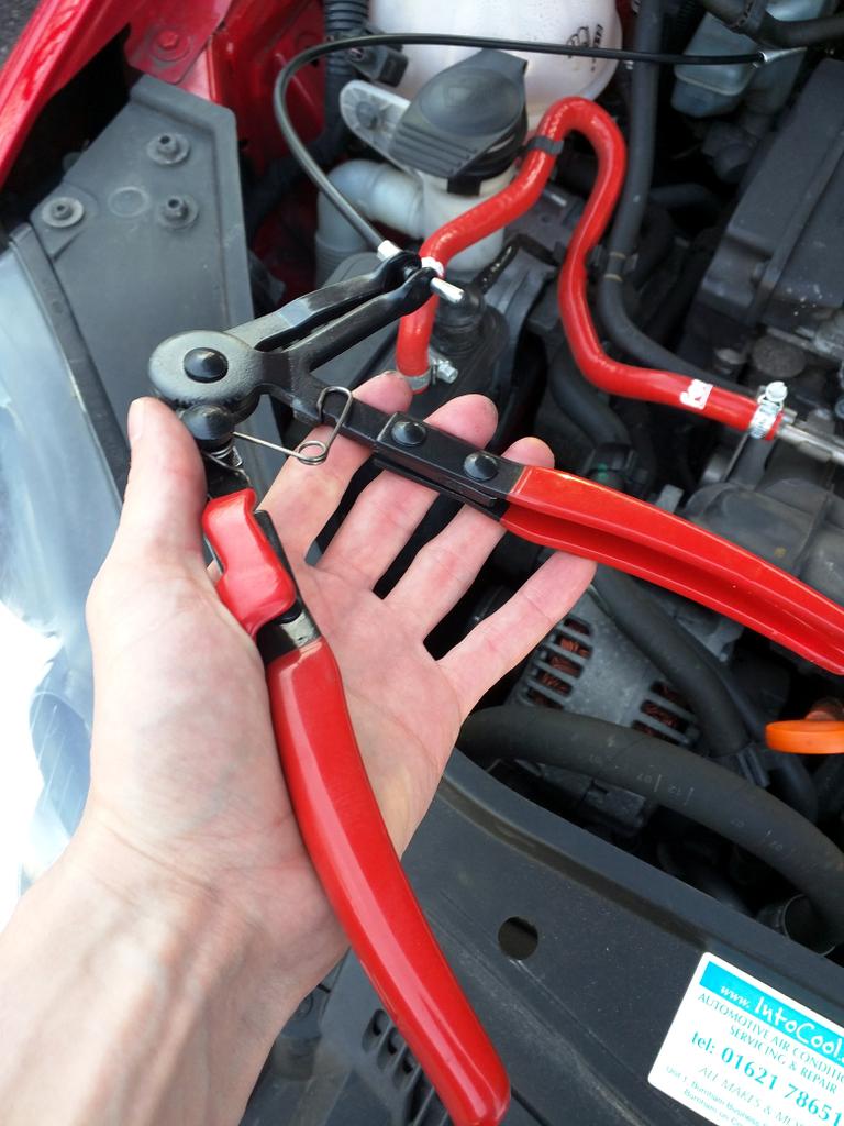

So got outside and began removing the engine cover and old set-up. Here's a tip people, get yourself a set of hose clip pliers as they will save you both time and skin on your hands. Seriously, this one tool was worth the £30 I paid for a whole set of various pliers:
Seriously, took longer to get the rubber air feed from the air box to the turbo off than the hose clip. Those pliers made it all of a 10 second job and I'm not even joking! So, all stripped off in about 15 minutes:
I needed to "borrow" some of the engine rubber mounts to fit the RamAir heat shielding:
Quite an easy kit to fit, but a single piece of pipe work like the Revo kit would of been even simpler but at £155, I'm not complaining in the slightest! All finished about 20 minutes before sundown:
I'll write up in another post what I think of it, I'd also like to get back onto the AmD Tuning rolling road to see just what a difference it makes over my original set-up. The reason I need to use AmD is although their figures a generous to say the least, because my original power run was from there it's the only way to make a fair comparison between a panel filter and full CAI. I won't be too interested in total power gain, more about how it's affected the power curve and where the peak power/torque now are.
Future plans for the next month? Well, as some of you may be aware I'm working on a mk4 Golf V5 so once I've got that finished up and running, I'll make some serious progress with Evie. Yes, I've gone back to naming my car as now she's the only girl in my life... SO if all goes well with the mk4 I'll be confident enough to fit my 330mm Porsche front brakes, S3 intercooler and if I can source one, a HPFP all ahead of getting a full turbo back exhaust fitted. Basically, if you haven't guessed, stage 2+ is officially happening! Target is 275bhp but I'd love to start aiming for 300bhp+ (a hint to future plans as well all know the K03 limit lies around 285bhp). For now, peace...

Initial impressions of the intake are like this... I've lost a noticeable amount of torque below 3000rpm which is expected but beyond this its pulling smoother and slightly quicker. There is a constant noise as the intake draws air in under any acceleration over 2000rpm but the noise it makes when you let off to change gear is addictive.
Got to tweak the positioning of the kit as the filter is making contact with the cooling pipes and I need to sort this before fitting Forge silicon pipes. Generally I'm happy but having to adjust my driving style to compensate for the difference in power delivery.
