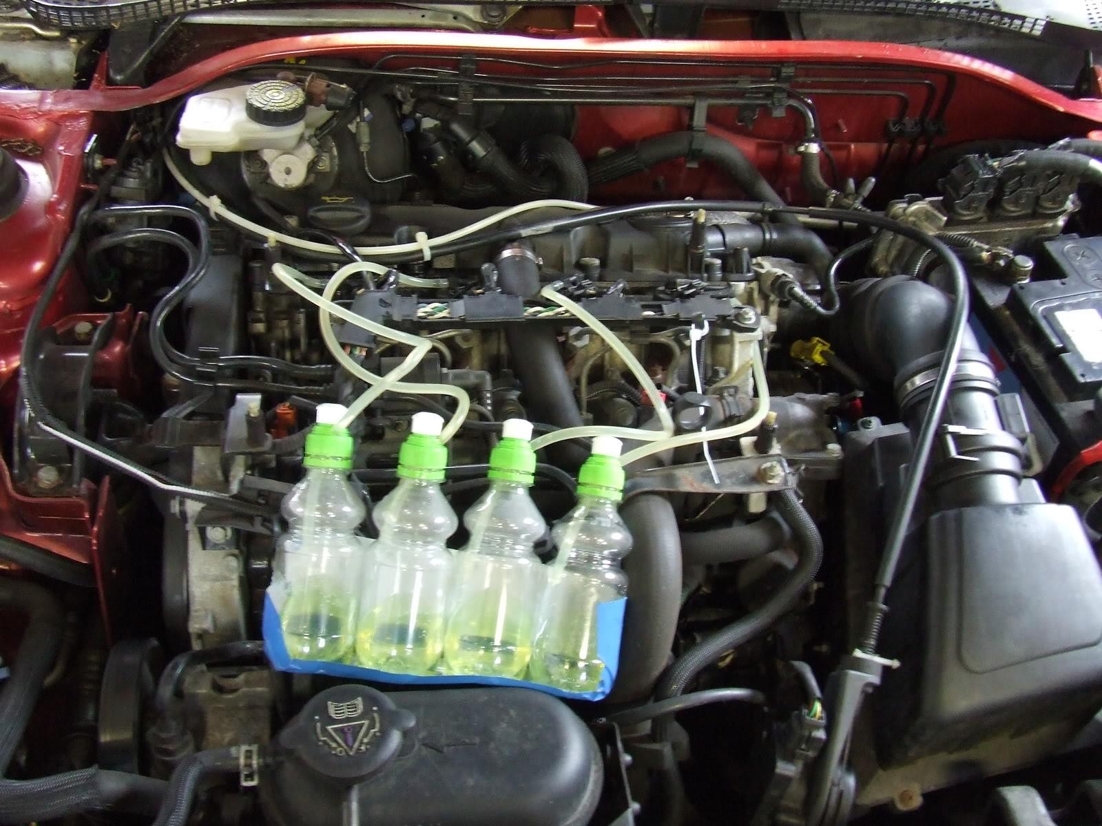

Were any of the old plugs sooted up more than the others?
Worth a read too:
http://chrisebnerttec48261.blogspot.co.uk/2010/08/injector-patternsdelivery-volume.html

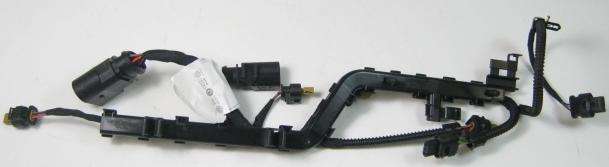

You need to do the injector test I suggested earlier. I think its pointing to wiring +/- ECU.
afaik injector wiring is straight swap plug and play.
About £60 from the dealers according to google.
