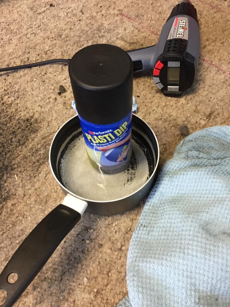

My process was to get the wheels super clean (Brake cleaner spray is good), dried and finished... I used a fine first coat, and then just kept loading it up once each layer was dry it's really easy to use... I used about a can a wheel.
My advice would be to get the cans warm in this weather... I placed mine in a tub of warmish (but not boiling) water and the spray mist is far, far better... when they're cold they spit.

Cheers @Scottymon that is exactly my plan - have 4 tins (1 per wheel) and a heater in the garage to keep things civilized.
Going to attempt to do 2 wheels at a time so jacking the car up is easier!
Cans will be sat in a lovely hot bath of water to prevent them spitting - actually really looking forward to getting them done!

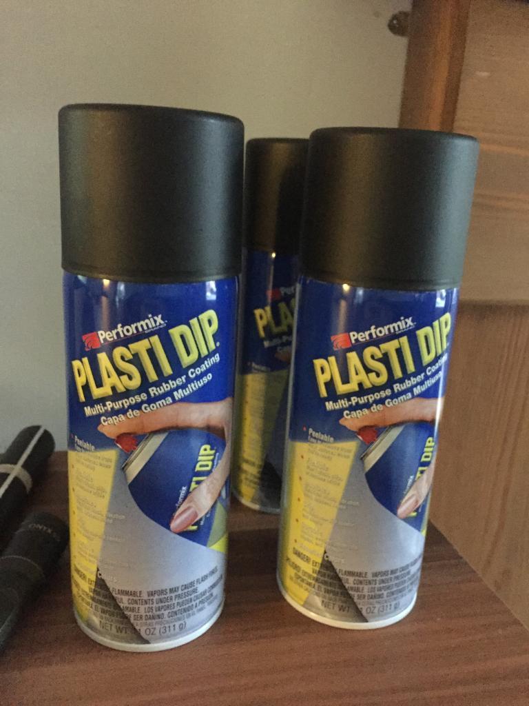

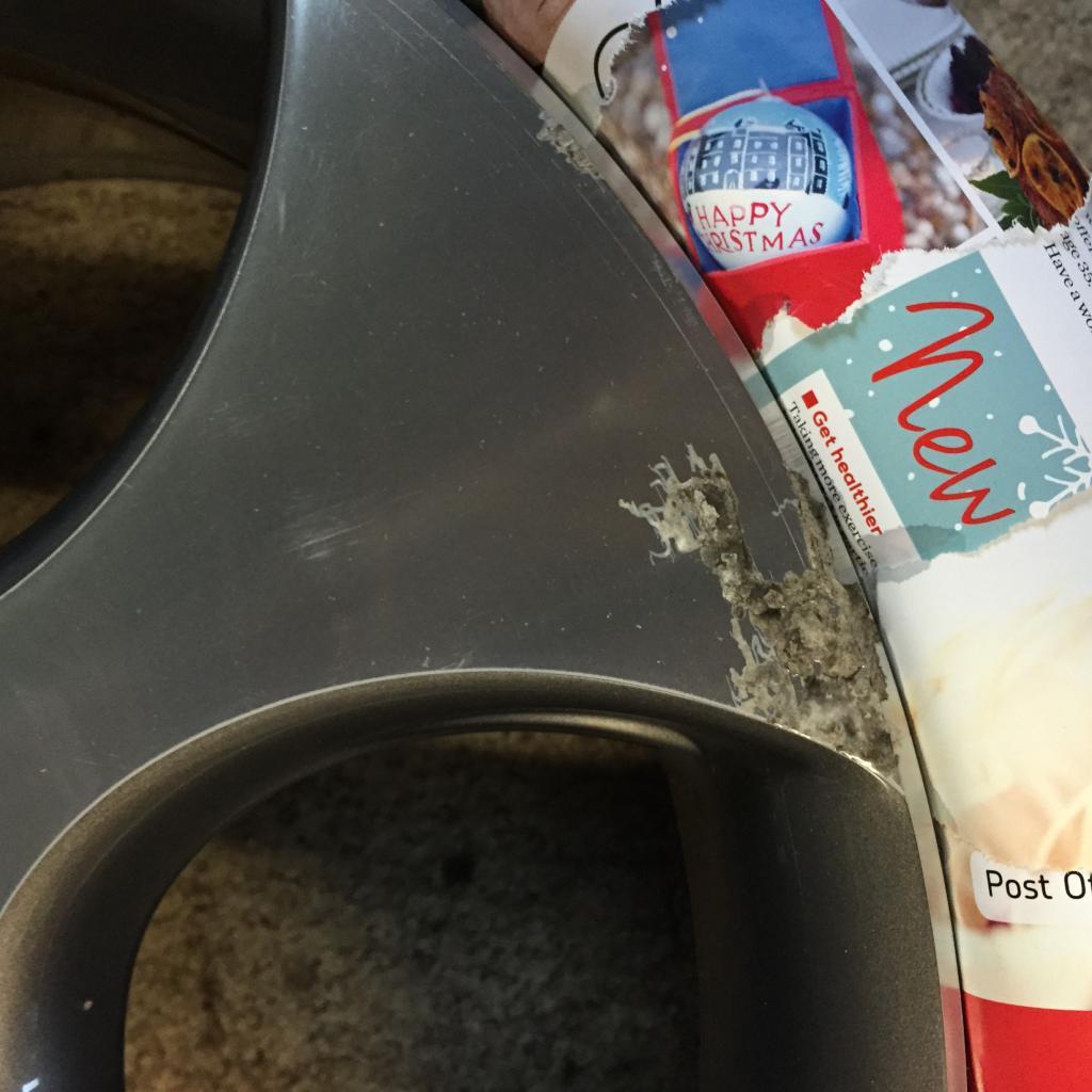

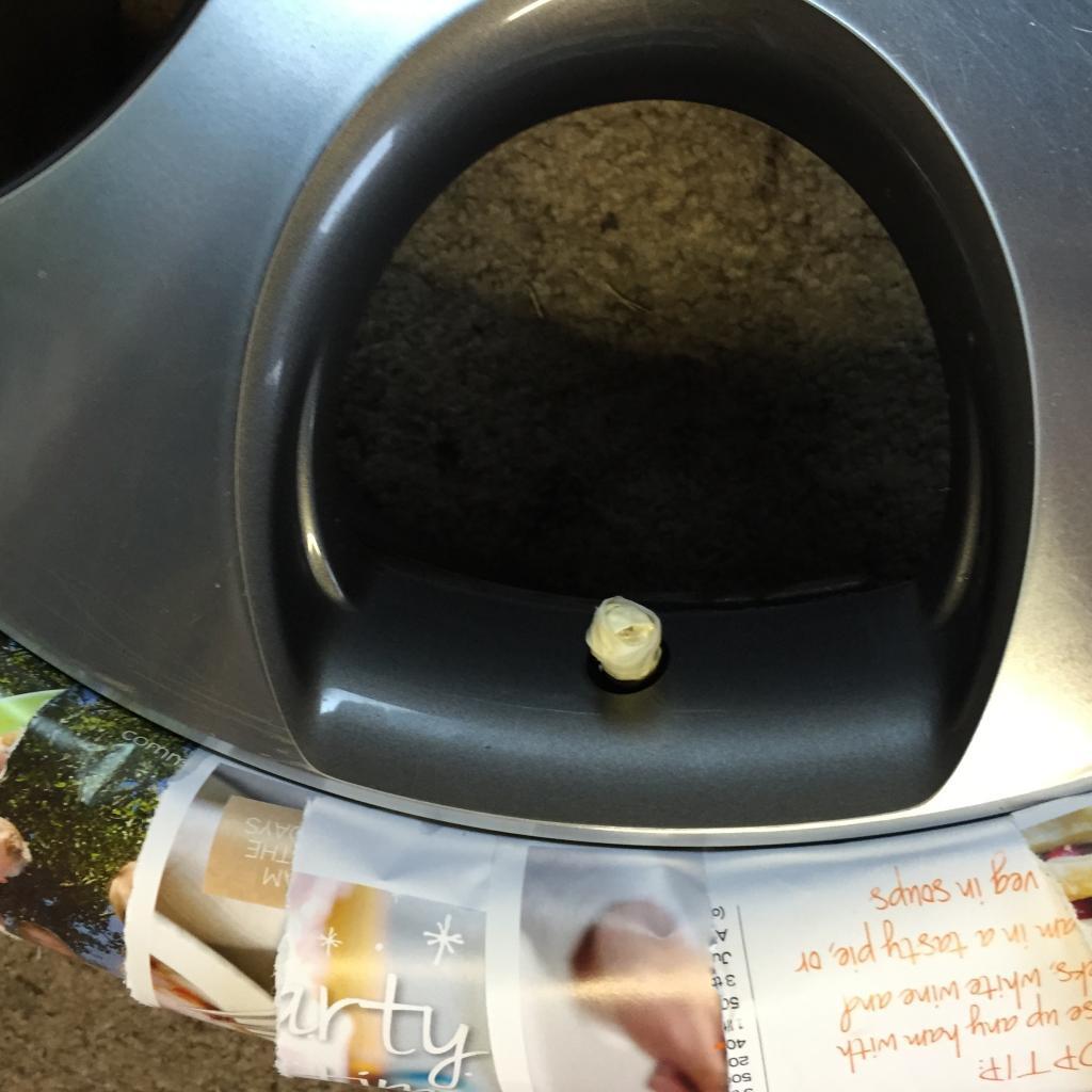

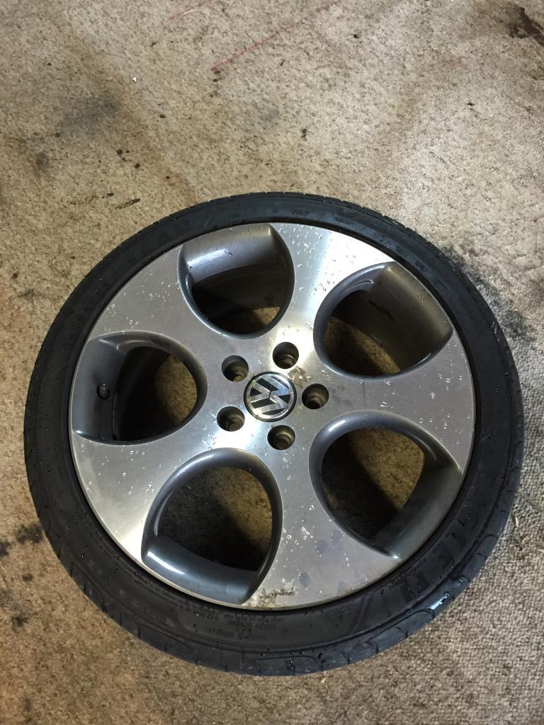

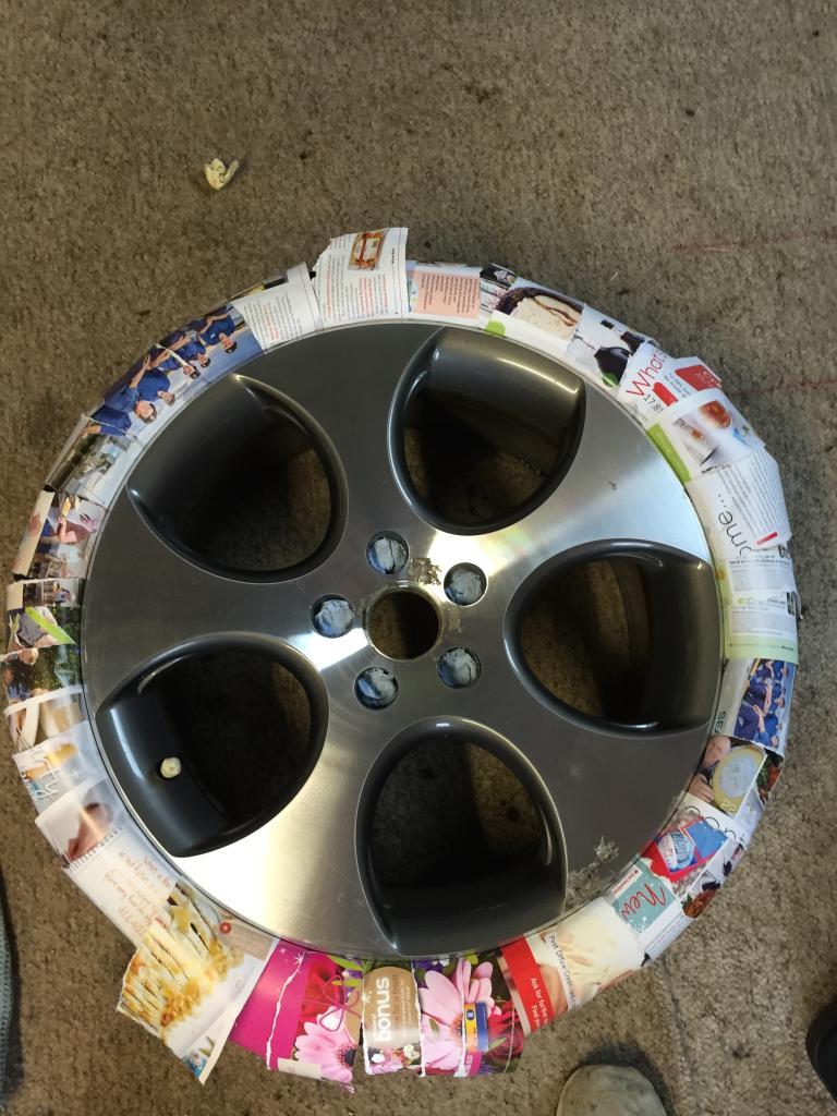

PlastiDip Cans from eBay

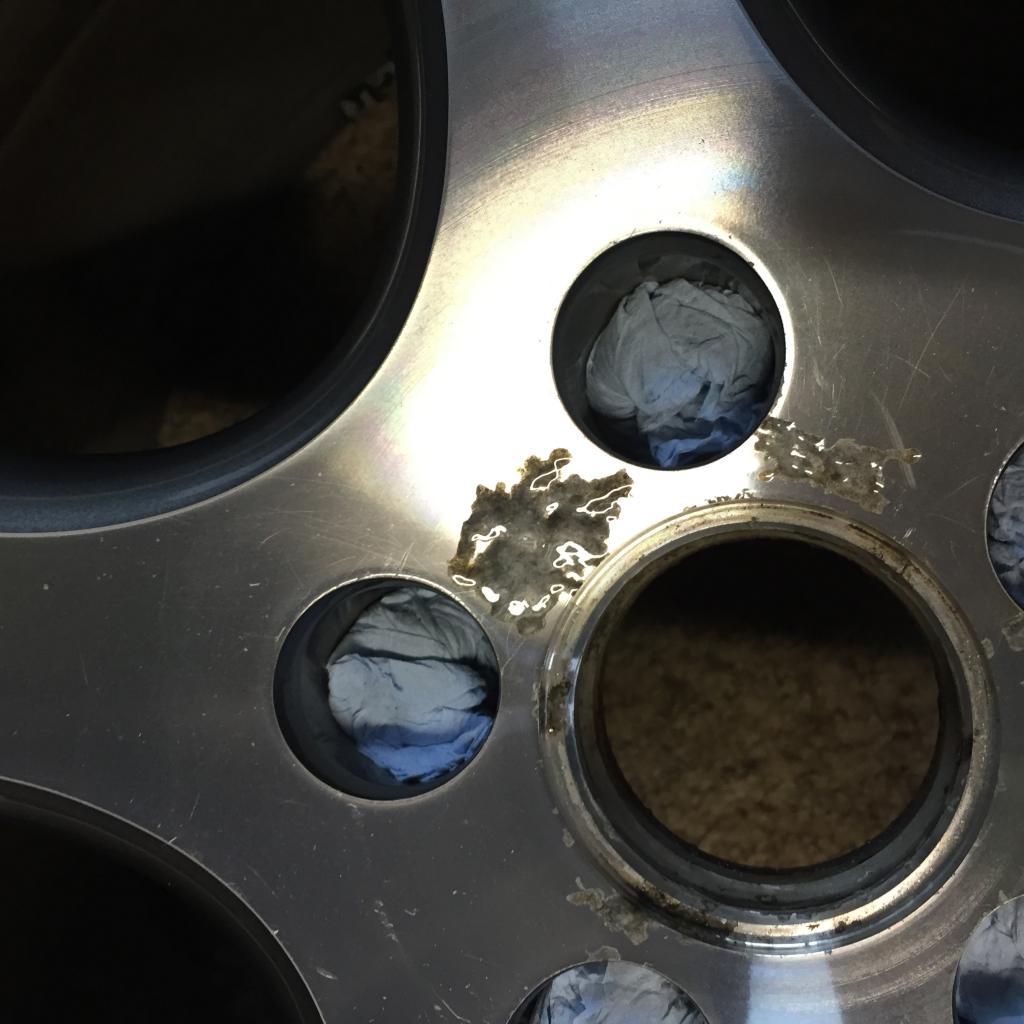

Front wheel removed and washed - its not in a brilliant state and needs a refurb but I dont have the £300+ required at the moment!

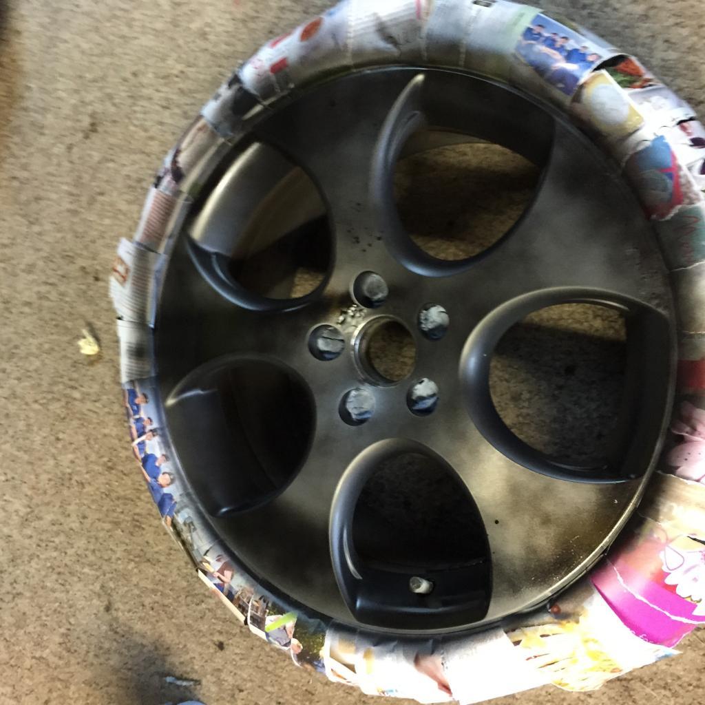

Used a bit of junk mail to stop overspray on the tyres
I used a heatgun and a pan of boiling water on the paint as the ambient temp is pretty low here in Lincoln
Nice bit of white worm
Masked up the bolt holes and the valve cap

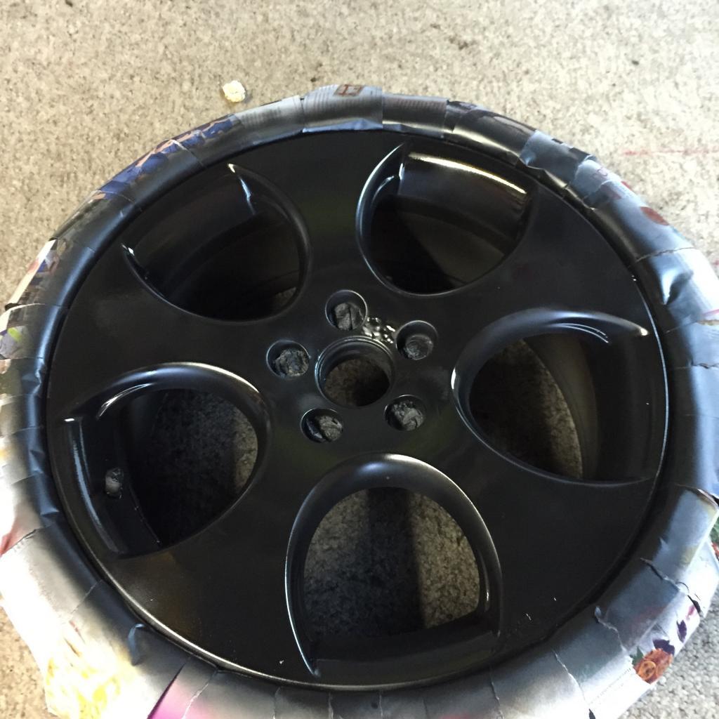

First light coat
Couple more
And fitted
Two down - two to go!!

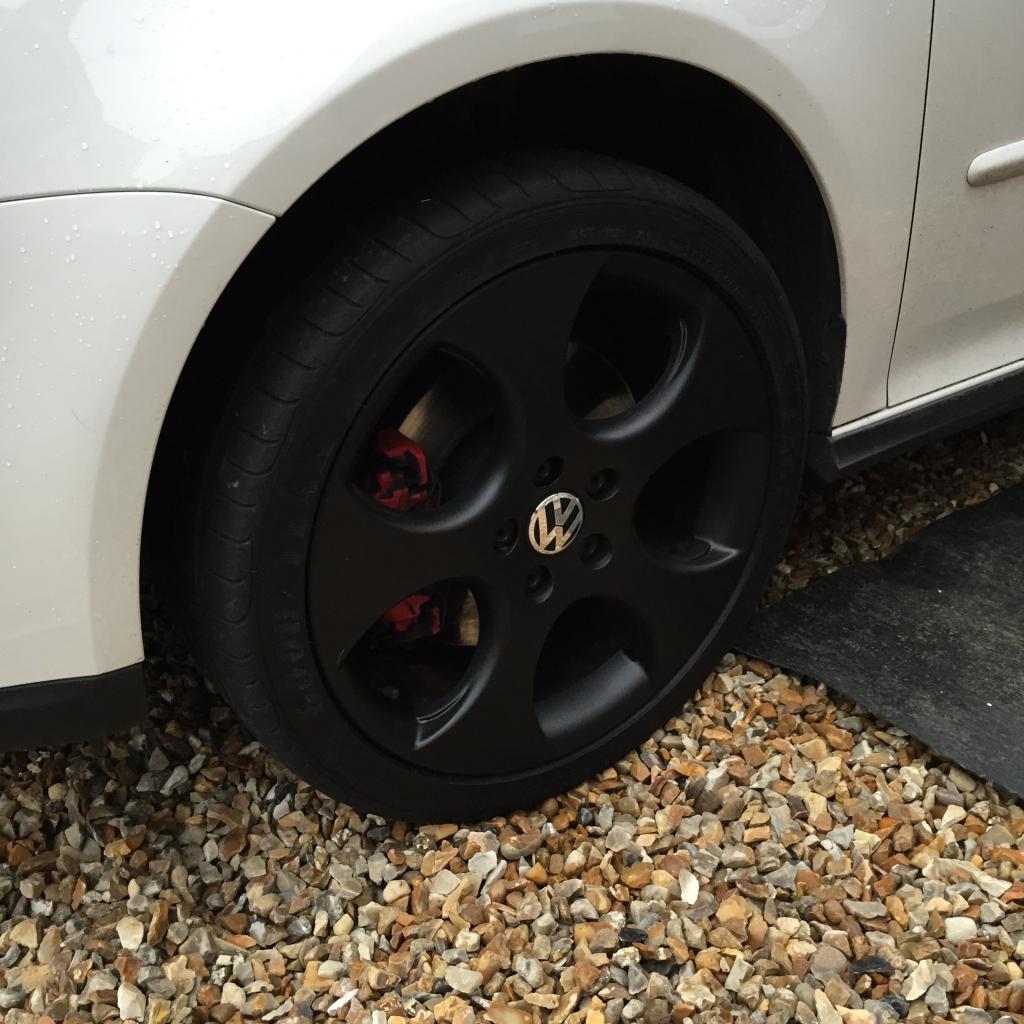

Afternoon fellas - between trips to the post office and dodging the rain I have managed to get the wheels done on the car! I am very happy with the finish I achieved especially as I am a rank amateur when it comes to painting/spraying anything!
Even managed to give the car a quick rinse inbetween showers
Will keep an eye on how the finish lasts but have a little left in one of the cans incase touch ups are required! Overall a result for me!
Some pics of the completed work
