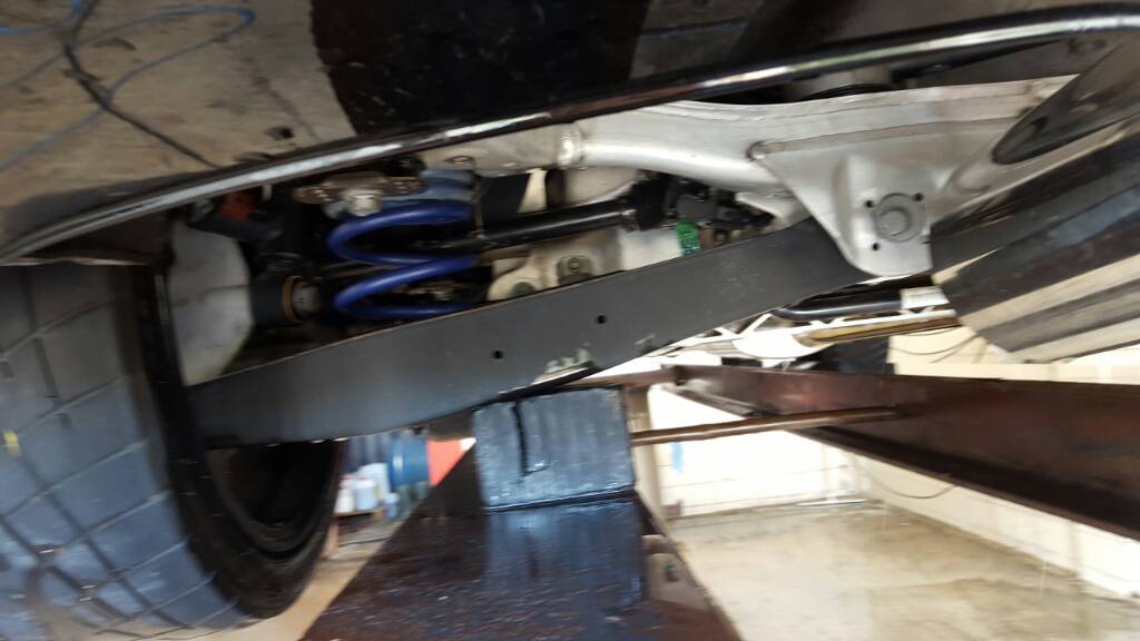

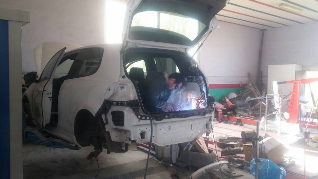

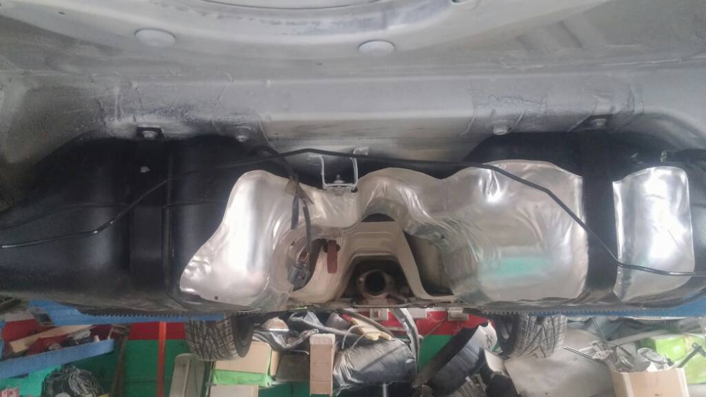

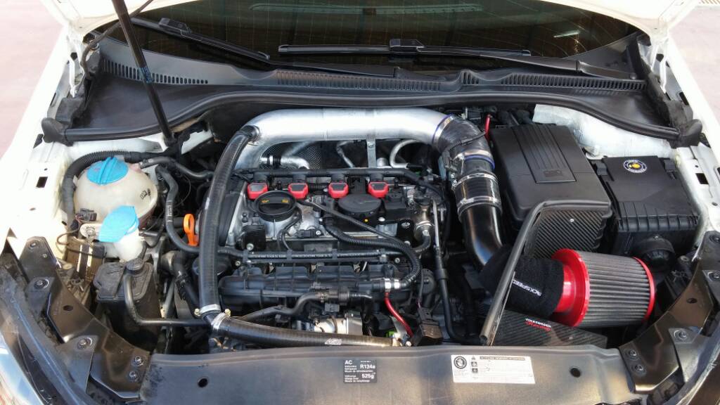

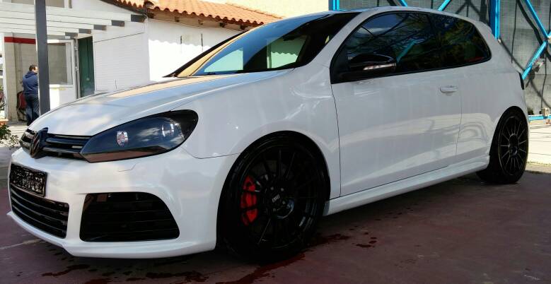

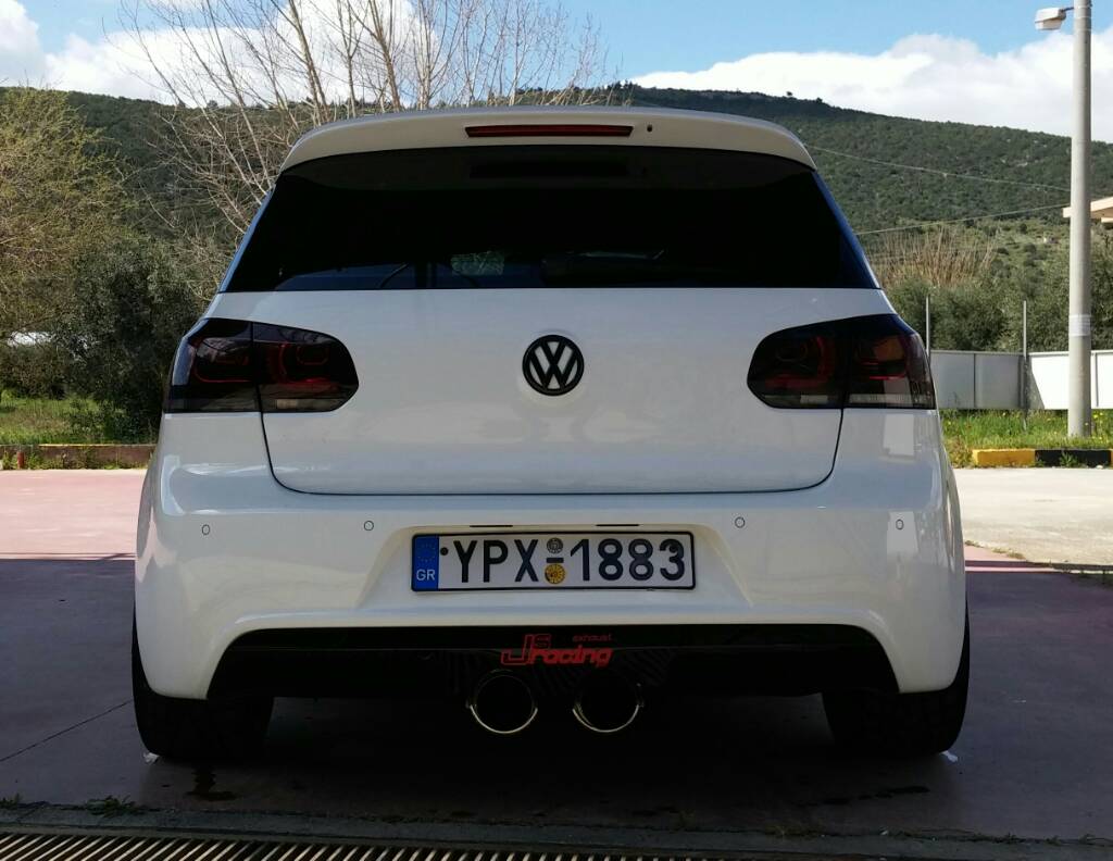

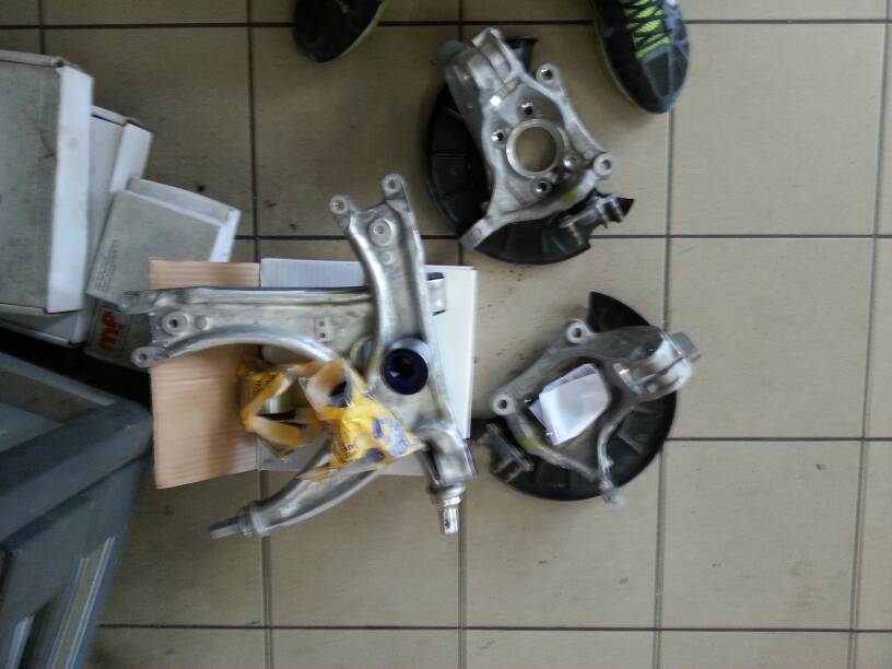

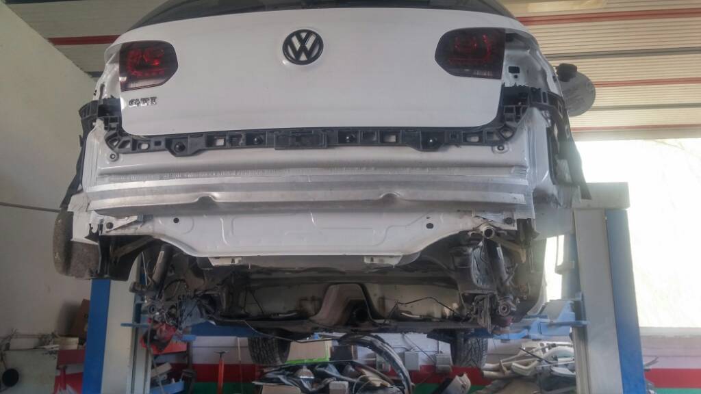

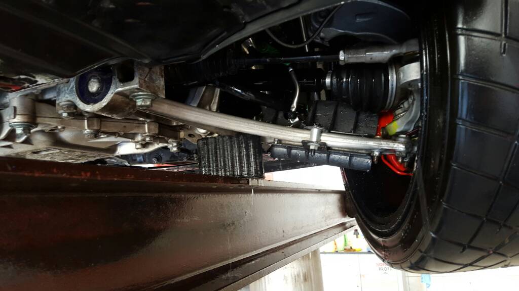

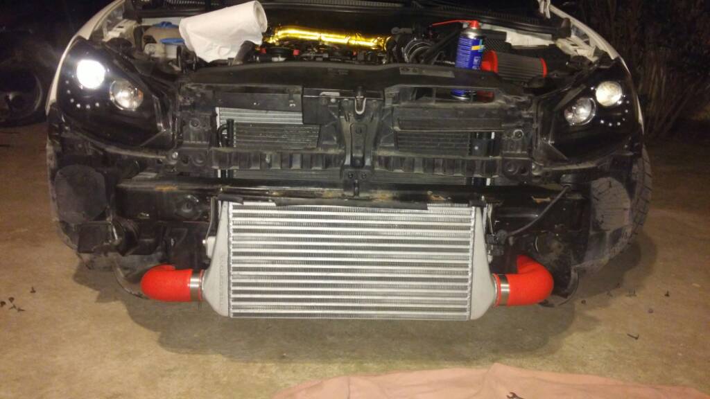

Another mk6 gti dsg gets awd dsg swap and R original look.after months of searching for parts i finally finished my project.all parts working perfect no vag-com error second fuel sender is wired to dash haldex controller also.i tried to keep weight as low as possible compared to an original R i have lighter:
*front control arms and knuckle(passat cc)
*tt rs front brakes(lighter than R)
*rear awd subframe alloy from r32
*rear crush bar from a3 which is alloy
*enkei rc-t4 wheels lighter from stock
Other mods to the car:
*Original R optic
*h&r golf mk6 R springs(gti springs are soft for the awd weight)
*tt 8j front top mounts
*k04 turbo with forge wg
*lnf injectors with custom tune

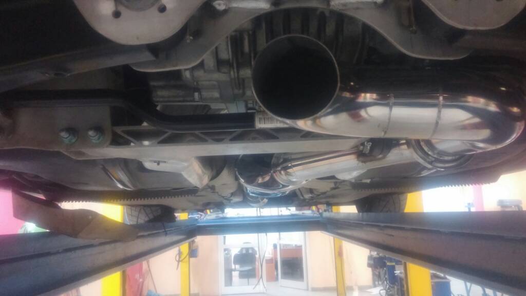

*76mm custom exhaust with 100cell hjs cat
*treadstone intercooler custom pipes
*aem methanol kit
*custom intake
*gfb blowoff valve
*pbc electronic boost controller
*defi 52mm boost gauge
*original rear pdc
And other things that maybe i forget.
All things works perfect.i connect second fuel sender to my dash and an expert make the decode for my abs unit to work with Awd.Not even one error to vag-com scan,really huppy from the results!!

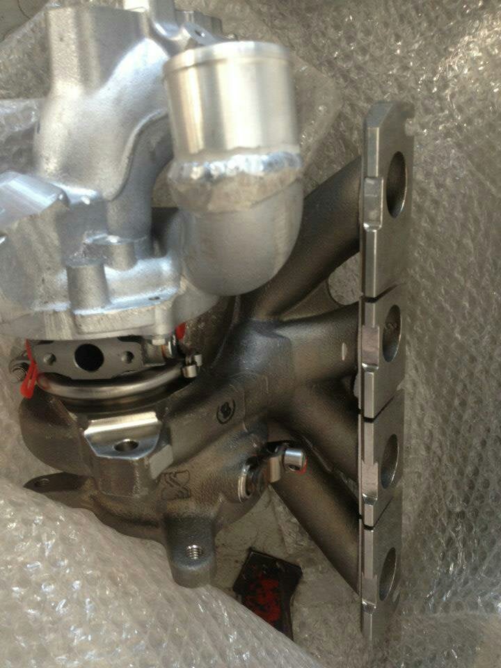

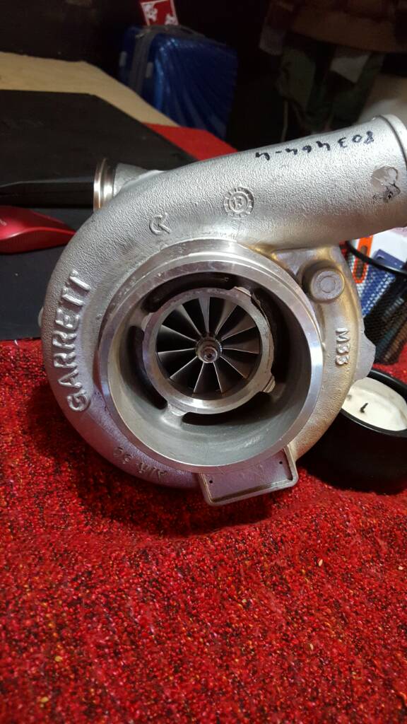

Yes of caurse i will leave a feedback for all,the built and the results and dyno!i bought a gtx3071 with new garrett vband housing 0.61AR for lower spooling.I will install it with the best tubular manifold in the market in my opinion which is made in Greece.

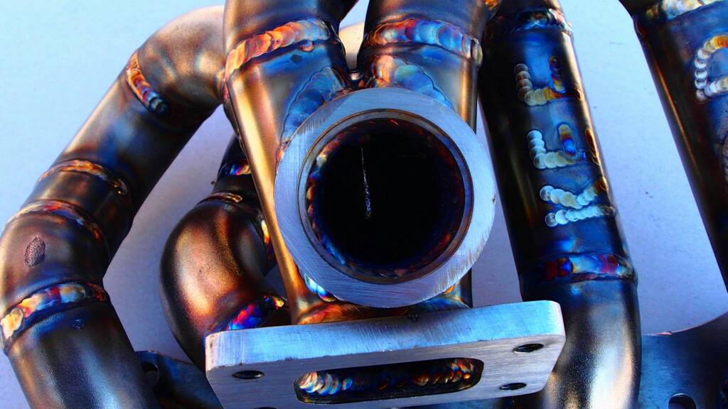

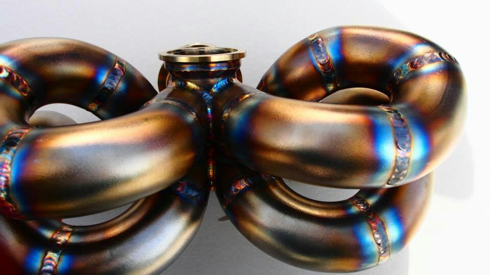

« Reply #8 on: September 27, 2015, 11:06:14 am »
Check out my turbo and turbo mani.
Στάλθηκε από το SM-G920F μου χρησιμοποιώντας Tapatalk
Re: golf mk6 gti to R swap!!
« Reply #9 on: September 27, 2015, 11:44:27 am »
That manifold is a work of art
Offline menios80
  • Posts: 26
« Reply #10 on: September 27, 2015, 11:56:06 am »
If and other member are interesting i can arrange a group buy.I know the fabricator and you have many option in build.With external or w/o ,with t3,t25,vband inlet. :)
